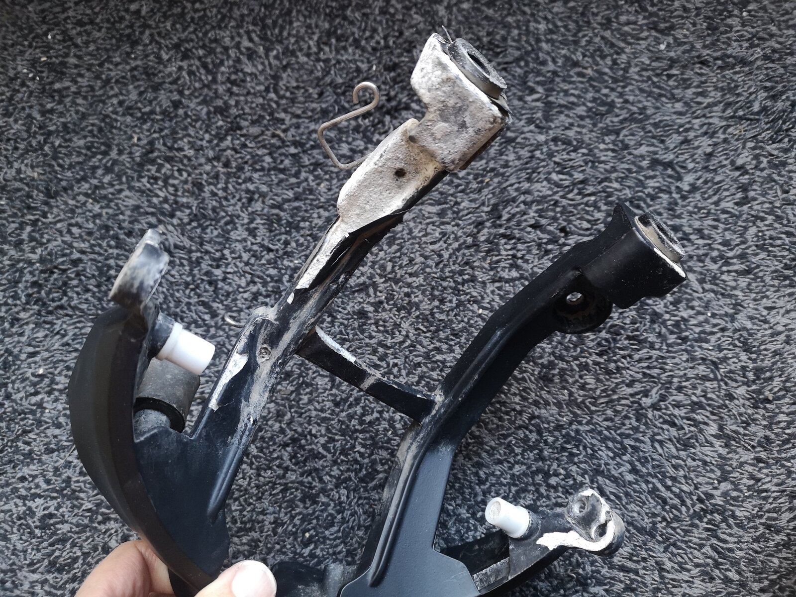

  1. Headlight/Indicator mount frame
    Just over 2 years old....not impressed. May be worth a check on your own Scramblers.
    I wonder what chance of replacement part from Ducati as matter of goodwill?
    Plan to remove loose paint and corrosion and try re-painting. Anyone else done similar? Scrambler Corrosion.jpg

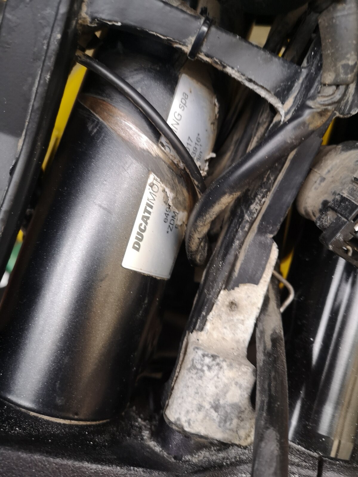

    Cable around the headstock not so clever either:

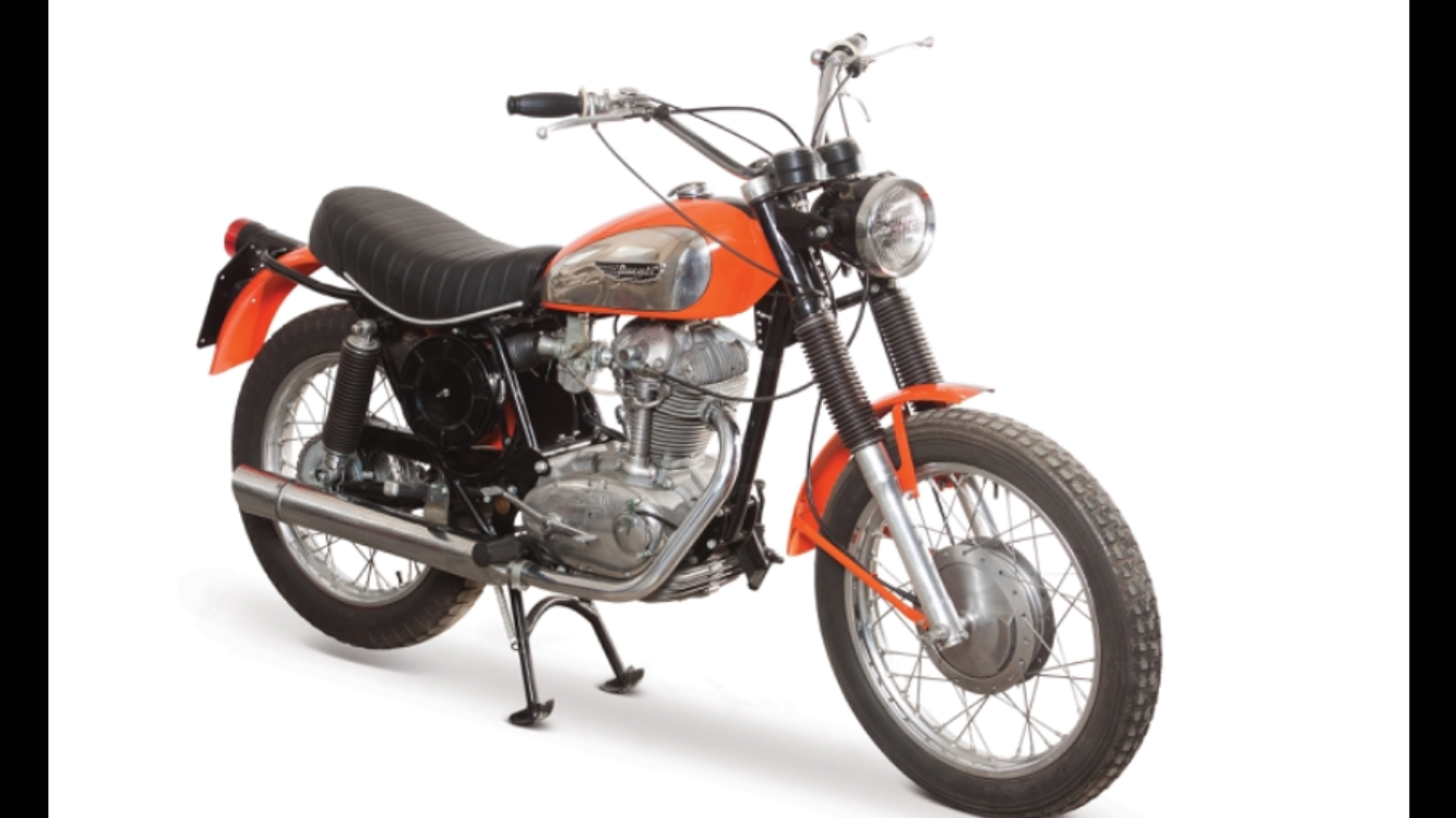

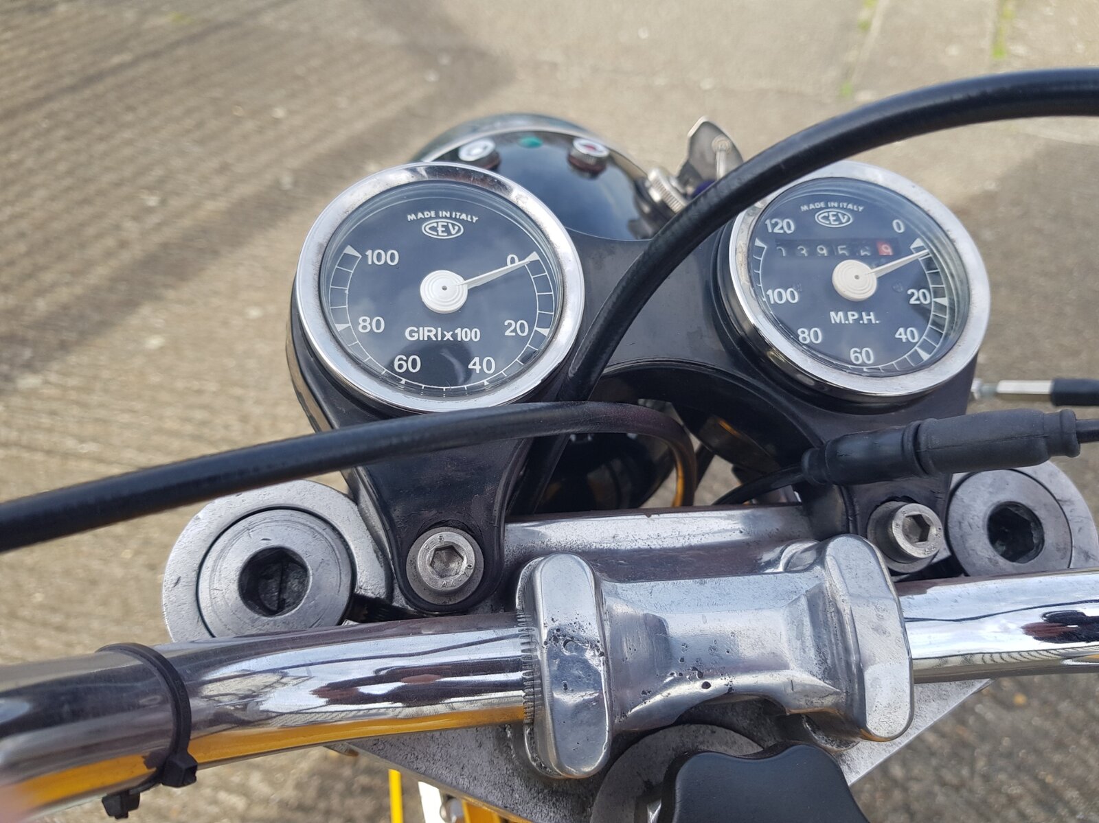

  8. E13C7614-D54F-4372-9640-C10F04514EBC.png The routing was done that way on purpose to mimic the 1960’s Scrambler guys, I re-routed mine when I fitted flat bars, not difficult, just rotate the banjo on the brake pipe, no need to alter the brake pipe length.

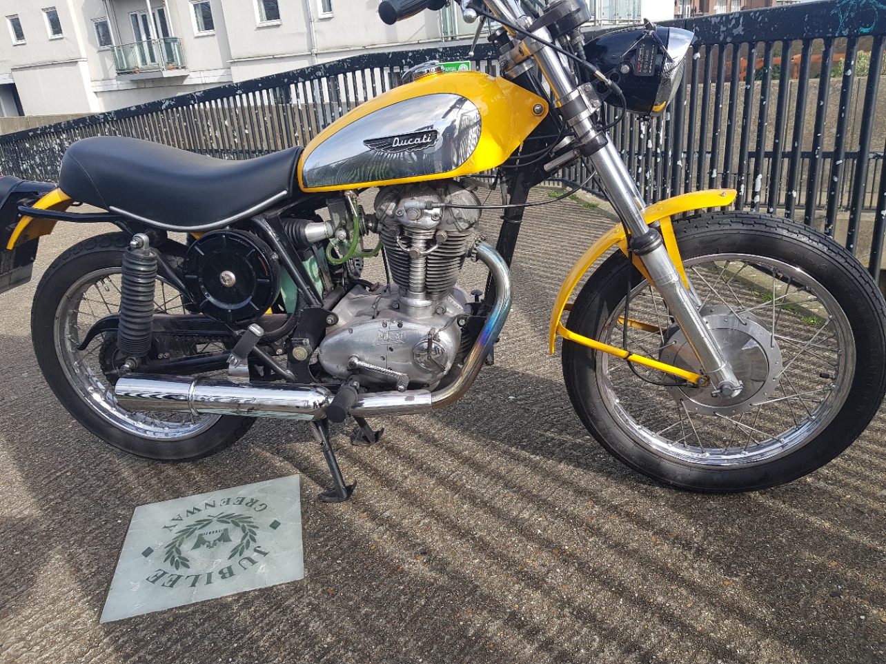

  12. That looks like a beauty Peter!
    • Love You Love You x 2
  14. I'm aware of that but I still don't like the look.
    Yes, that looks much better.

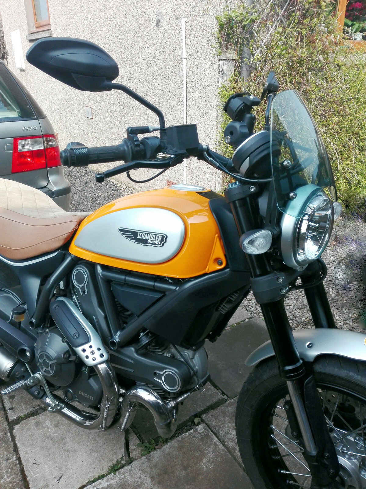

  16. I took a leaf out of your book @Mark9 and rotated the brake line downwards and I'm very happy with the result. The brake line clears the screen with no problem. Since I have heated grips I'm unable to rotate the throttle assembly but the cable runs behind the m/cylinder reservoir and lines in nicely with the brake hose just beyond it. Thanks for the tip. IMG_20200410_144119.jpg
  17. Better for brake bleeding too without that high loop!
