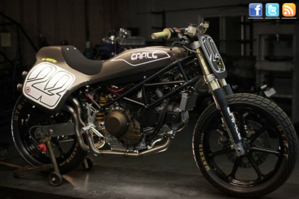

    Hi Red..
    Thanks for that..
    Mine is stripped back to metal .. It's a 796 engine 2010 model..
    I would like a bright silver as per pic and the dark bronze on the rocker covers etc.. As per pic..
    Many thanks
  8. RS paints do heat resistant Aluminium paint which is matt :- RS Bike Paint Products - Motorcycle paint, touch-up, aerosol, spray gun. Kawasaki Honda Yamaha
    They don't list the bronze but you may get a match from a RAL chart. They do metallics as well. A Google search will bring up plenty of RAL colour chart images. RAL colours can also be powdercoated.
    RAL Color Chart | www.RALcolor.com
    If you go to a paint supplier you can also look through their RAL charts and make a note of the colour and if necessary go elsewhere and buy it cheaper. Ebay is a good place to buy cheap RAL colours, I have found one supplier who will do a litre of paint with hardener for £30.
