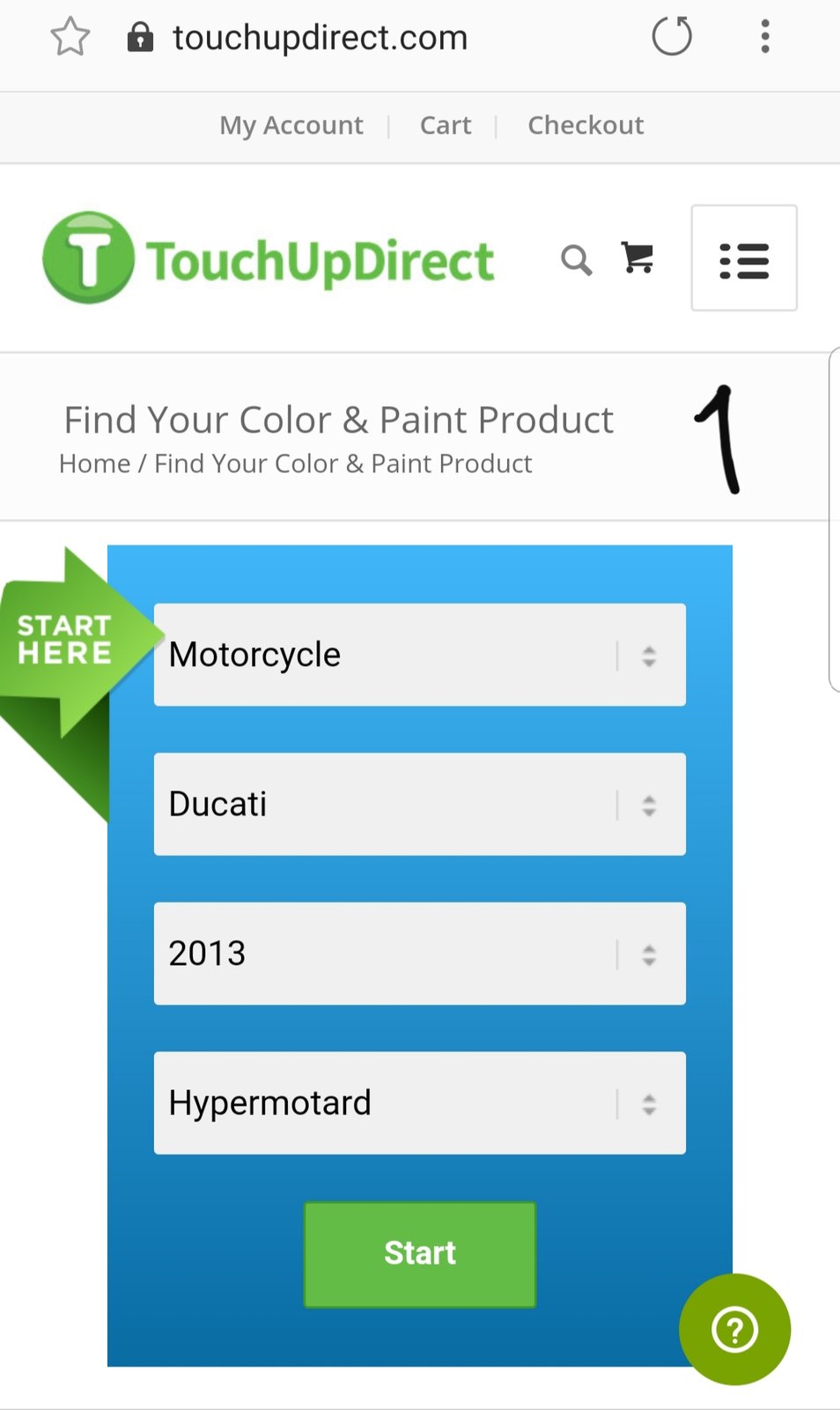

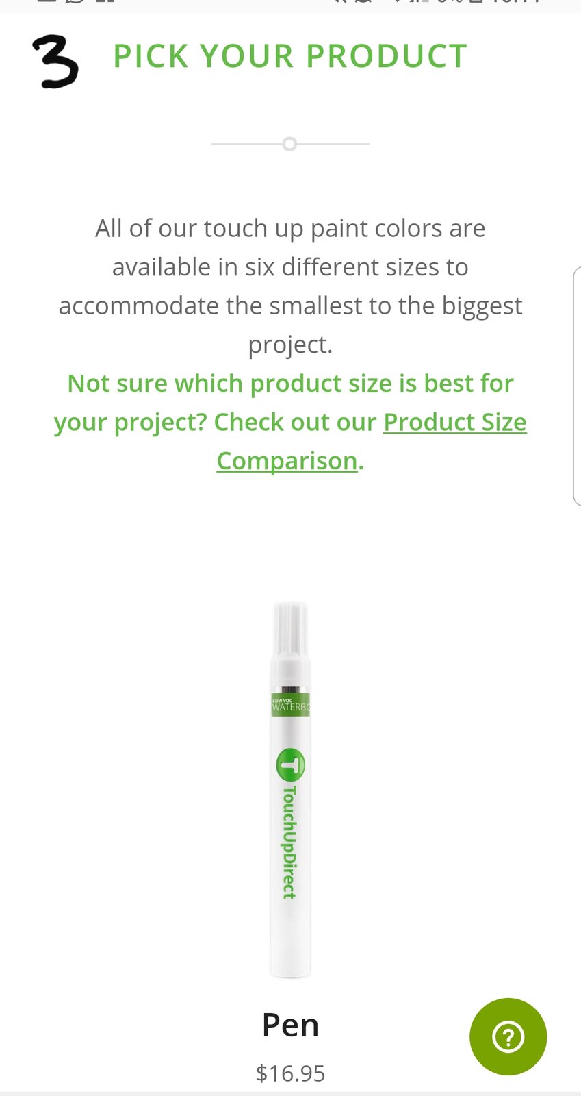

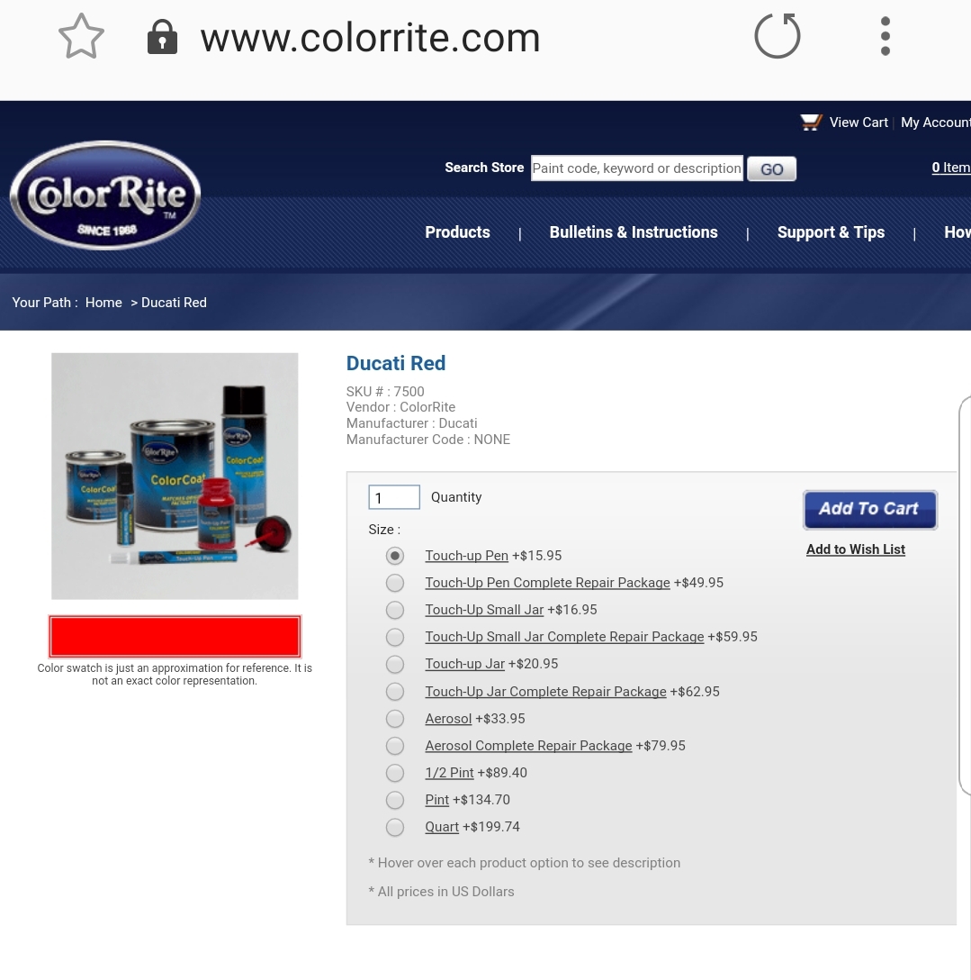

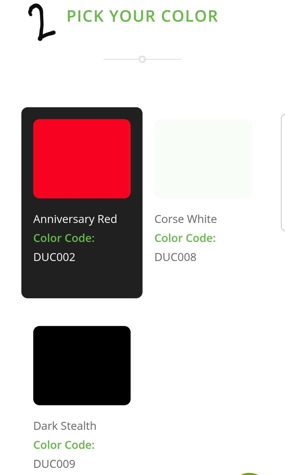

    I was thinking of trying a paint pen from ColoRite or TouchUpDirect (see schreenshots below). They seem to have paints dedicated to each model, not sure how accurate the colour will be.
    Anyone used these or any other brands? Or has anyone got an alternative suggestion? (besides the obvious "take it to paint shop").
    ColoRite option below:
    TouchUpDirect below:

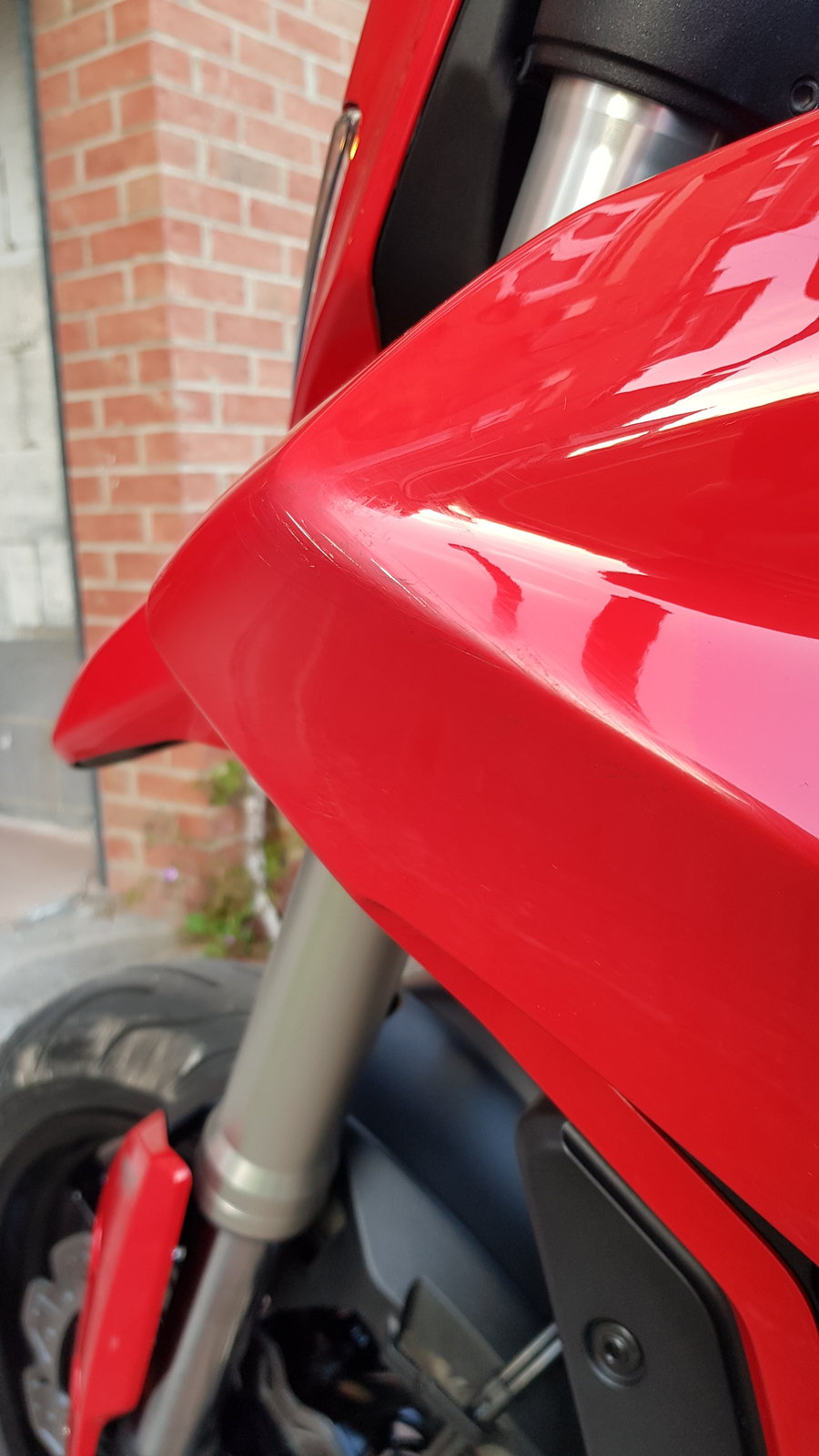

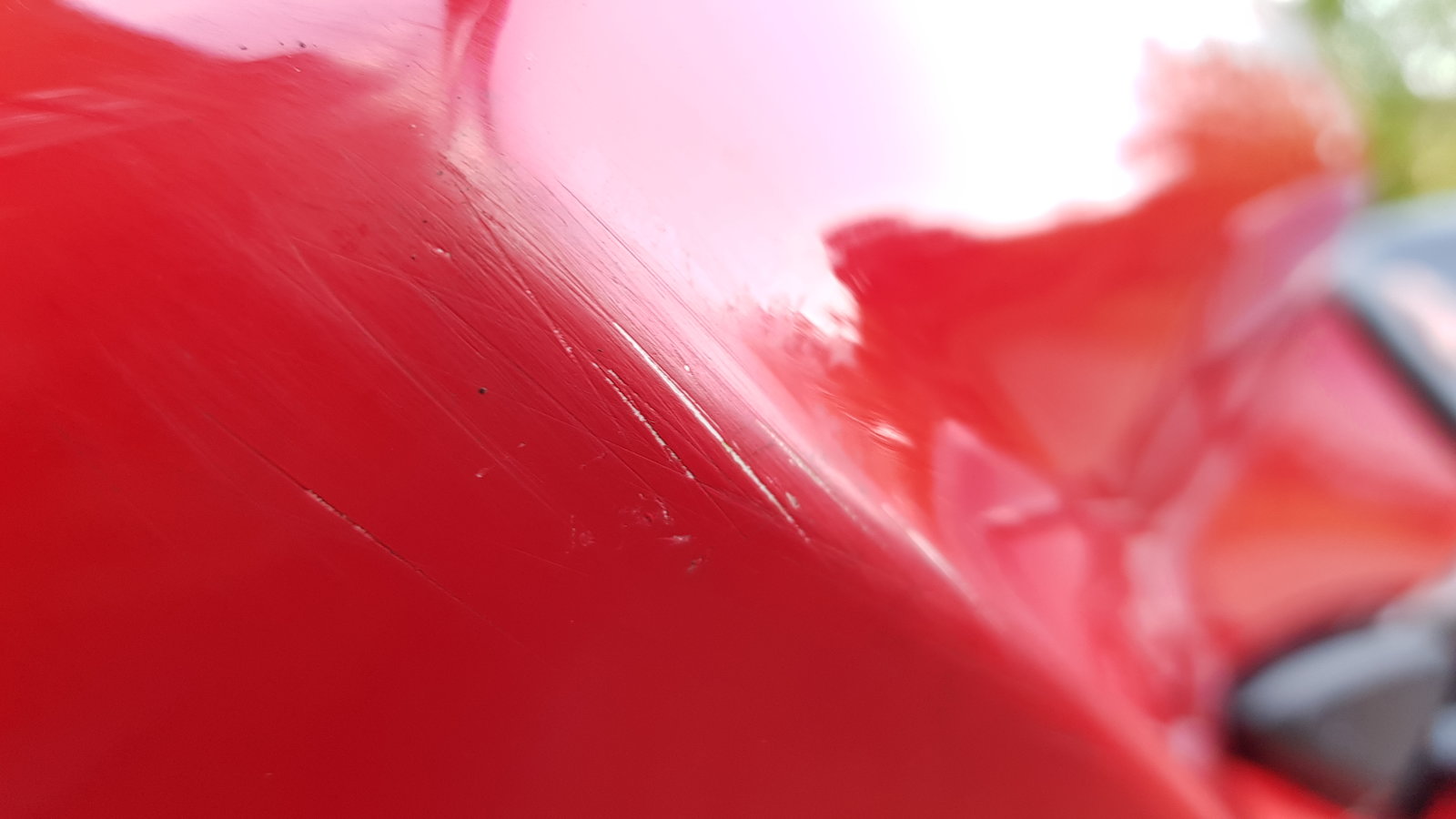

    Also, for those interested, the scratch(es) looks something like this.
