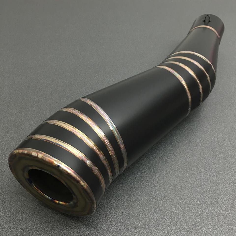

  13. It’s all about the preparation when your looking at rattle can options! And of course the right type of paint. The only downside with changing to the underslung system if your painting it yourself will be how durable the finish will be as it will be prone to stone chips. Not the same application I know but I painted this one sometime ago with great results. It was originally silver and grey but just fancied a darker colour so opted for satin black finish.
  14. Yeah the position of the cans makes them prone to getting chipped. I'll give it a bash and see how it goes, nothing to loose. That looks a great finish you've got there :upyeah:
  15. Definitely worth ago. Like I said preparation is key. I’m sure as long as you use the right product and let it fully harden it should be fine. I used Halfords paint but perhaps shop around as plenty to choose from. Temperature up to 500c

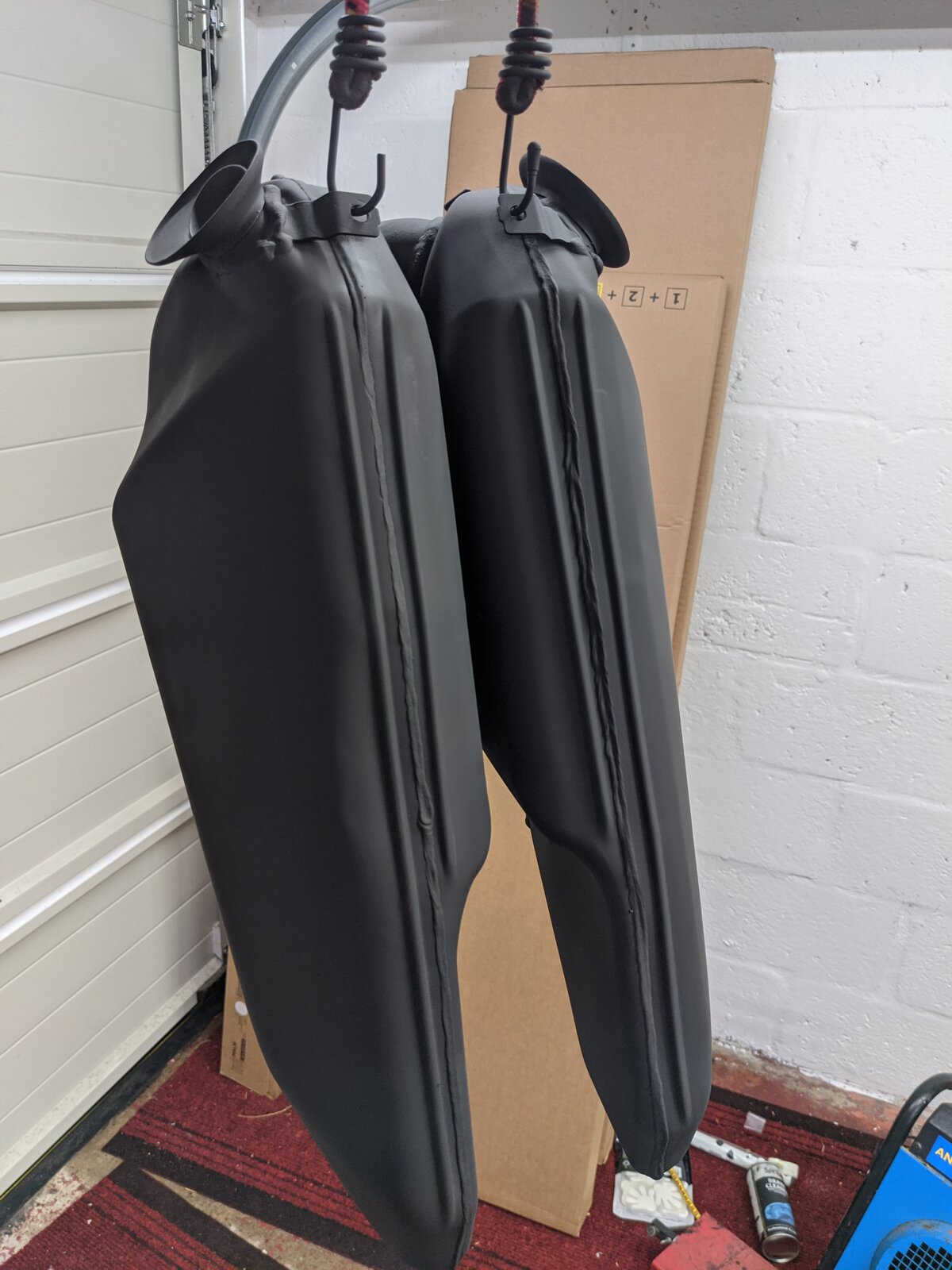

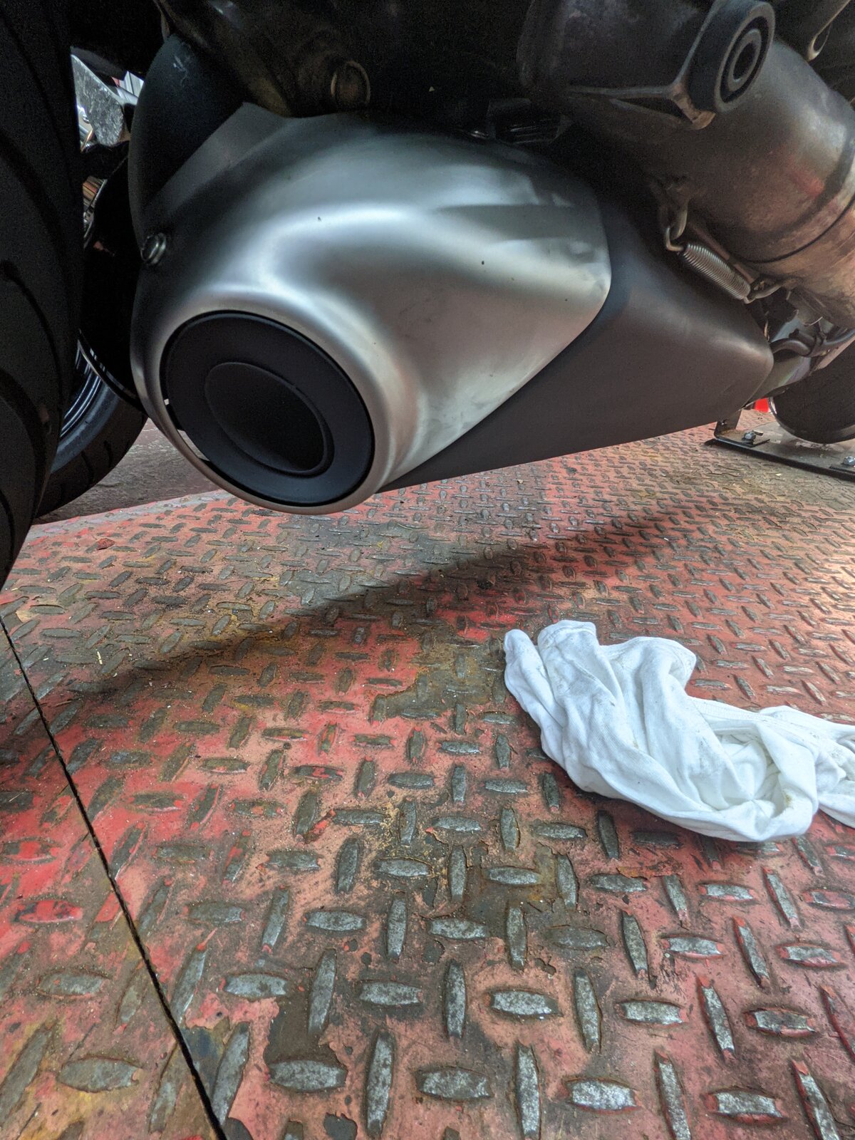

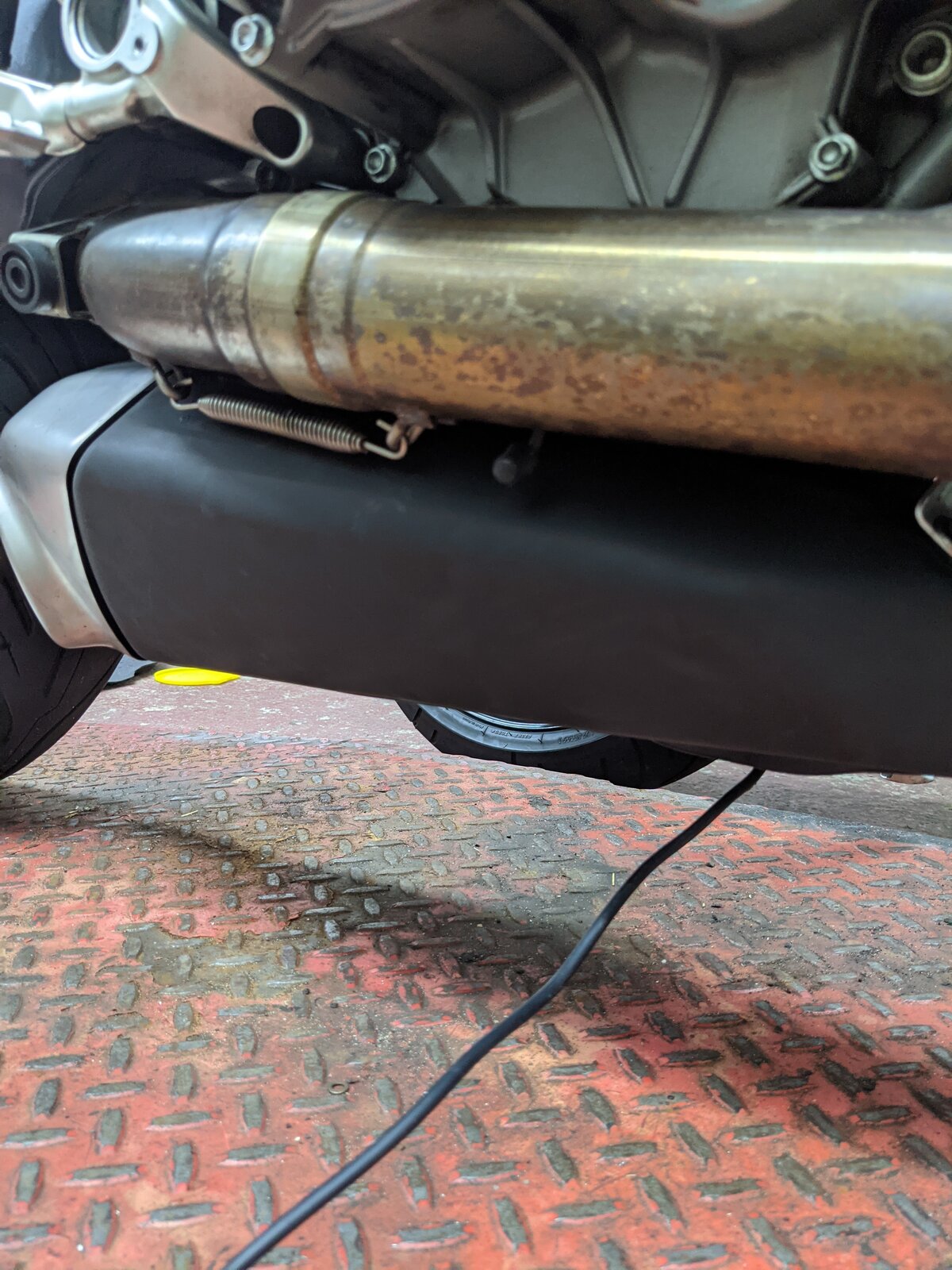

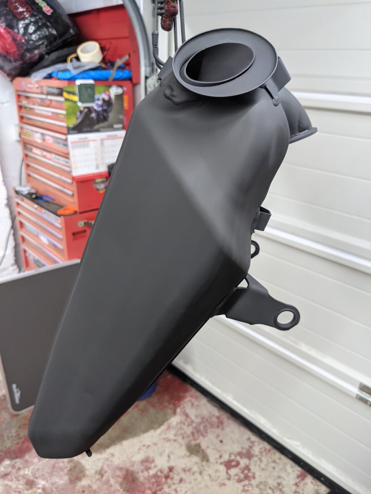

  16. PXL_20210205_164507729.jpg PXL_20210205_164523580.jpg PXL_20210207_100619772.jpg PXL_20210206_221219309.jpg
    Happy with how these have came out and the bike looks and sounds a lot nicer.
  17. Job’s a good un!
  18. Now a bit of Scottish brite, autosol and elbow grease will have that horizontal mid pipe looking a mile better.
  19. I was going to be lazy and leave it but I think you've shamed me into it :joy:
  20. Soz mate! :).
