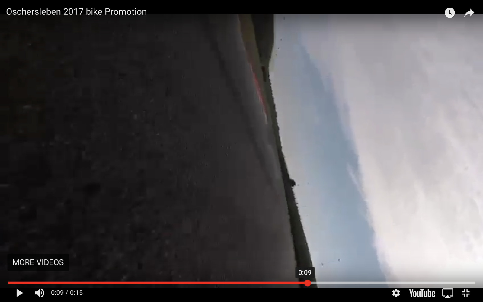

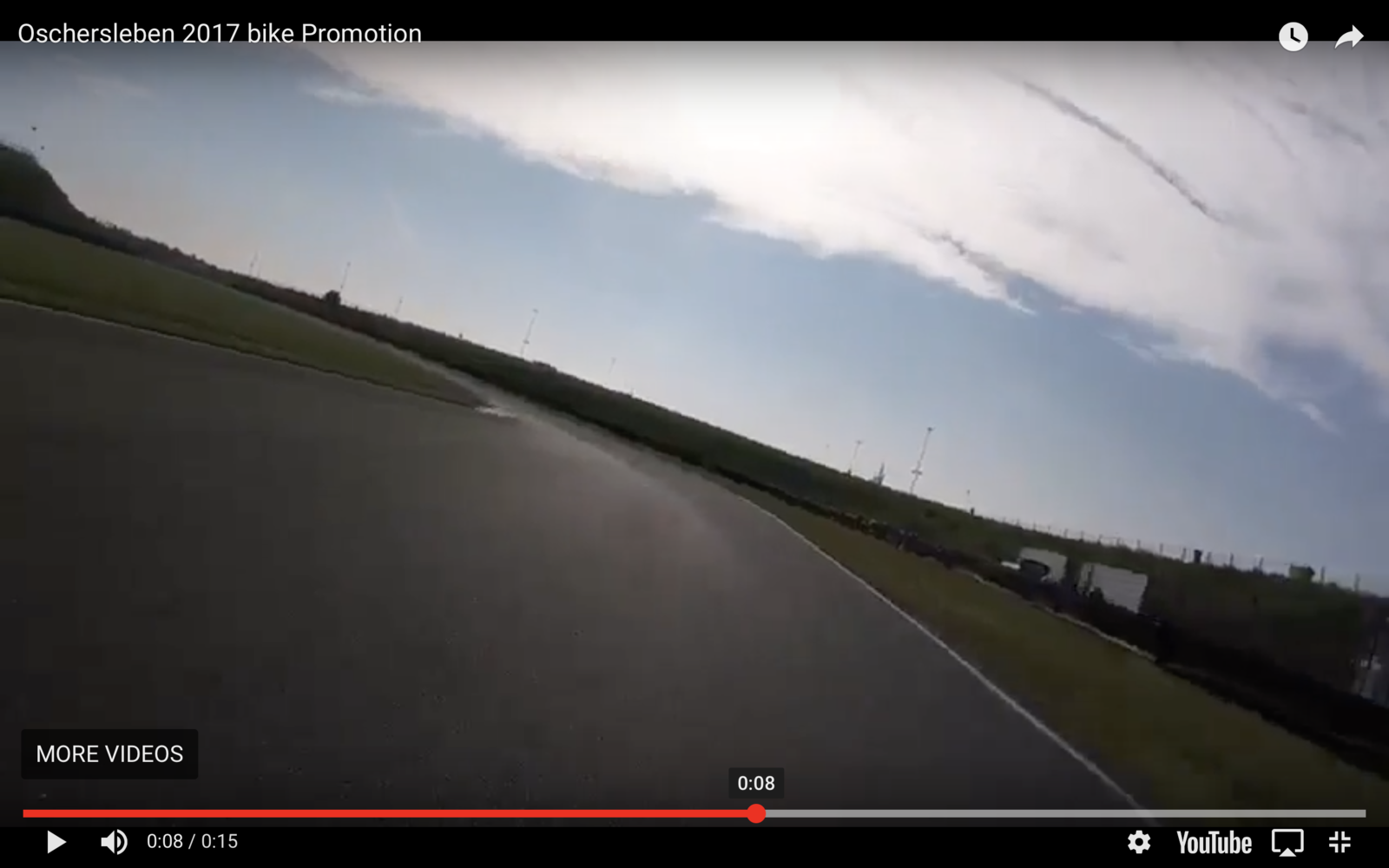

  7. Bad luck, it's just money though and the bike didn't flip. On the vid ~:09 you can clearly see a dark line, maybe that's fluid someone dropped. It may be too early for someone laying down rubber entering a corner.

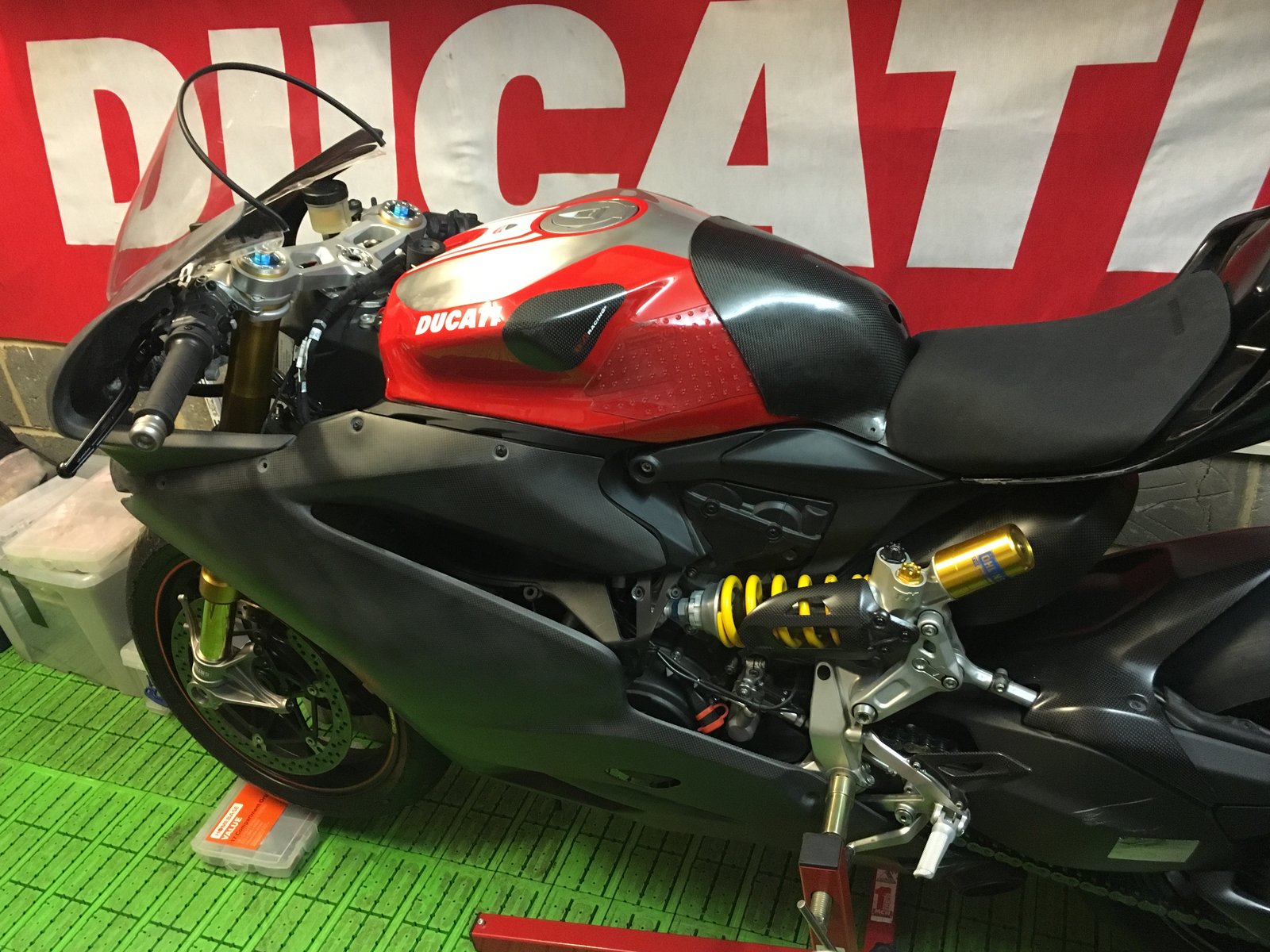

    What a monster of a Bike, Changing the rear spring to one suited to my ‘dry ‘ weight made a huge difference to corner exit...
    Just converting it back to road kit to make use of the next few weeks sun ( here’s hoping)
