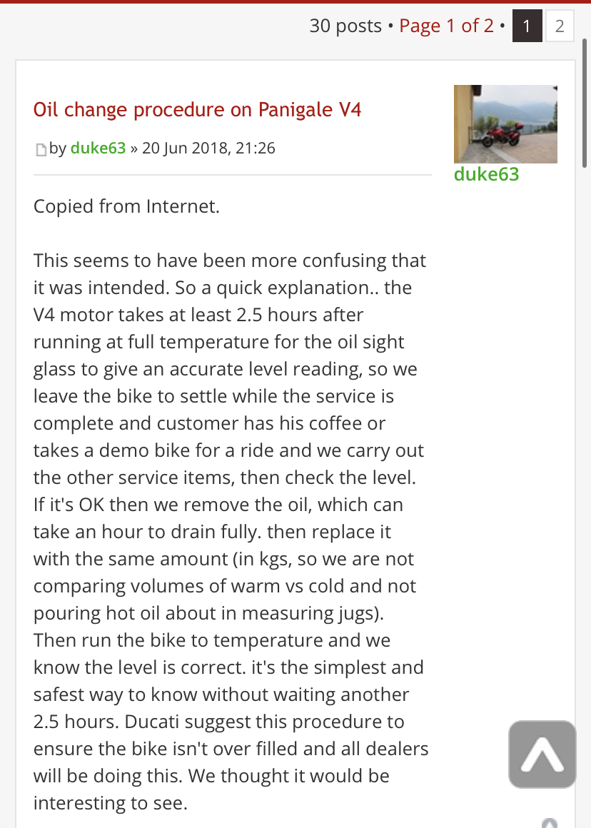

    So after you put in what you believe is the correct amount - start it.. leave it warm up for 5 minutes - then turn off and wait for it to drain back to sump (10 to 15 minutes) before you check again.

  17. Crowfoot spanner on the torque wrench for torquing the sump plug. Don’t overtighten. It’s 14Nm for reference with a dab of sealant on the threads.
    The oil change is a pita for a workshop tbh. With the engine hot, the level can’t be taken true for about 4 hours imo. Maybe I’ve convinced myself, but leaving the bike on the side stand seems to speed it up a little. Warming the motor up prior to draining serves no purpose other than extending the job.
    We drain and weigh the oil. It’s pretty reliable and saves us time. Still best to try and leave overnight to get true level and get it right.
    The issue is caused by the scavenge pumps. When the motor stops, so do the pumps and oil has to rely on gravity to run through them to get back to the sump.
    Turning the motor over in gear helps, but I’ve resigned to patience and weighing the oil method.
