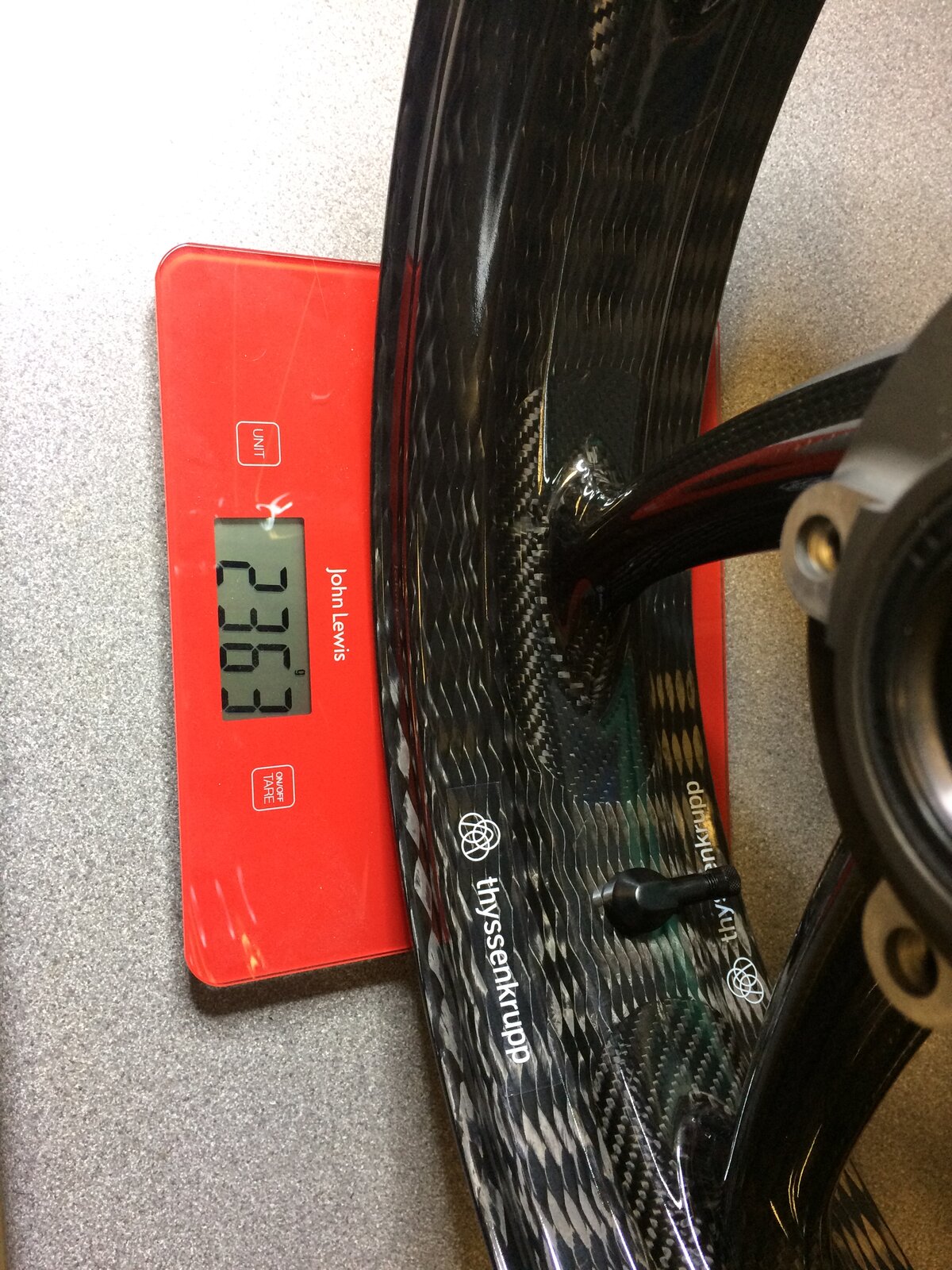

    No, my o/e 899 wheels are on here for sale as I’ve gone carbon.
    This is the weight of my front wheel with bearings & valve but no discs/phonic ring.

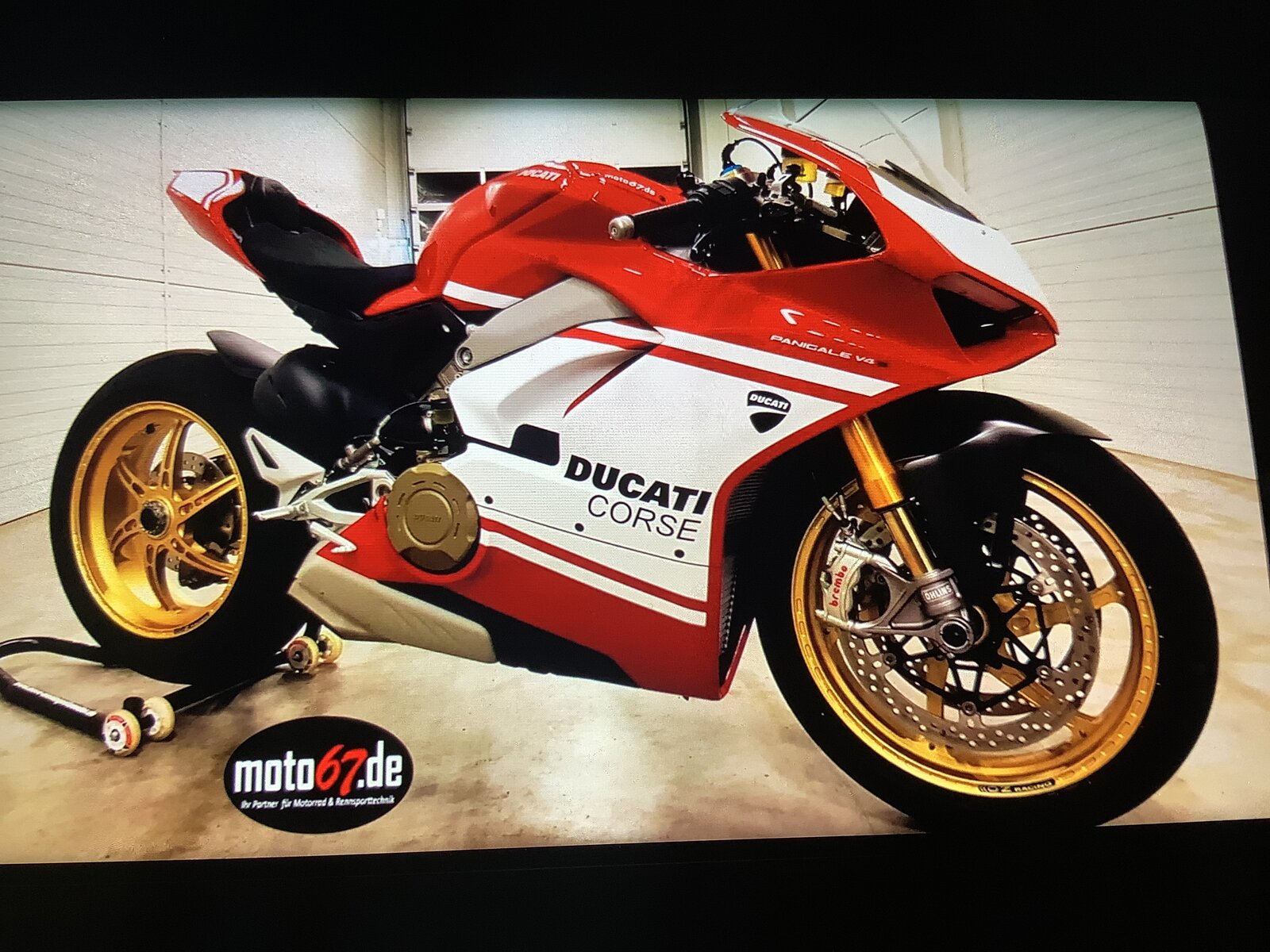

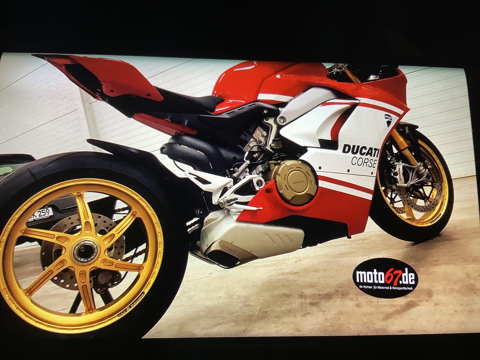

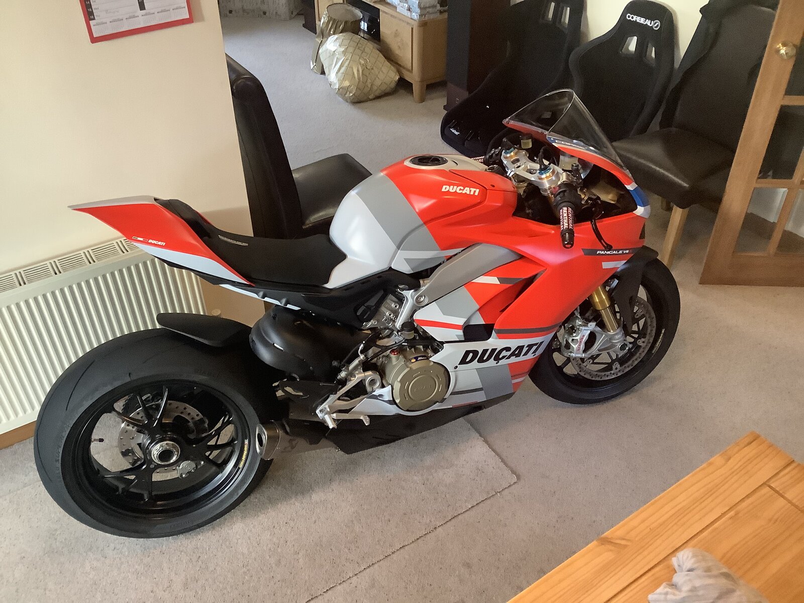

  10. So Dave - when does the V4S arrive? - Or do you already have it? :cool:

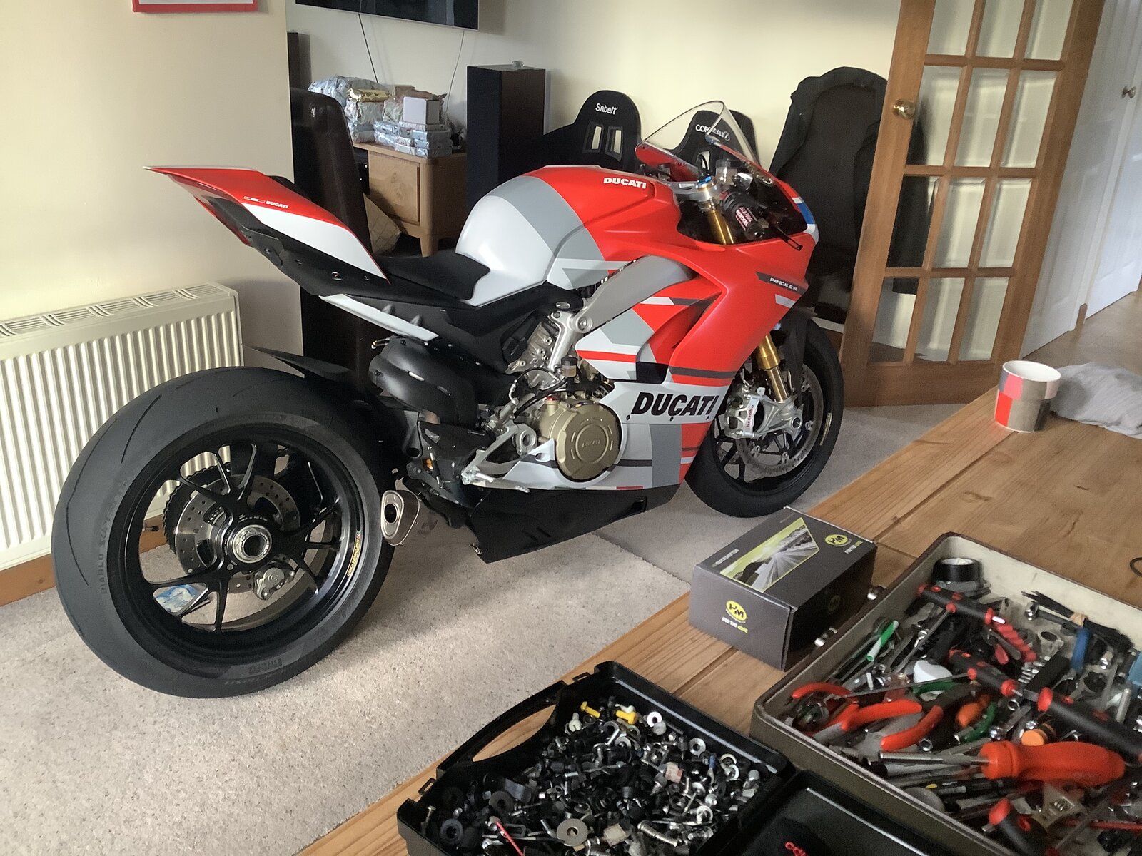

  11. 701A266D-782A-4014-9C38-AE17AC5F6FEC.jpeg DF37AACC-95CE-4267-B6FC-6D15ED3E9980.jpeg C48C465F-1ACF-4EE6-829E-47E0384EA232.jpeg 04370A3A-9F0D-42A1-A719-421CD1A6D551.jpeg
  12. Now that is a bloody lovely bike!
    I not so keen on the V4 in standard livery but the Corse is sex on wheels!
    I look forwards to seeing what you do with it! I bet you won’t be able to leave it as standard! :grinning:

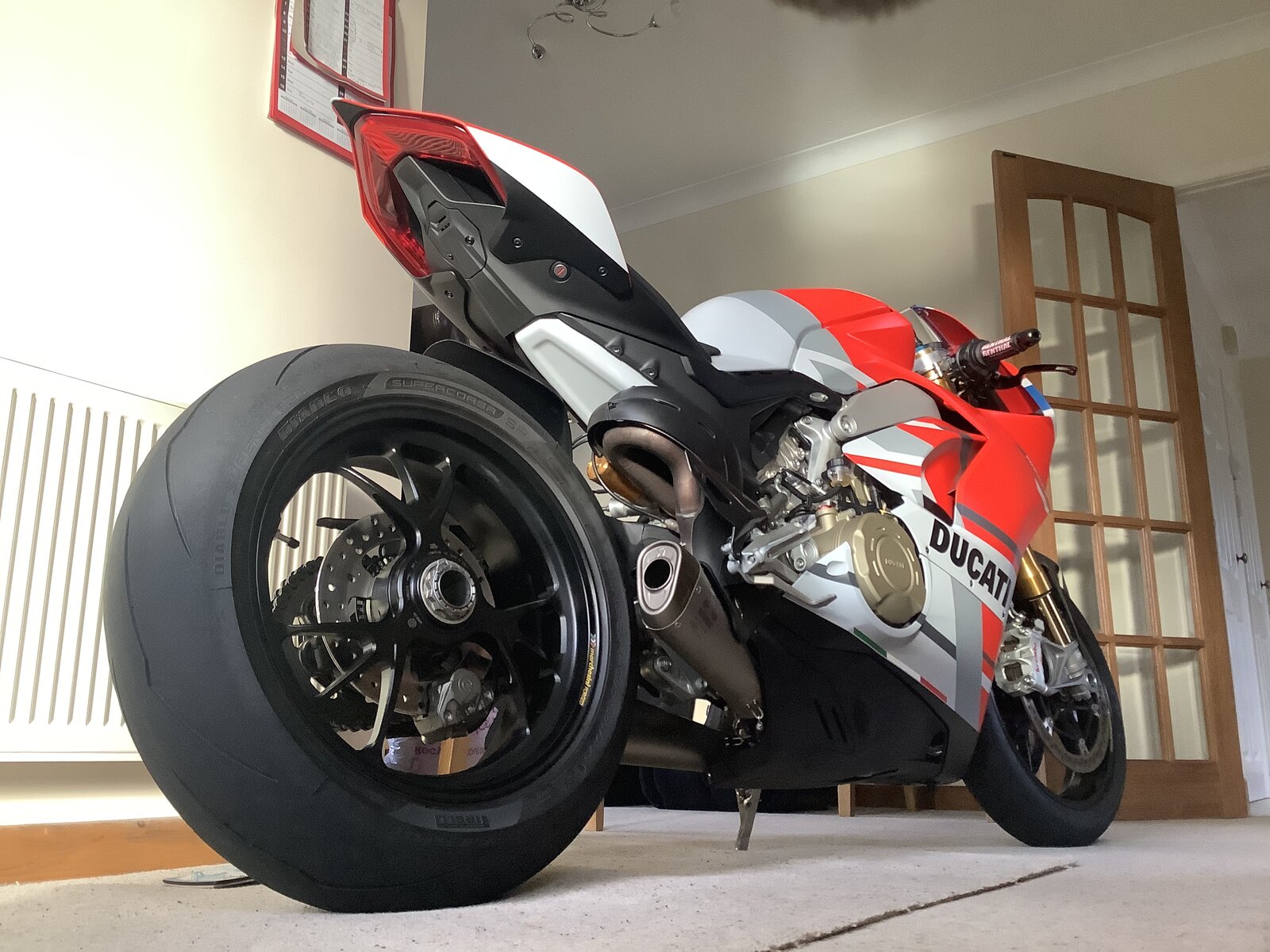

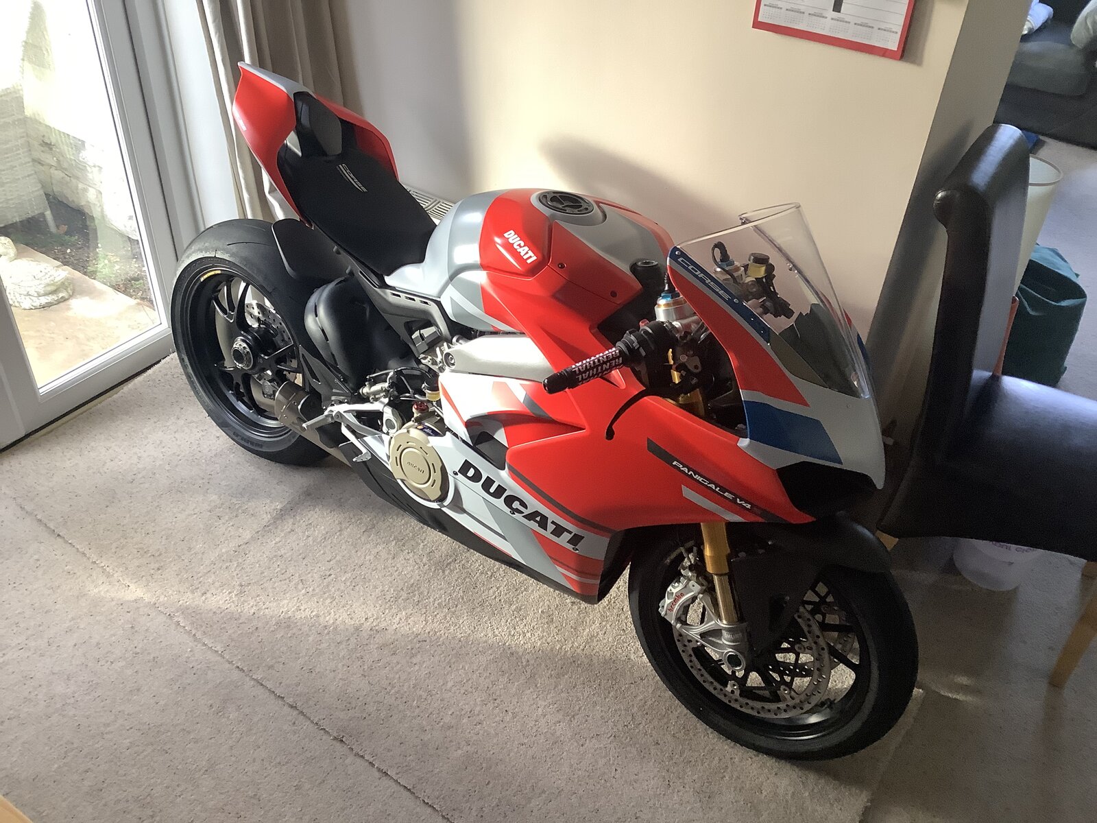

  13. A few additional bits added:D
    48D506FD-8C18-4DCD-9F8A-41E7B0D2EBDF.jpeg 94BE0735-C82E-420F-AE22-70678C0DC4CC.jpeg B95A3642-C4D9-4EE2-9B5F-F94D886264DF.jpeg 720F6BF0-2F24-41CF-BD79-8F878DFD5474.jpeg

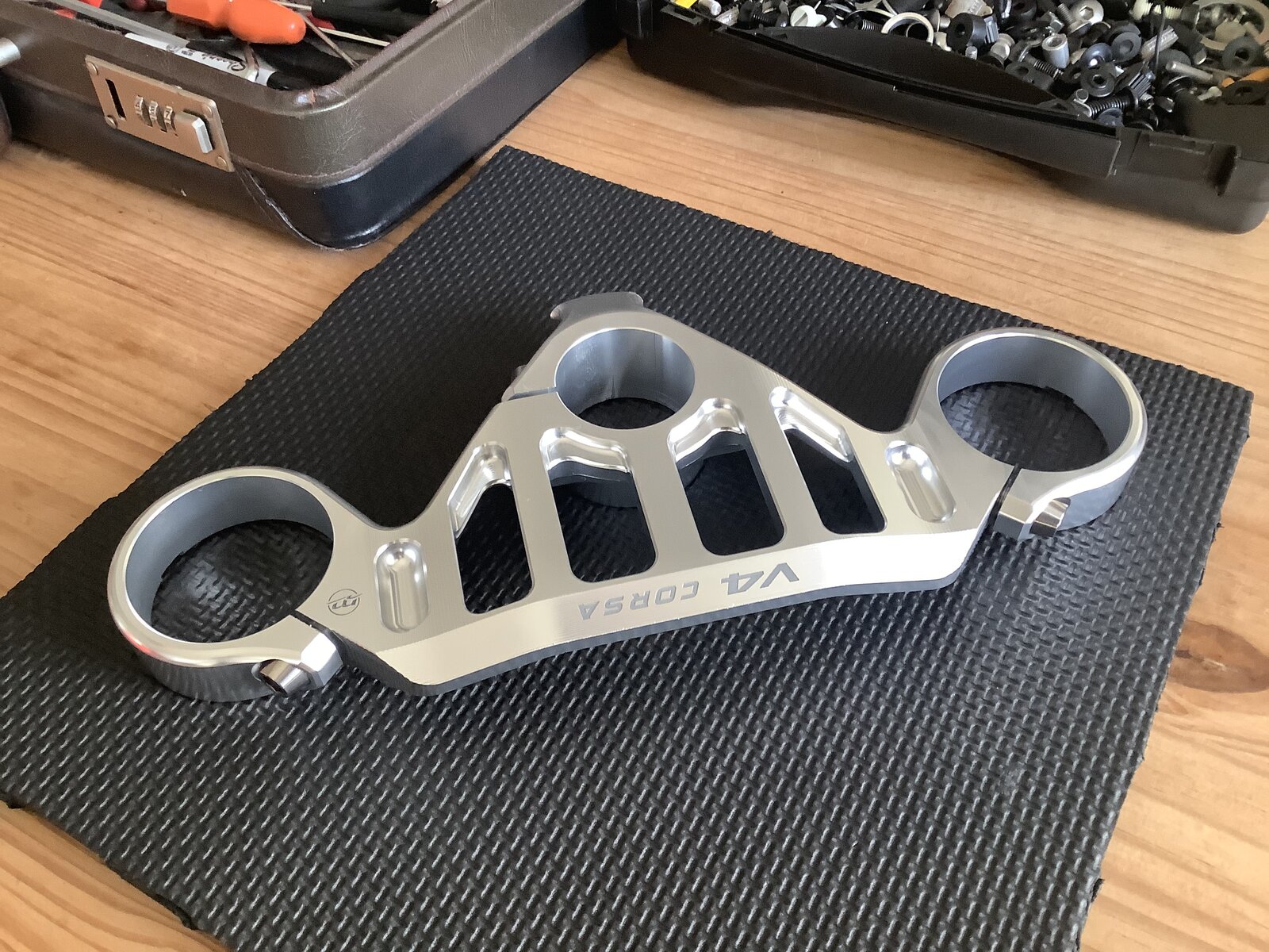

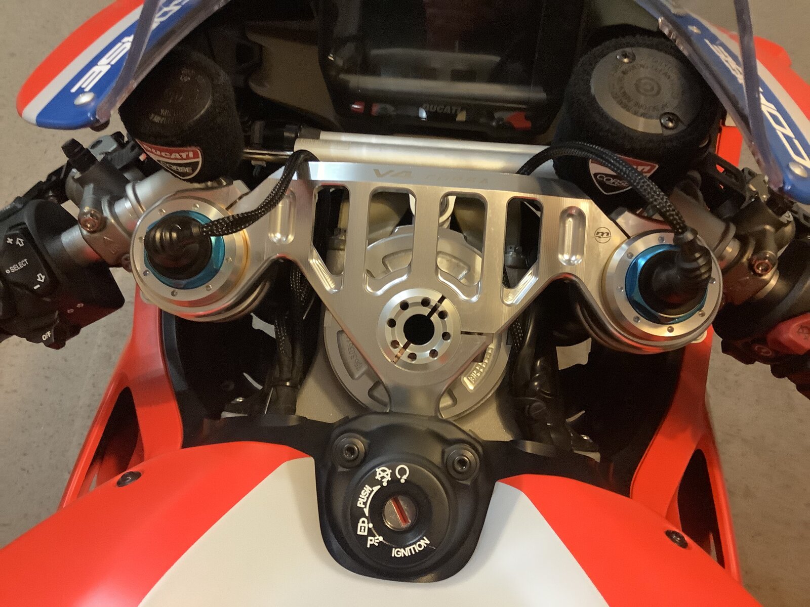

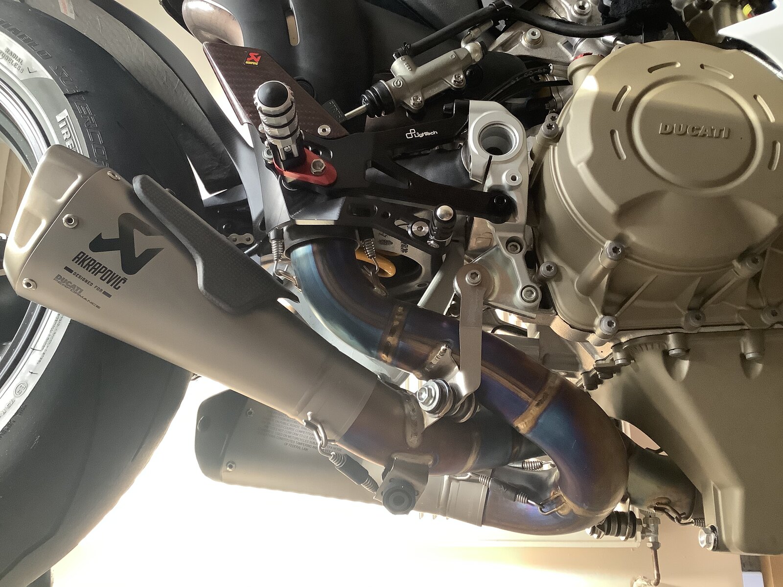

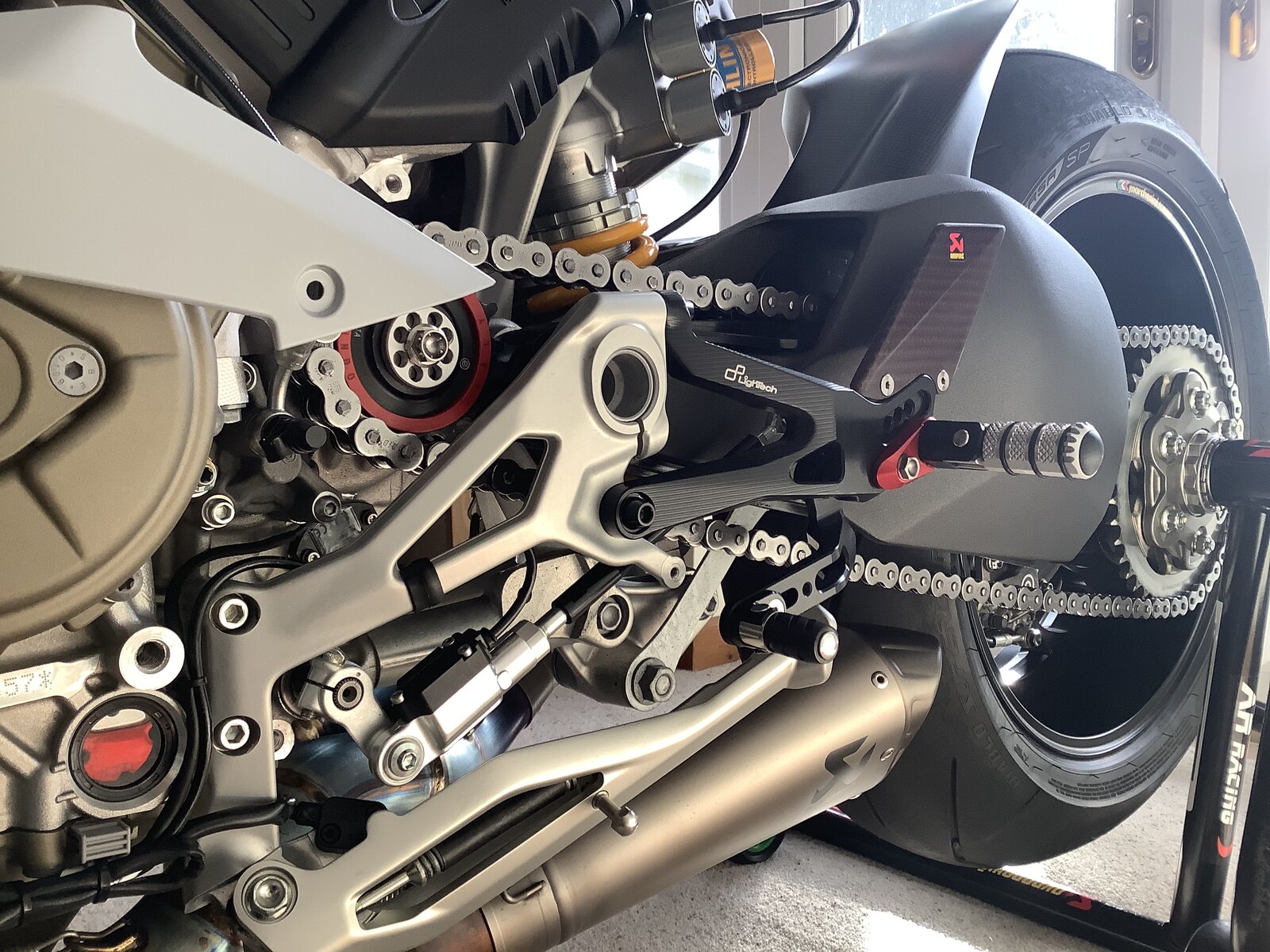

  14. Stunning! Are you running race shift or road Dave? Just wondered how tricky it would be to swap as normally I just relocate the spigot but looks like I may have clearance issues with the Ducati! Loving the top yolk

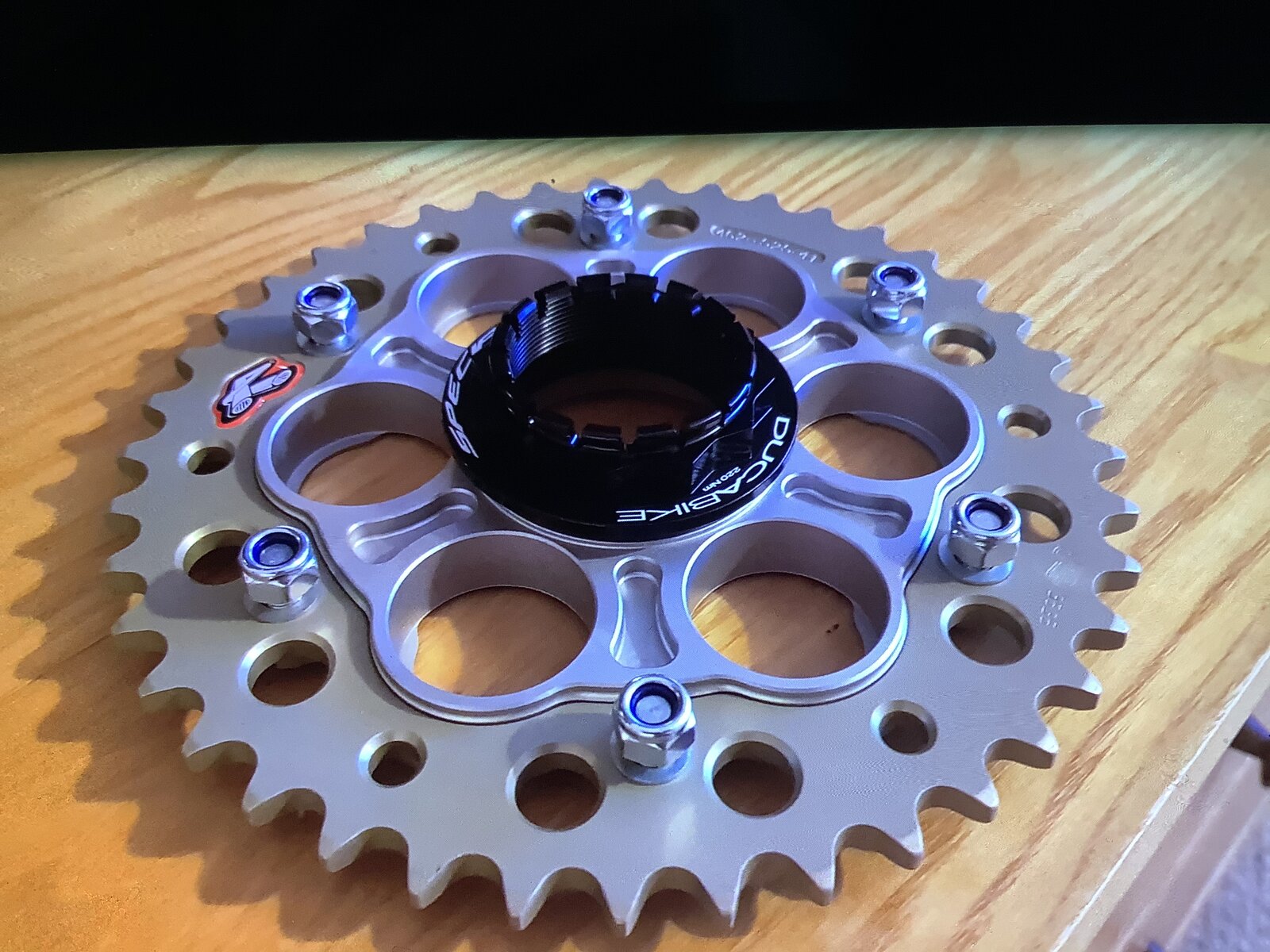

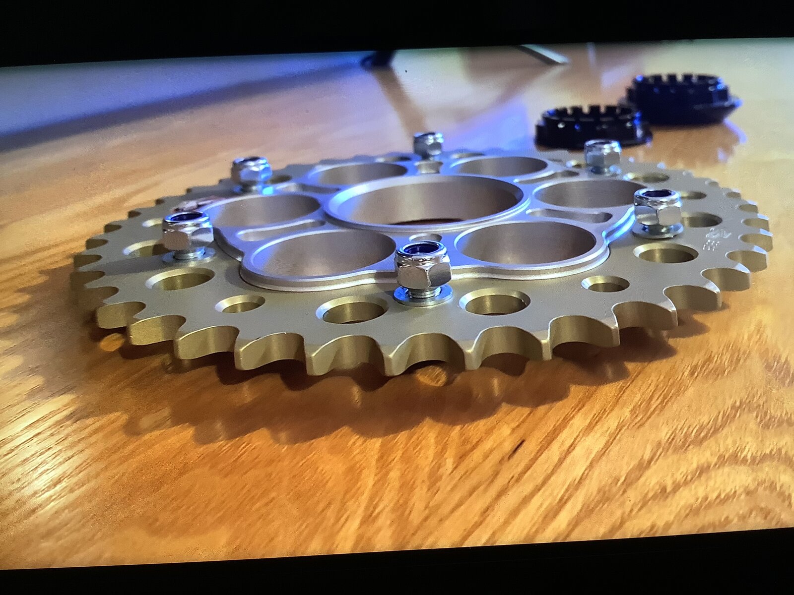

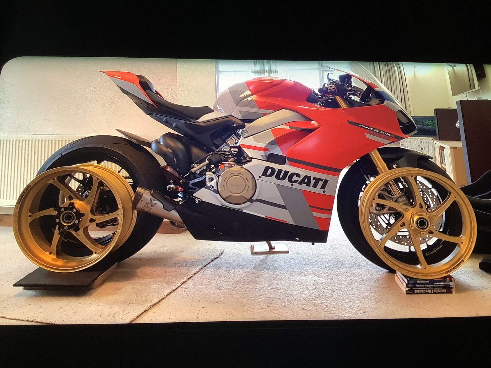

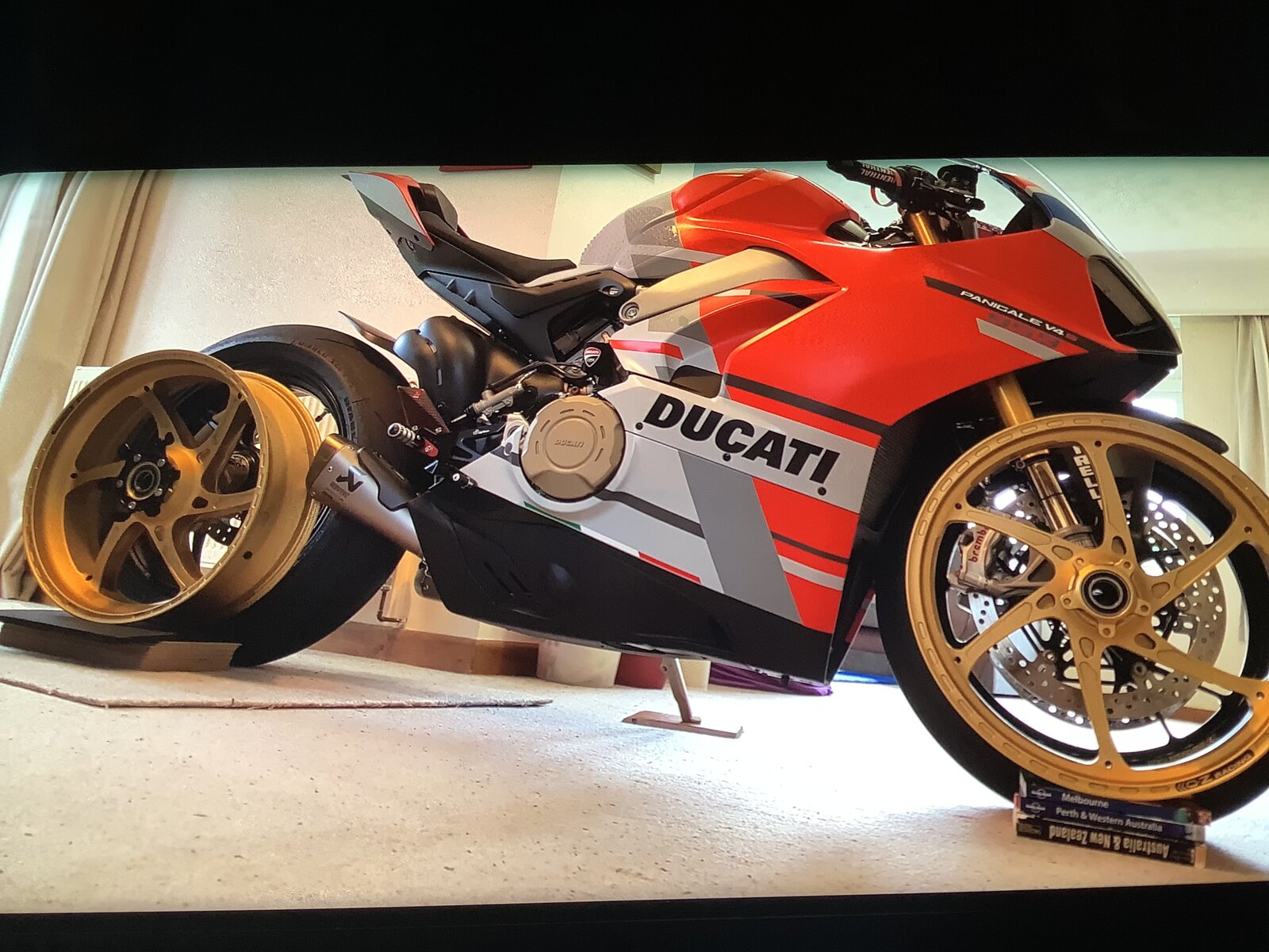

  15. And a few bits removed.... Evaps all gone, Carbon undertank protector, clear stompgrip, Renthal sprocket carrier plus Ducabike rear wheel nuts, Rear Carbon Hugger, loads of Ti bolts, PO8 filter fitted, Still waiting for other parts to arrive:astonished: Biggest visual transformation will be the wheels! As light as the Marchesini wheels are the Oz’s will be returning:yum slightly lighter but from my point of view far more attractive. Never been a real fan of the chicken footed spoke design on the OE wheels:eek:
    19D0A4A1-E4E4-4119-B43E-403D018611B9.jpeg 7DE797ED-2A53-4AF8-B597-EB35C22E0554.jpeg B417BFCB-EEBD-4F4E-A4A1-7F1B90C874FE.jpeg 8C668F9A-7398-4165-820D-D0934FD4B7D8.jpeg 6B78E3EF-41F1-4ACA-9044-0BEF8613AB6E.jpeg 20B87674-FE5A-4F5B-8825-2FE1C90C9DB4.jpeg 139582F5-D05E-4AB7-9CB0-14336F9D634A.jpeg
  16. Just mocked up for now but will be running race shift, just requires shifting the rod to the bottom fixing already installed. It’s bloody tight though and think it’s going to require some modifications. Removing OE shift rod was a mission! Well least till I added some heat. The yoke was really extravagant but I managed to get a half decent price back on the old Ducabike item... It’s on a completely different level and super happy with the engineering quality.
  17. Thanks buddy,be good to see it with wheels on! Love the way you have it in the houseI tried! I failed!!,
  18. This may be the stupidest question on the internet, but is that saying the front wheel is 236 grams?!
  19. 2363 grams
  20. Phew!
    Was taking the bit at the top as if it was a decimal point....oops.
