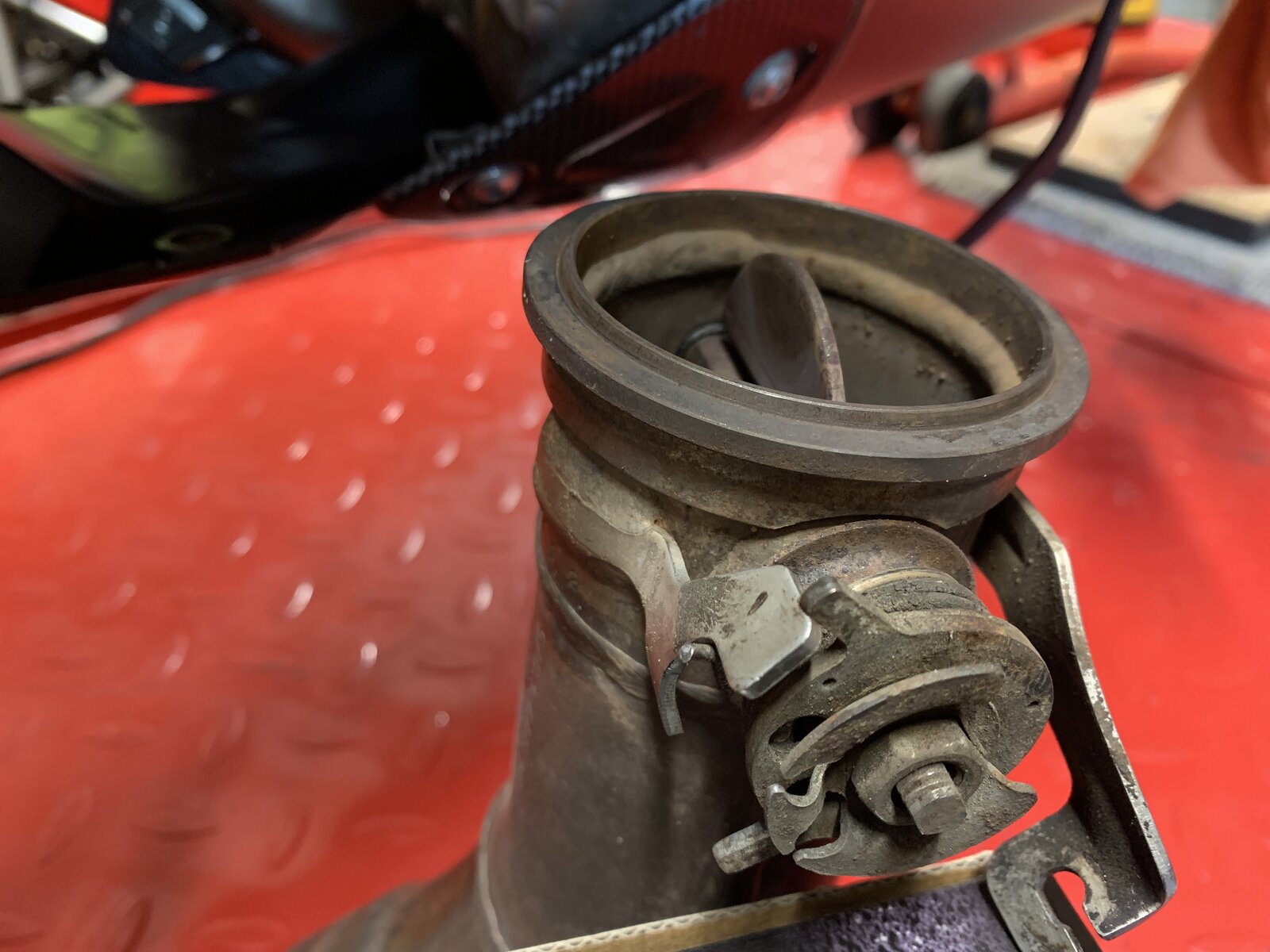

  1. Hiya a quick question is the flapper valve fully open clockwise or anticlockwise if you know could you please let me know. It's been wired before but its come loose and it's no longer spring loaded, so I'm just wondering which way to wire it open.
    Cheers
  2. I have a 1299 y piece in garage. See pic. The stop needs to be anti clockwise for valve to be in fully open postion. 4886FBB4-3B70-42EF-BF20-A26DAC2DA9C9.jpeg

  5. Many thanks for this info much appreciated cheers
