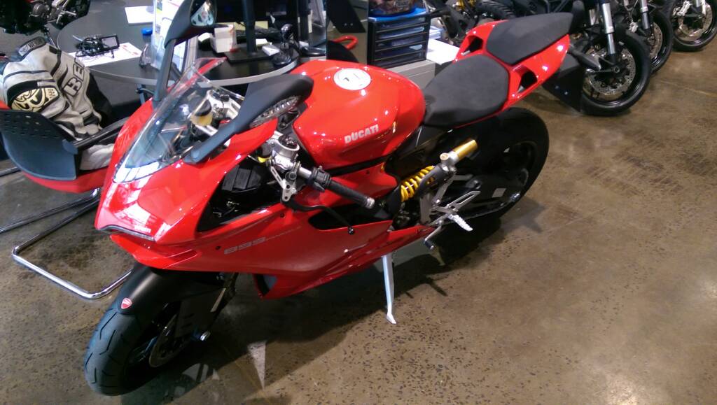

    So with the price difference between new and used been basically negligible because of the add-ons people had installed (that I didn't want) I picked up a brand new 899 in October 2015
    Clocked up enough time on it over the weekend and dropped it off for first service after 3 days of owning it. Picked it up from service on the Thursday and was at the track on Saturday morning in some very retro leathers that I got for cheap. Great fun!

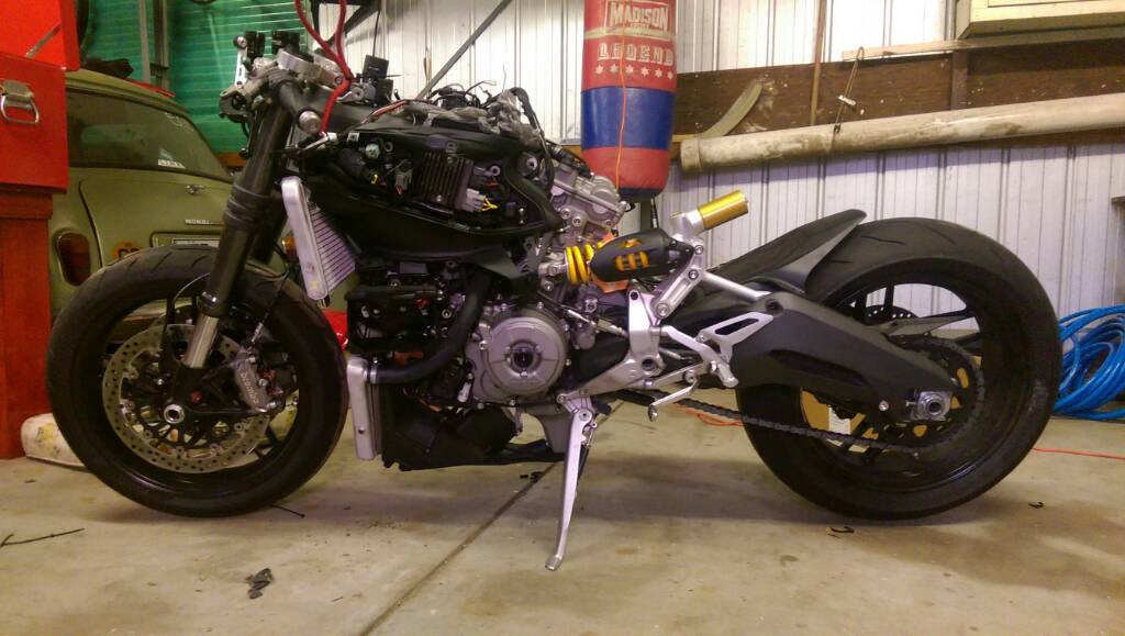

    So within 3 weeks my brand new bike was torn down and looking like this

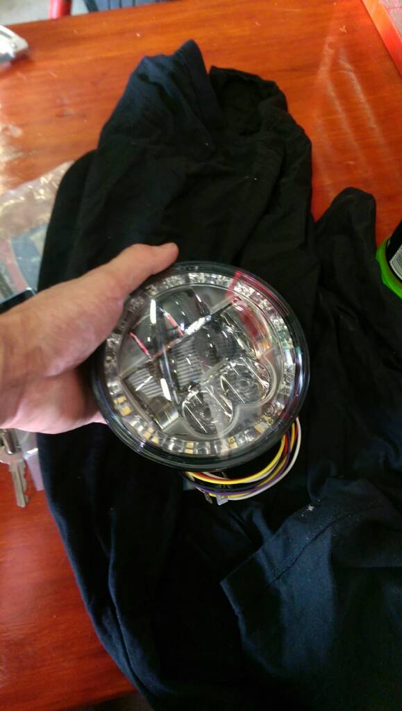

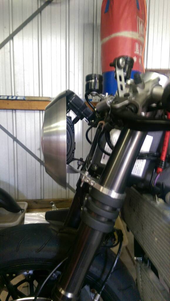

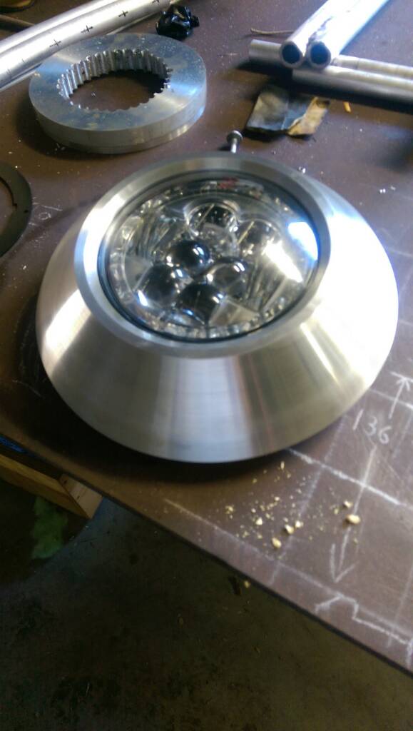

    Plans were made and design work began on the new components with the first new part being a JW Speaker LED headlight.

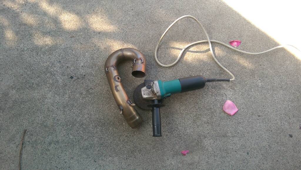

    The exhaust was de-tabbed and prepped for ceramic coating

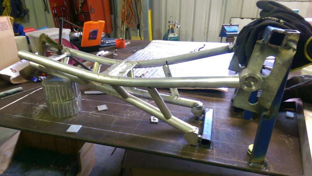

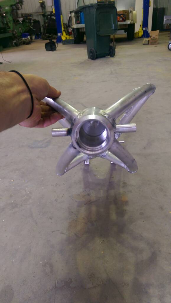

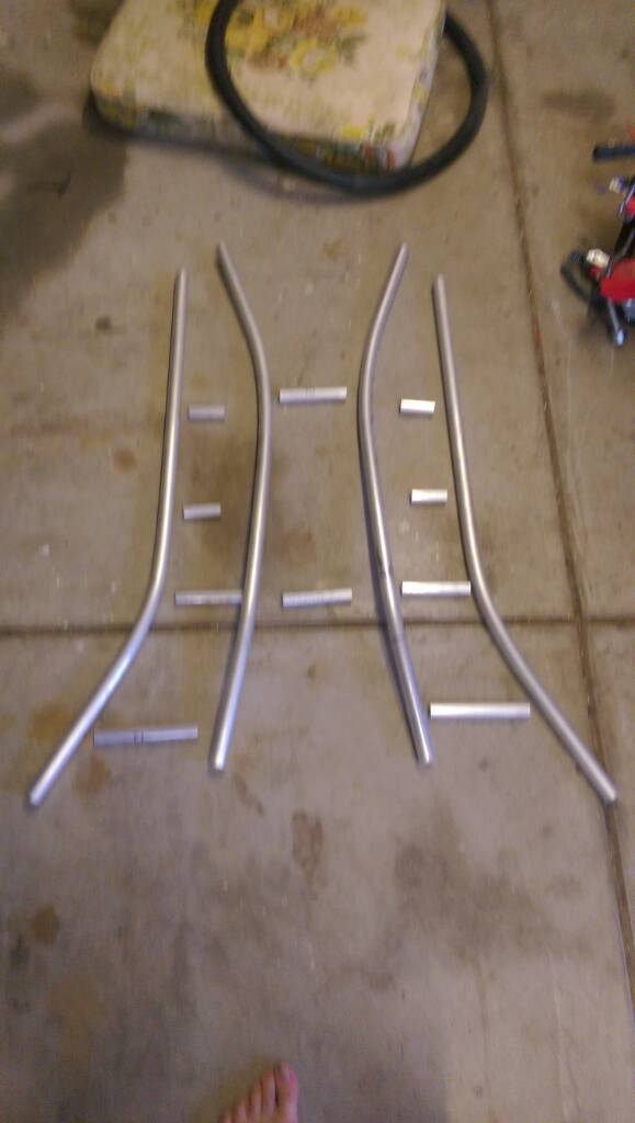

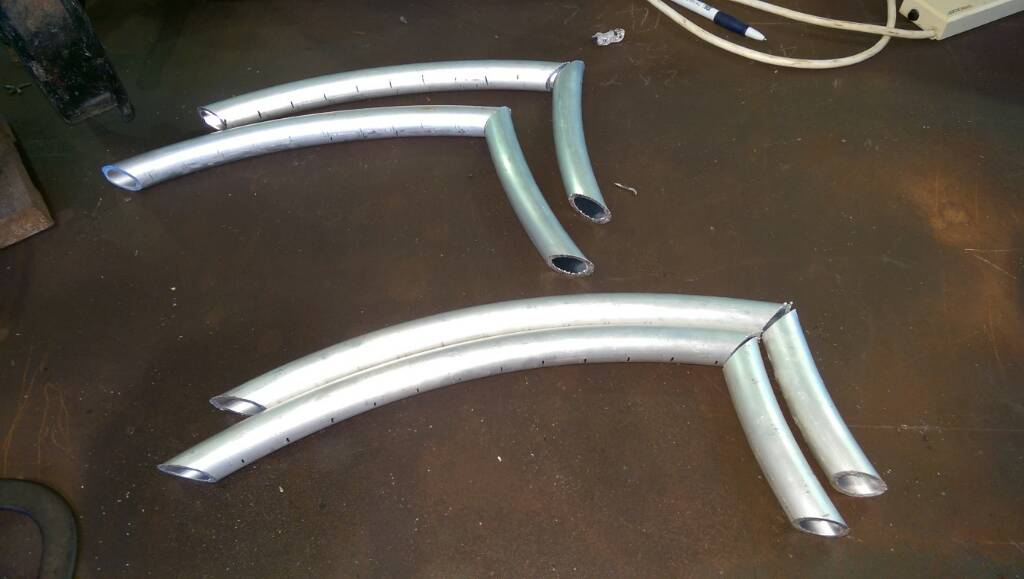

    Some 25mm 3mm thick aluminium tubing was layed out to start the new subframe

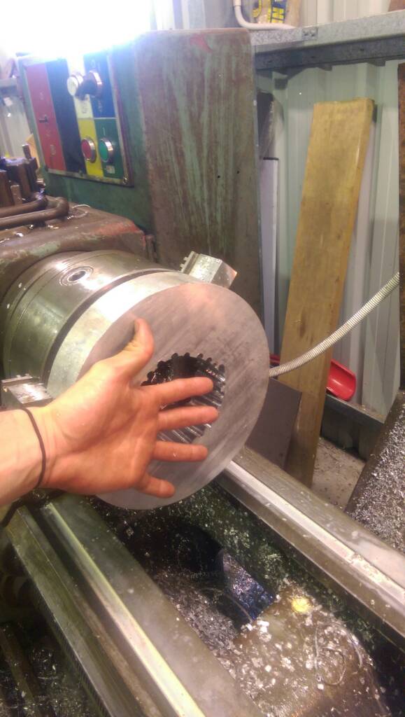

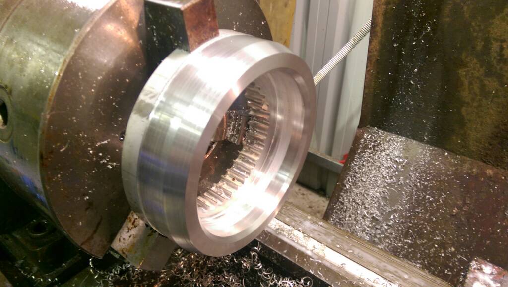

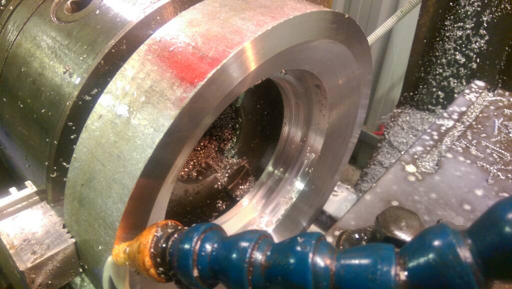

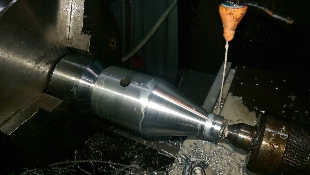

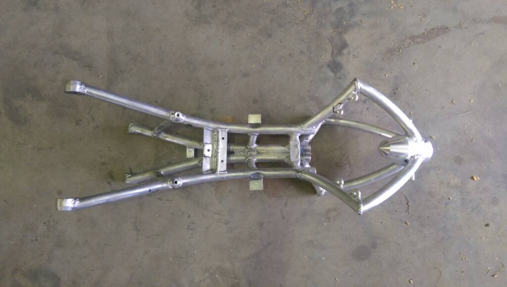

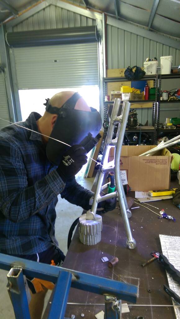

  2. And then machining and welding began.
    First was the headlight surround
    And welding on the new tail frame began
    Headlight and dash position were roughed out

  8. How are you planning to route the ram air into the airbox behind the headlight? Looks very unique thus far!
  9. Yes... mostly...perhaps... you'll find out later
    Sent from my HTC_0P6B using Tapatalk
  10. Machining an opening into the surround and then making a duct

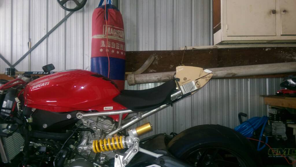

  11. ...now, onwards...
    A bit of cardboard design work to figure out the rest of the tail

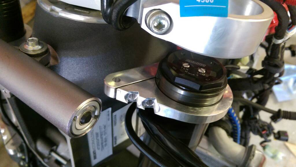

    Some CNC fork clamps I designed and then had made up... for things

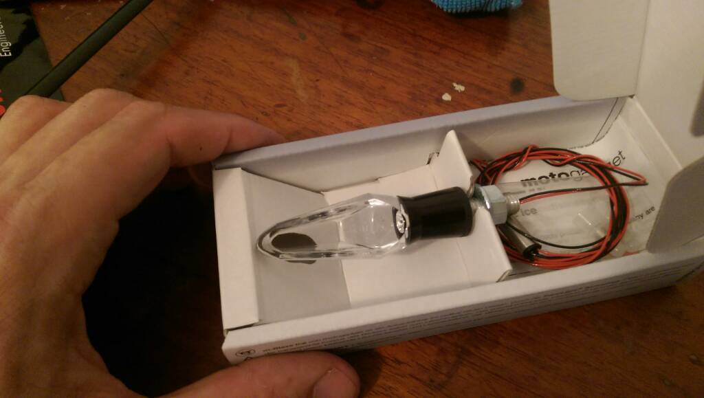

    Well, for these... motogadget ice indicators

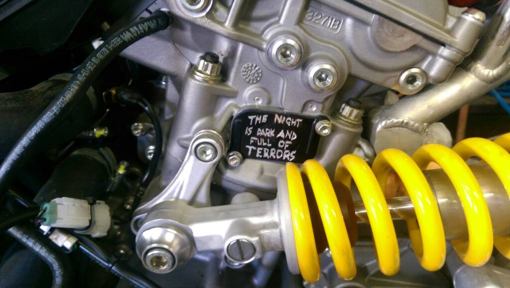

    Got rid of some pesky emmisions hardware

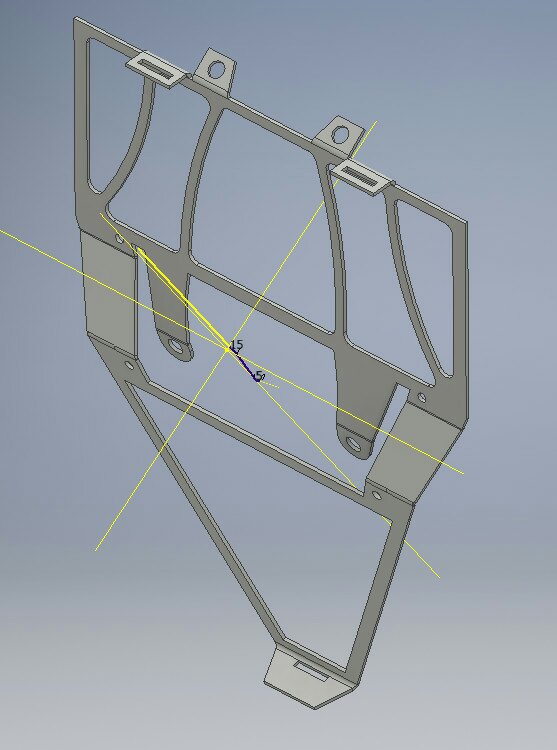

    And started designing a radiator support and a few other brackets that I would need to get laser cut

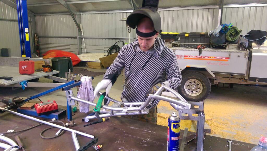

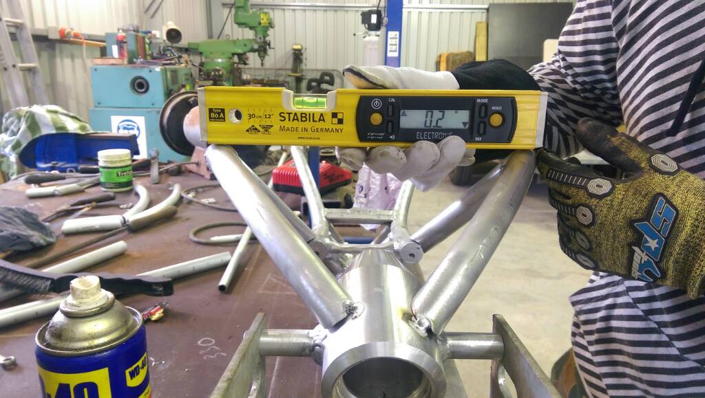

    Then finished off the frame
    0.2 degrees off level... by eye
    This is my brother... he's a fitter and turner, and hydraulics expert. Can also weld

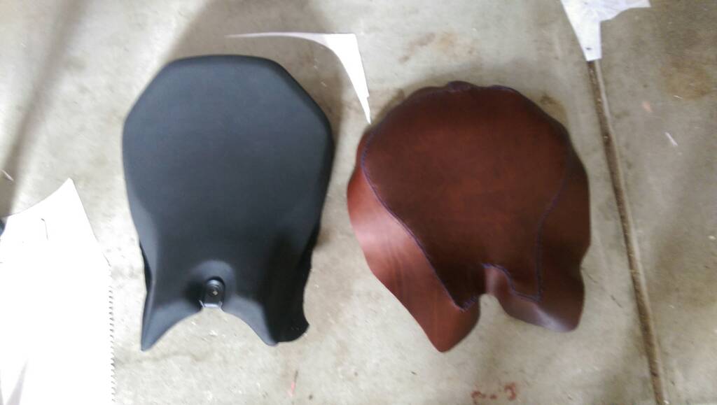

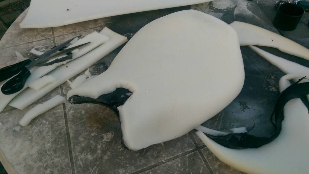

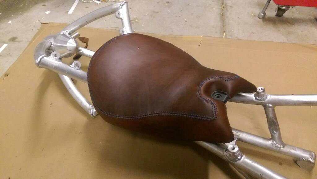

    I like the stock seat, but I wanted a bit more comfort... so it got another 10mm of soft padding all round and reupholstered in hand stitched leather.

  12. I should say that I set out to do as much as possible on this myself.
    So far I've done all the tube bending, all the leather work, all the design work. The machining has been shared amongst my brother, dad and myself on dads mill and lathe. My brother and dad have done all the welding
