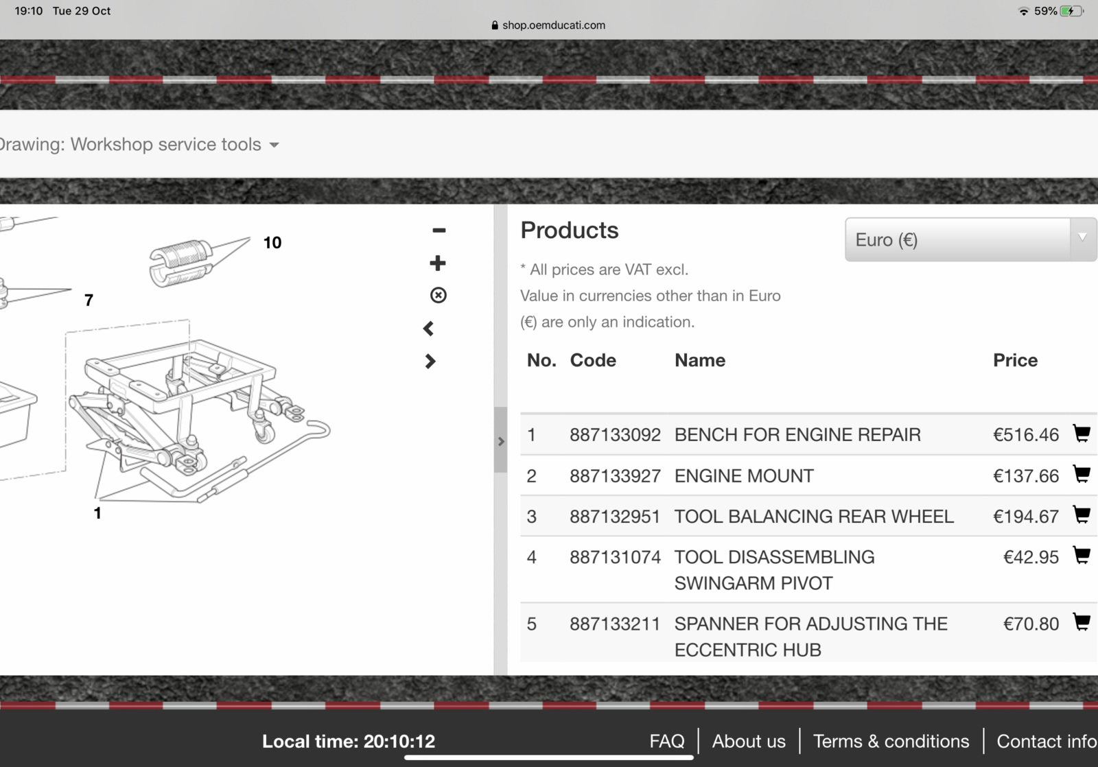

  6. Think it’s this - not cheap?
  7. Thanks for the part number! Agreed not cheap!

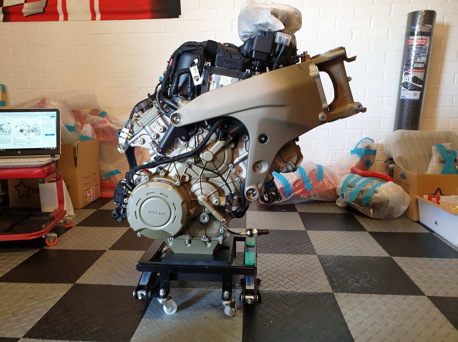

  8. Cant be that difficult to copy.
  9. Think the important part is the engine mount if tailored to engine lower profile for neat fit. The rest is box sections, supports , wheels and two scissor jacks. If no access to welding form the support section and link corners with right angles brackets from hardware shop. Four wheels and supports and fix scissor jacks to underside.

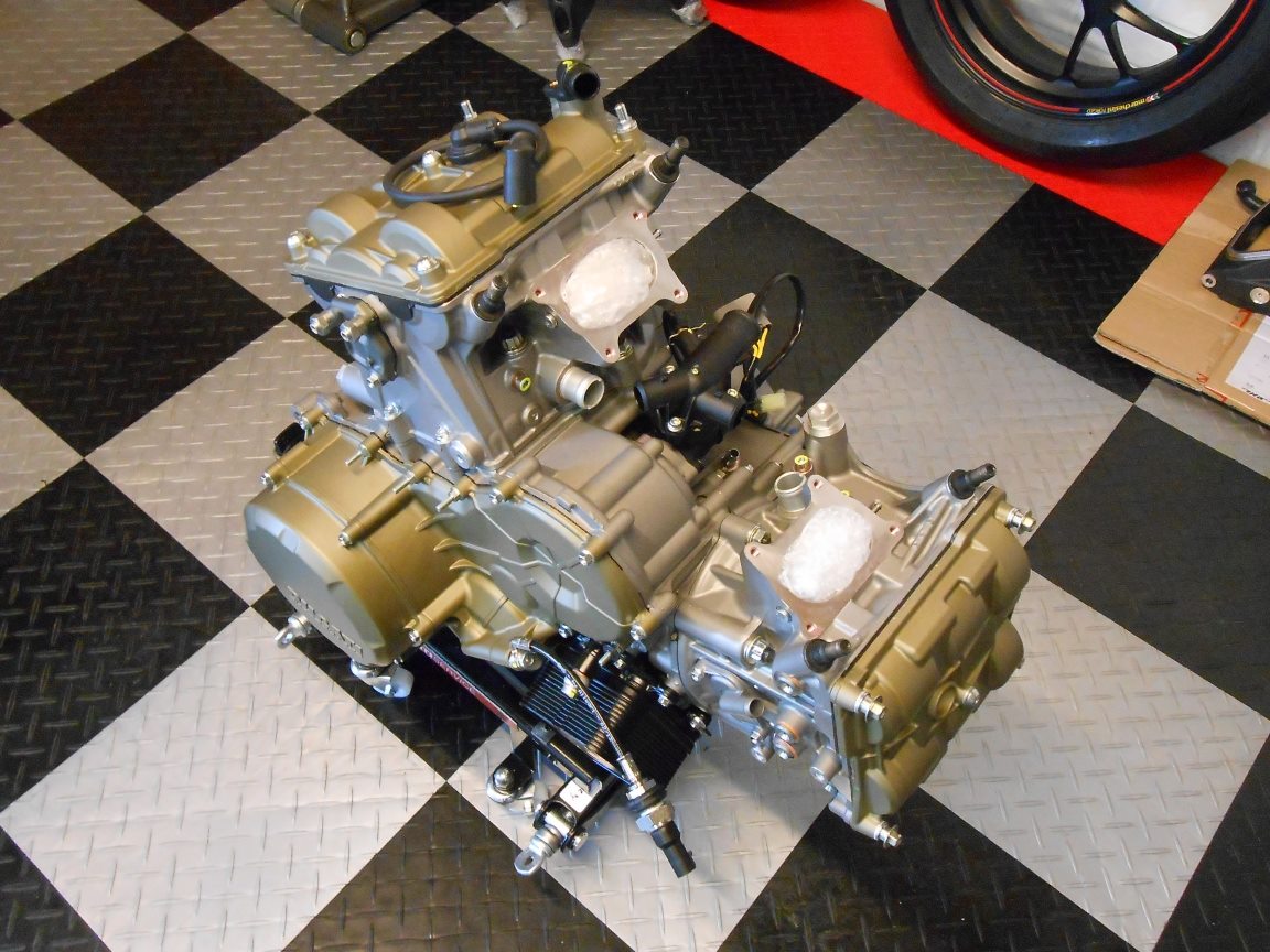

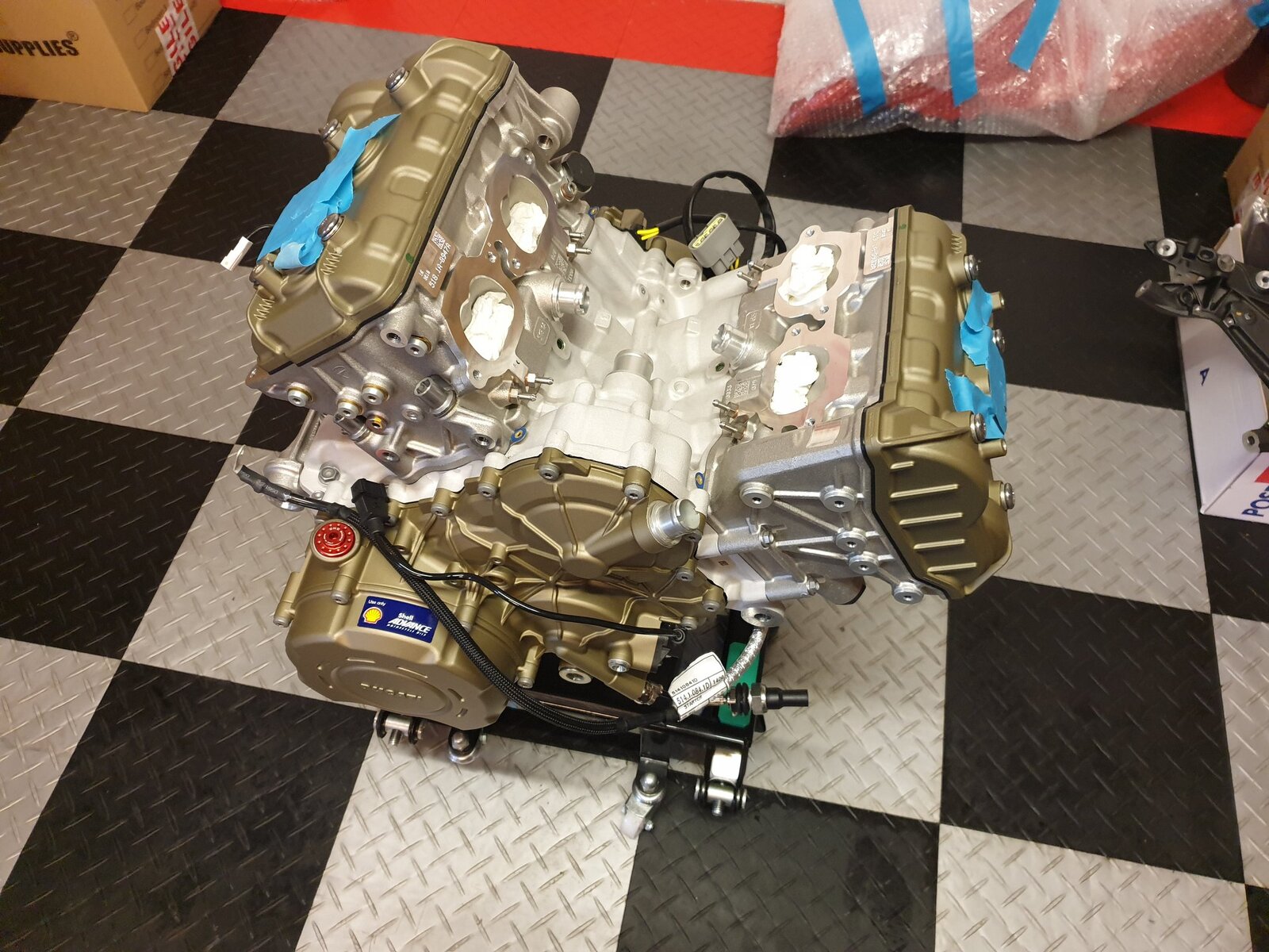

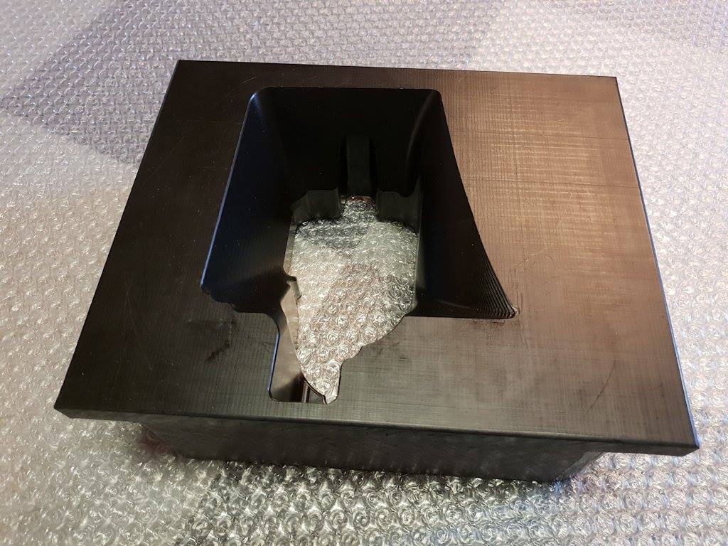

  10. The critical part is the hard nylon/delrin plastic engine sump moulding which is milled out to the exact profile of the sump and sits inside the engine jack/mount. The 1199/1299 one is identical. For the V4 I had to buy another one but used the existing stand as shown. Engine is rock solid once sitting in it, though the V4 engine is a little top heavy so you have to be careful moving it around as it can tip over.
    42168938_478630272652229_625026627578888192_o.jpg 42189080_478630302652226_5323284338991693824_o.jpg
  11. Hi Topolino,
    Did the 1199 insert come with the stand as an assembly when you bought it or did you have to buy it separately? I don't see a separate part number in the parts diagram I'm assuming its an assembly?
    Thanks!

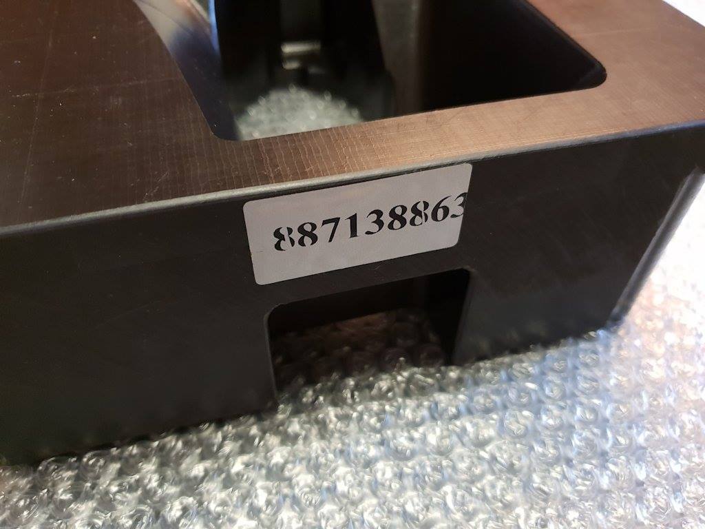

  12. The Delrin is a separate part, I spoke to the dealer yesterday.
  13. Stand Insert- pn 887133927 150 pounds

  17. As ElliotW correctly stated its a separate part. IIRC I paid about £250 for the two. I sold the delrin cup for the 1199/1299 on and simply bought a new one for the V4 which I use with the "old" stand. It is not as stable as Pierobon's stands but they are much more expensive.
