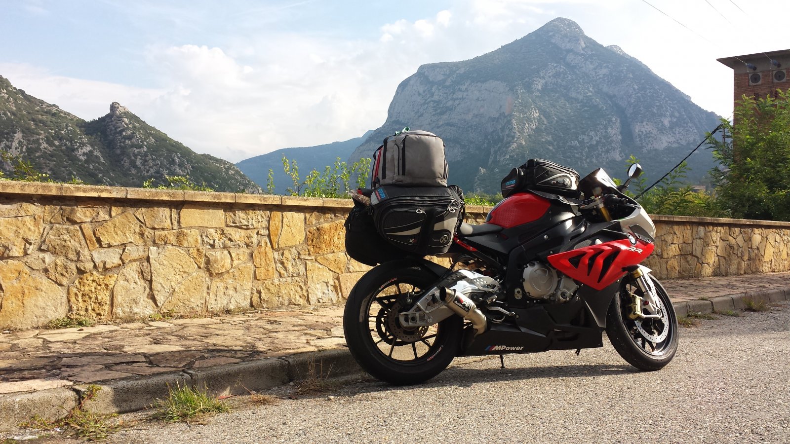

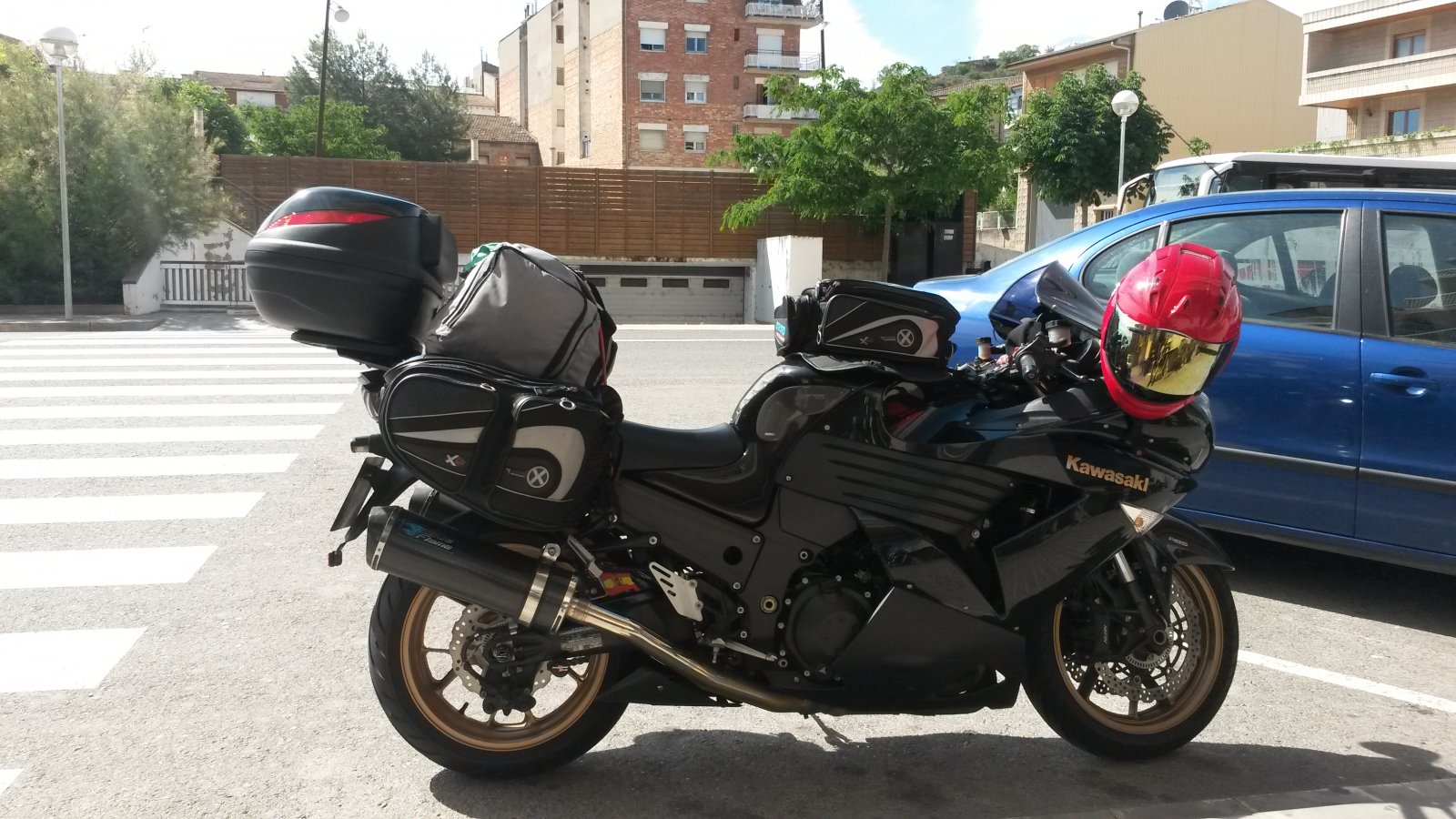

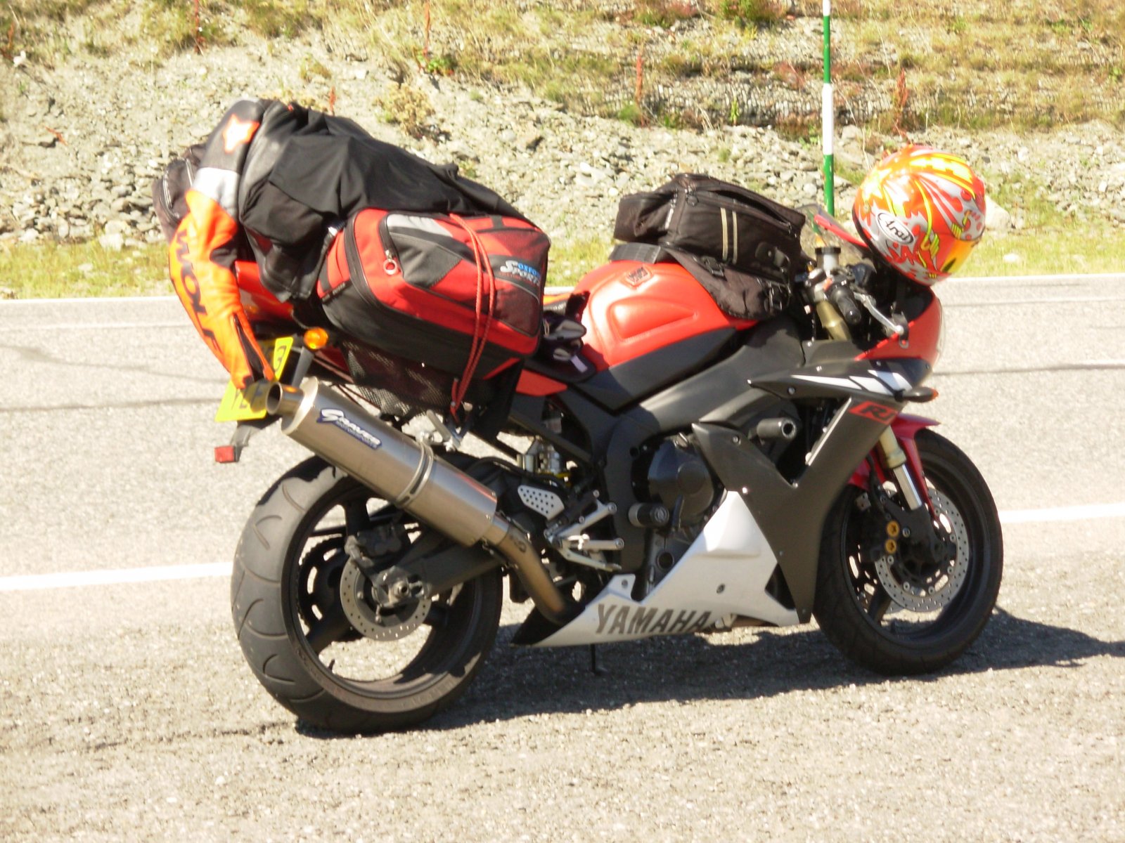

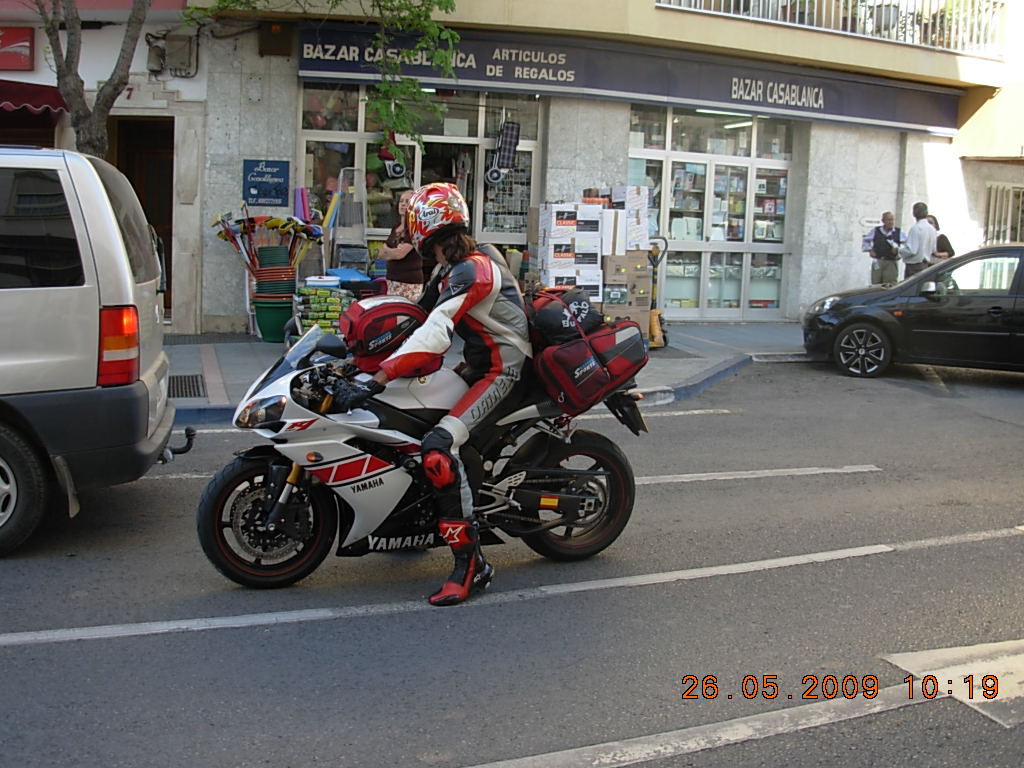

  13. dscn0337.jpg 20150521_105253.jpg DSCN1238.JPG 20150912_102846.jpg Rise and sunny sunshine greetings to you folks and I thought that I'd give you an idea of how I usually saddle up with some pics of trips that I've done over the years, as that's pretty much what's in store for the Panigale... Appreciate most people say it's not the right type of bike for luggage nor perhaps touring but that's how I role... likely my warped sense of humour but funny that panniers aren't really supposed to be put on a Pani-gale! or Pani-R as I call it ;) I haven't double-checked posting rules, but I hope that I'm not breaking any by uploading photos of anything non-Ducati! Go easy on me, the Pani R is my first Ducati, you gotta start somewhere...
  14. Just in case any of you are wondering, the aim of getting myself the pillion seat is thinking ahead to strapping panniers to the Pani R. If I get myself the seat, then might as well get foot pegs too (if they fit) to carry the odd pillion once in a blue moon, although most of this revolves around fitting luggage to my new bike. So... speaking of the pillion seat, apparently a Panigale 1299 seat will fit my Pani R... from the little research I've done myself mixed in with a little conflicting info that I've found on the interweb too!, apparently 899/959/1199/1299 pillion seats are all the same, is that correct?
  15. By looking at the shape of the standard heatshield I would guess the hangers will not fit , if you can wait until next week I will offer one up to my bike and let you know,you may want to look at the sato tie down hanger that bolts where the hangers go, no foot pegs but will offer you a good strapping point or may be look at a multistrada with all that luggage :cool:
  16. Cracking job and let me know how you get on with the hangers when you can, in the meantime I'll check out this Sato hanger that you mentioned ;) I'll keep the more upright tourer option on standby for when my back decides to pack in!
