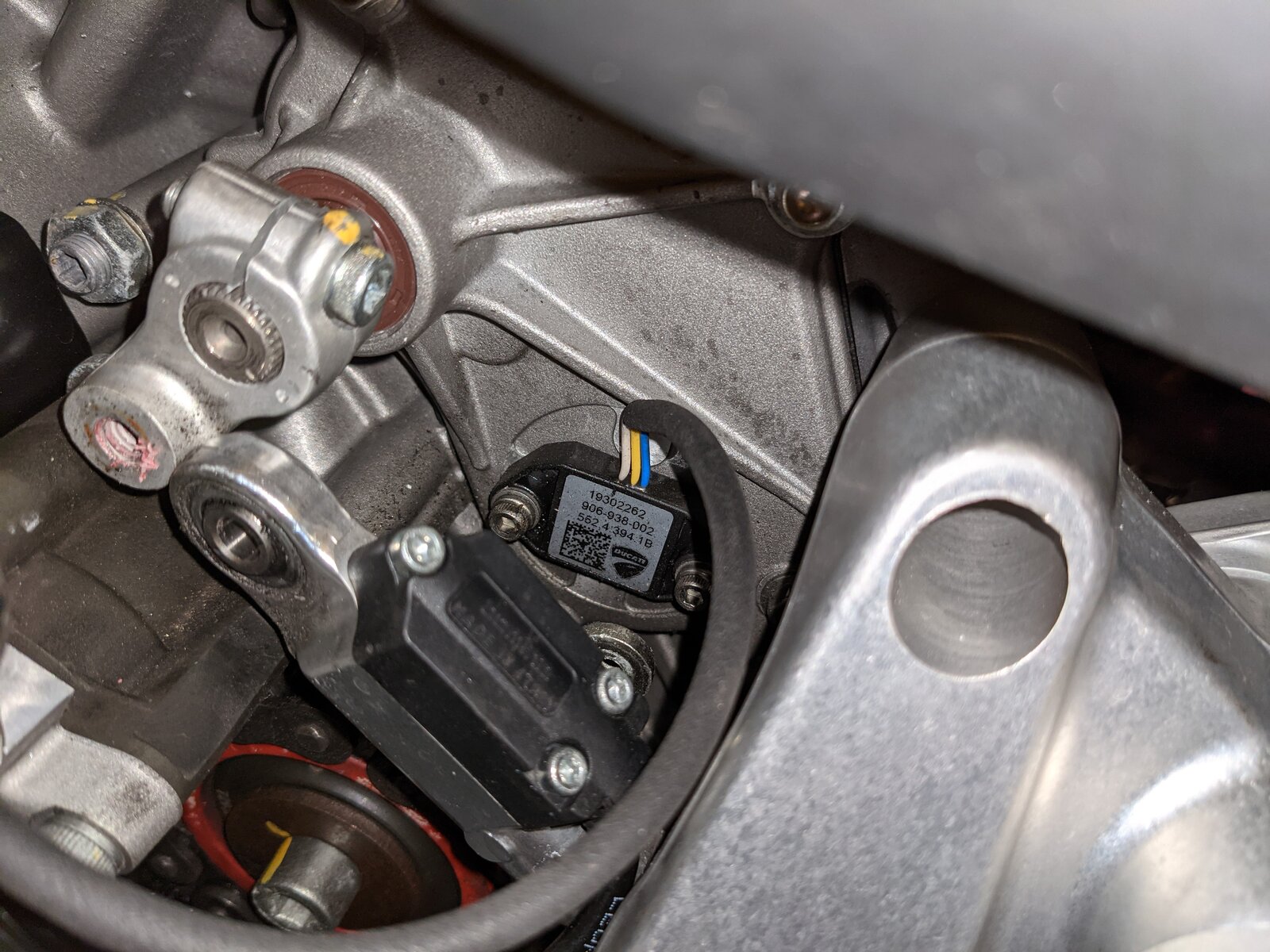

  14. Quick update - Took the front sprocket cover off earlier and found this (sensor with blue, yellow and white wires) looser than a 60 year old hooker. Believe the gear position sensor? If so might be a contributor to my issues. Once I'm out on it next I'll update again, but surprised it was as loose as it was. Considering it wouldn't even be looked at for quite some time if a normal service schedule was followed.
  15. I posted about this very thing on my v2, are they actually loose though or just the covering not very good?
  16. Yeah replied to your post (it's why I took the pic). It wasn't a bit loose, it was like someone had just popped the bolts in a few turns and just forgot to do them up.
