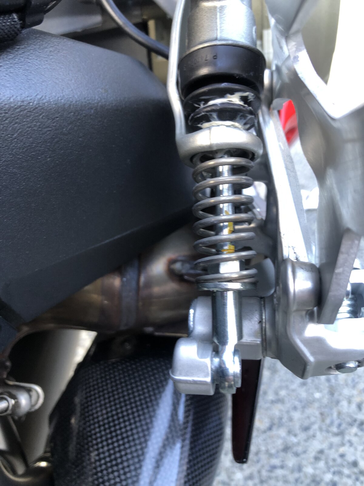

  3. Yep, it usually is just a bolt and lock nut, but my bike has a spring covering the bolt / nut and doesn't seem as straight forward I'd expect.

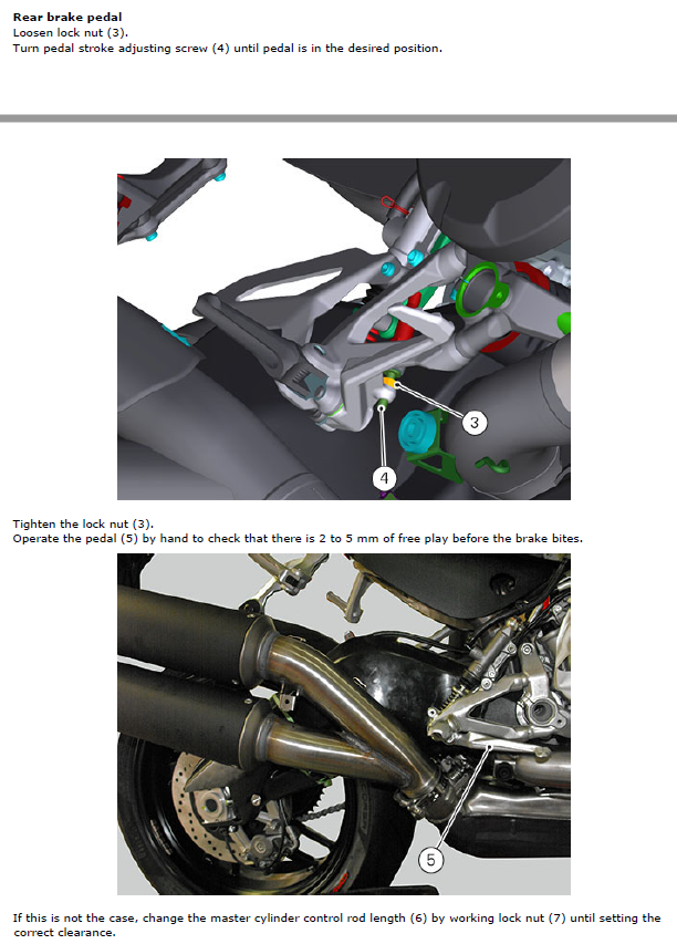

  5. 959 Instructions, but the same
  6. Thanks for sharing. But the V2 isn't the same as 959 pic, I have a large spring covering the the locknut. Its pretty tight, but i'll play around with it. IMG_8913.jpeg

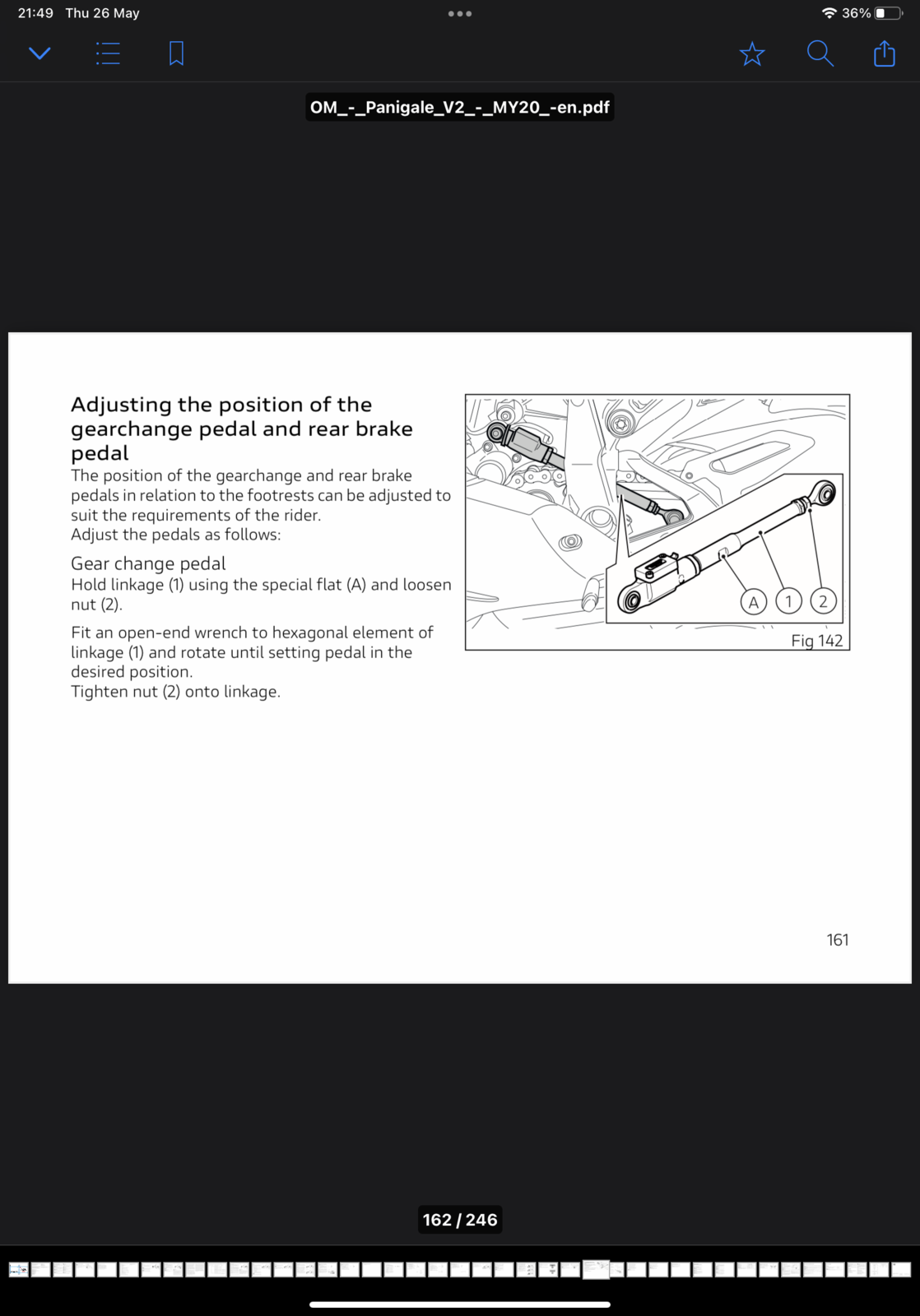

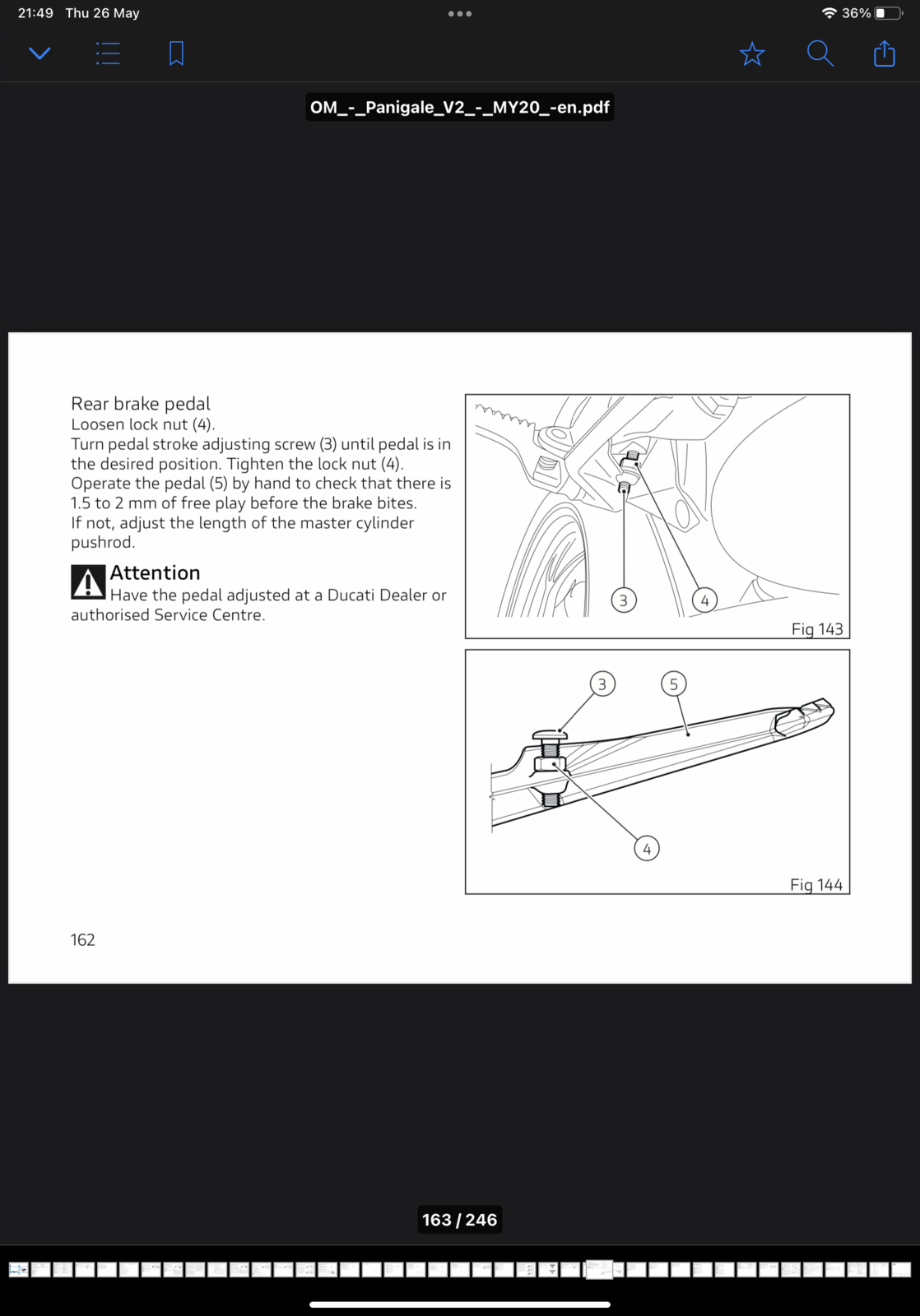

  7. Page 161 of the owners manual details how to do this.

  9. It says in mine to have the dealer do it. But it also says have the dealer adjust the chain too!
    Anyways…here you go.
  10. Basically what I put originally
