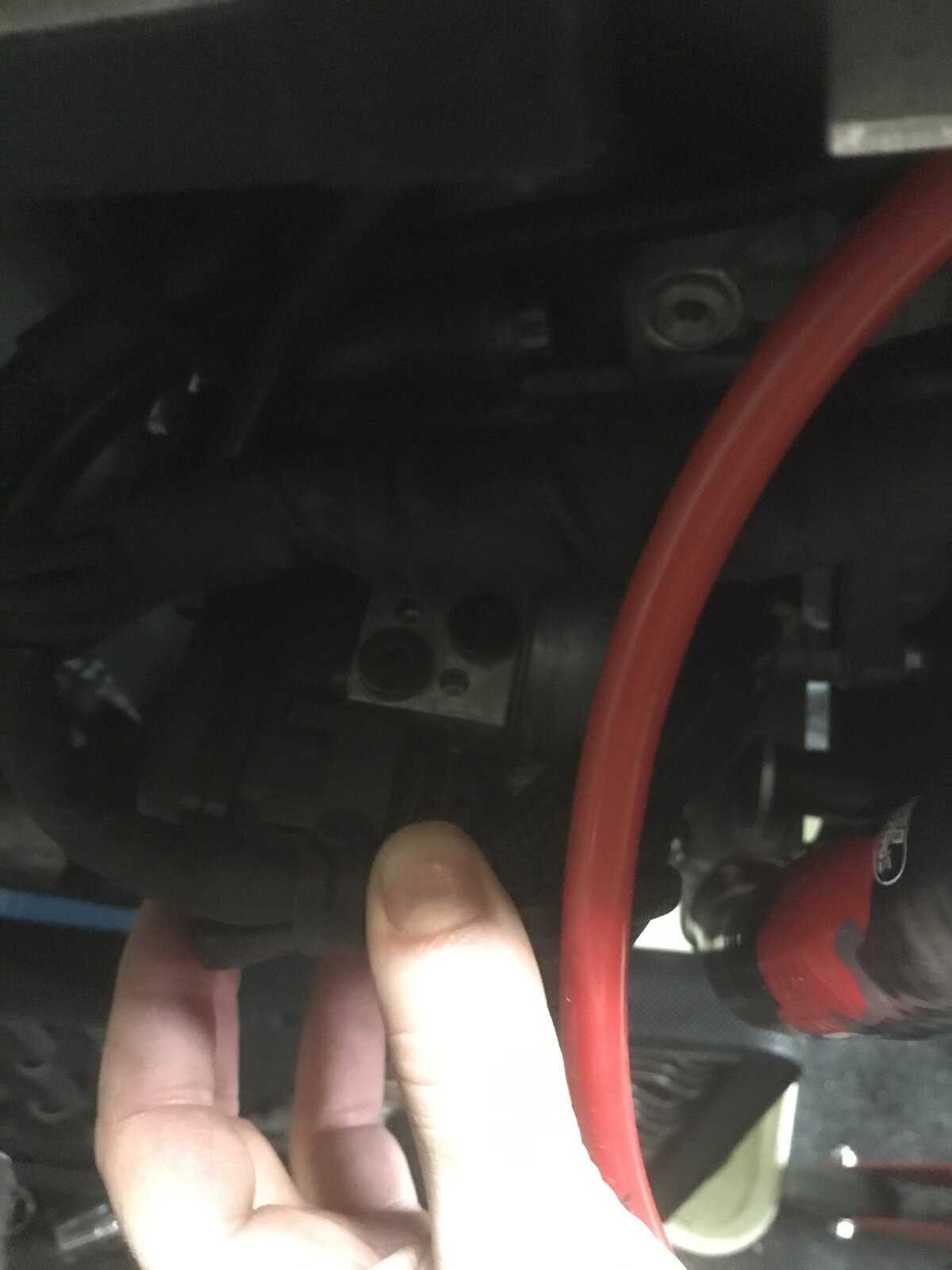

    Currently in the middle of converting the V2 to a track bike which doesn't take much, it's pretty good out the box, but the brakes are a bit rubbish and need to invest in upgrading them!
    I couldn't find this info anywhere, but was wondering if anyone has removed the ABS from the Panigale V2 for track use? And if so, did it make the difference I think it will? I did it on my last bike and it was nearly night and day!!
    I'm going to be upgrading pads and discs, but want to remove the ABS too ideally. I know there is an ABS delete kit for the 959, but not V2 yet.
    Any help/experience here would be greatly appreciated :)
    Thanks
    Jamie

  5. Afternoon,
    I had a 959 and now on V2. I never have ridden with ABS, but brakes with it all removed is pretty good. Brakes are same on 959 to V2.
    kit wise you just need 4 grub screws,
    Locktite and some Hel
    Brake lines. Leave electronics on.
  6. Not best pic but these are the bolts I put in my ABS module
  7. That's brilliant and good news!! Thanks for the reply!
