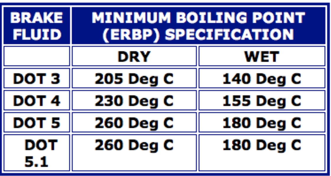

  8. I got a Oberon clutch slave, am replacing the fluid with a better DOT4, and I also wrapped the line in a heat sheath. Will report back soon when the work is done. Also doing a dry clutch conversion at the same time :)
  9. There is absolutely no reason to insulate or put expensive fluid in the clutch hydraulic system. The clutch fluid will not ever see temperatures anywhere close to brake system boiling temperatures. The slave cylinder mounted to the engine casing gets as hot as it can get. Seriously ...

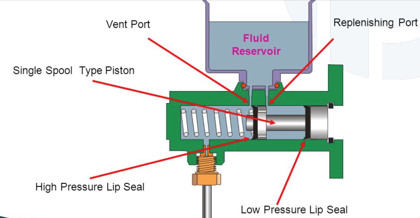

  10. Well it's losing pressure, so might as well take some precautionary measures... Tired of dealing with this.
  11. Either the replenishing port in the master cylinder is plugged or the reservoir cap is not venting properly — preventing the master cylinder from refilling properly.
  12. Agree, no experience on the V4 but the constant hydraulic cavitation problems due to exhaust proximity heat-soak that affect earlier bikes certainly suggests that temperature fluctuation plays every bit as bigger role in the part-failure of clutch line pressure maintenance as it does in the brake lines, certainly on the same bike, and would like to see concrete, specific proof of anything contrary to disprove this.
