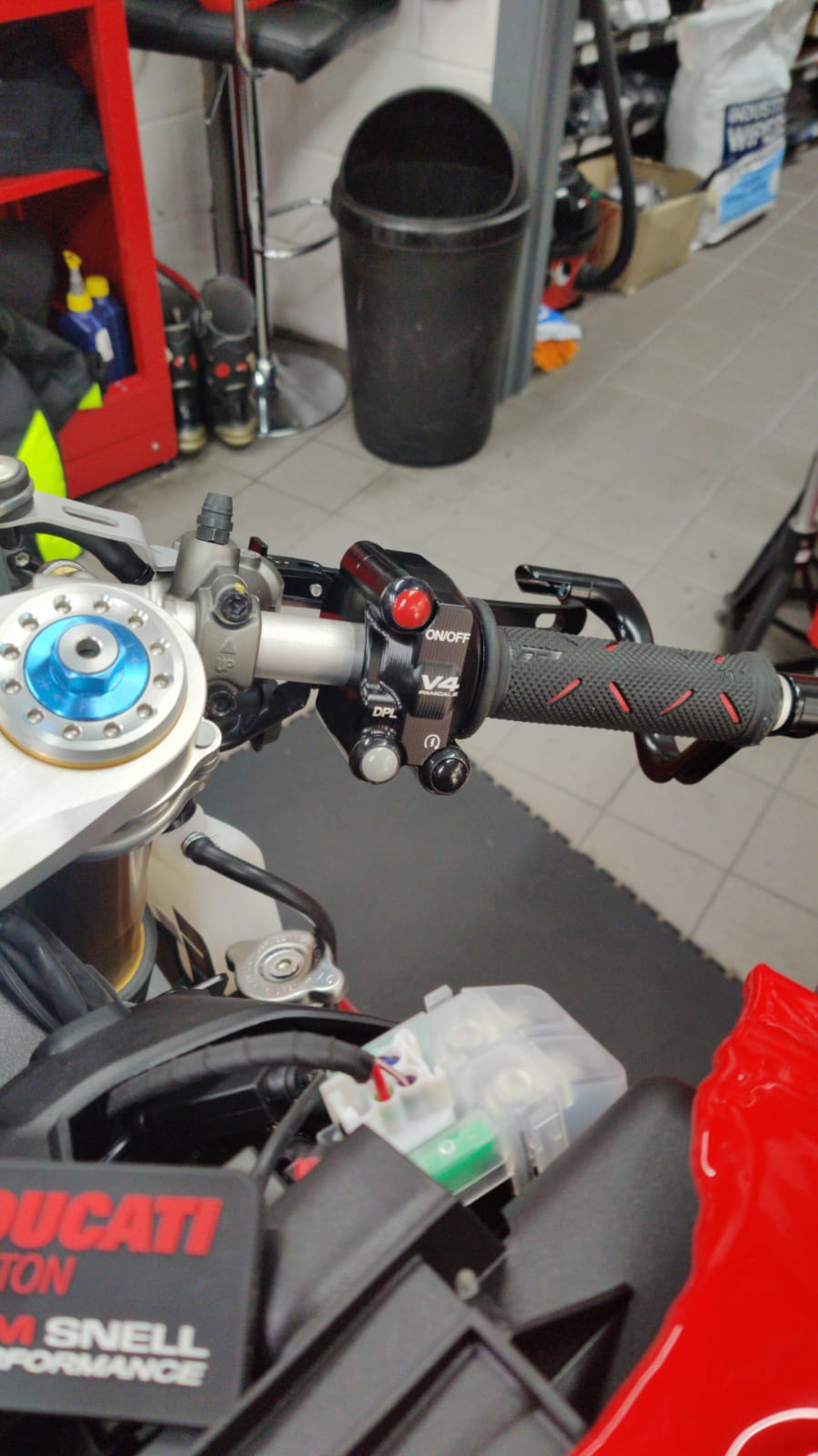

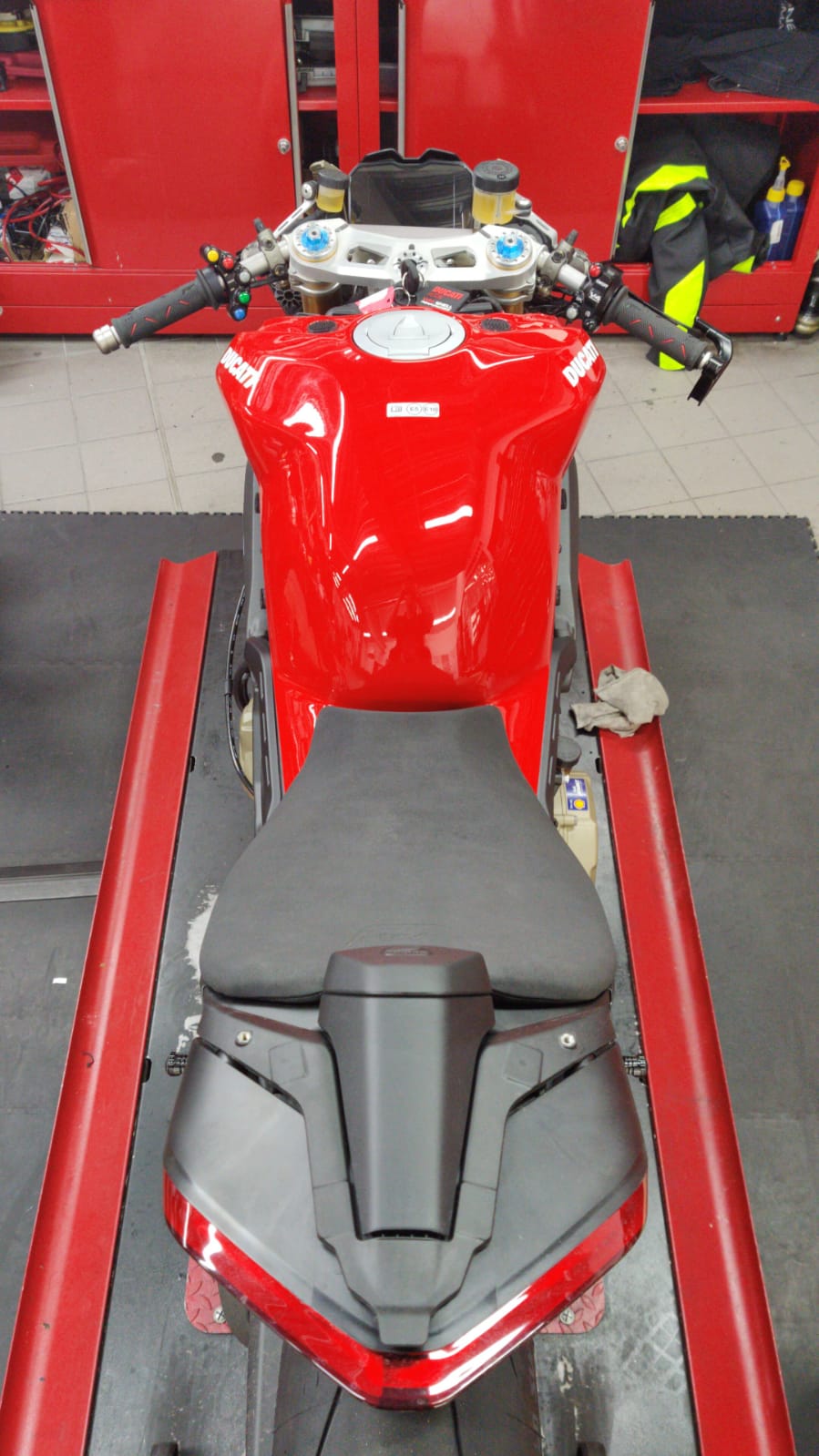

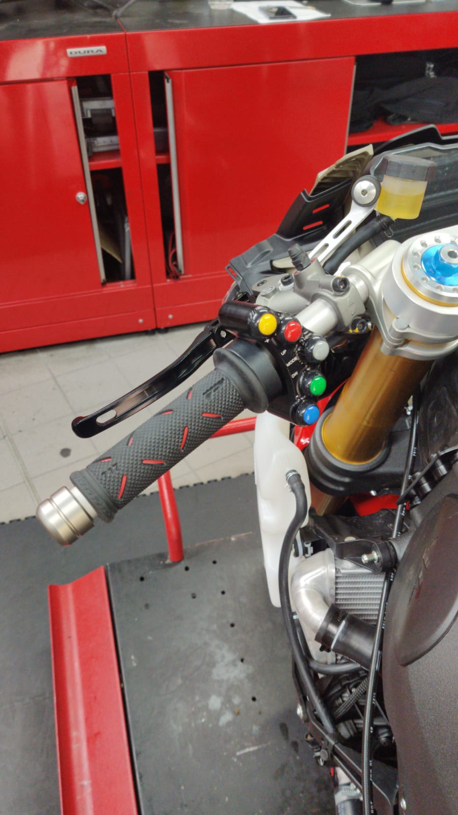

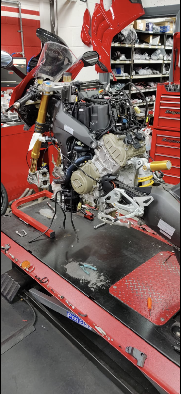

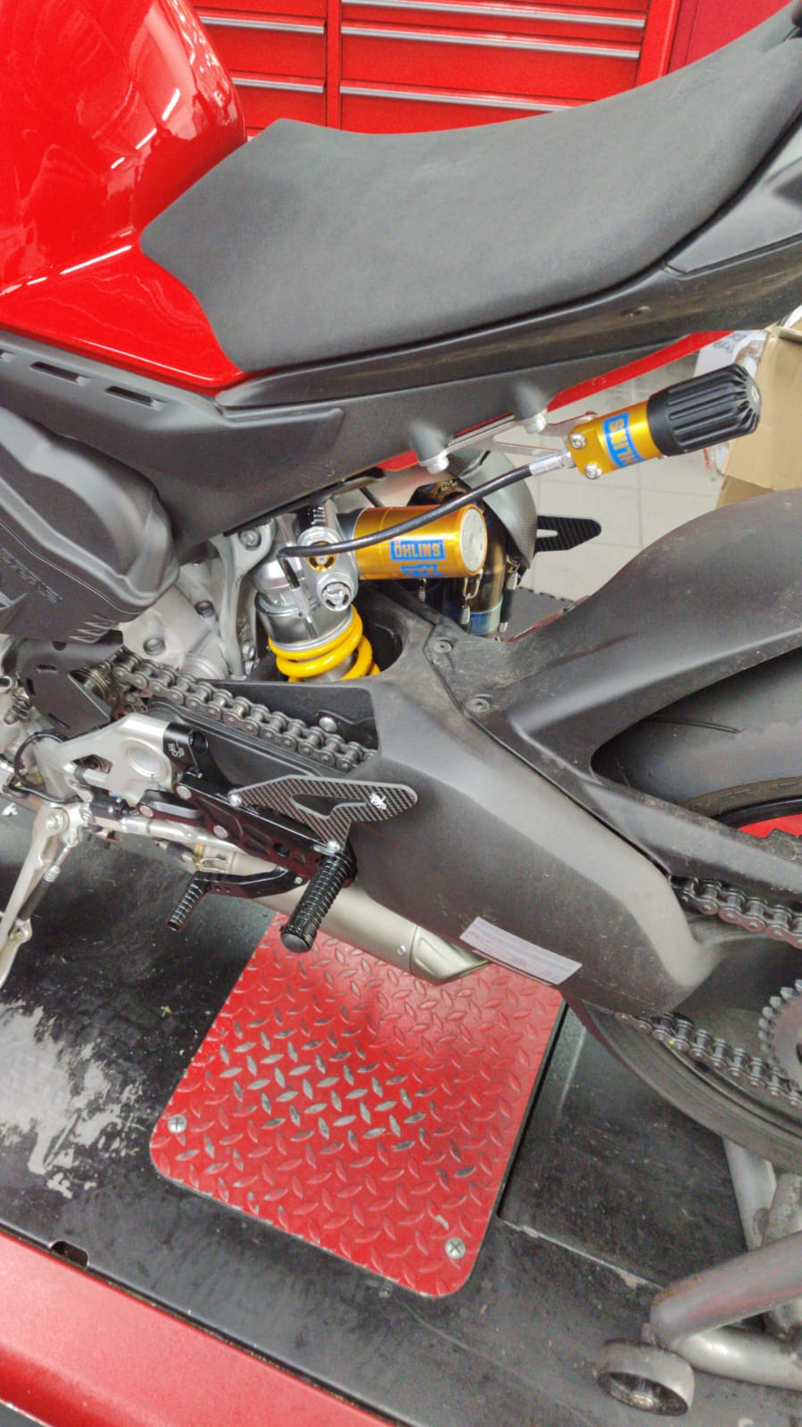

  1. Started the build now Ohlins forks and TTX GP shock fitted
    Full Akrapovic Jetprime switchgear and Spider bits and bobs with Strauss carbon fibre plus Marchesinis and a set of Oz

  4. E5747022-6ACA-4810-8A03-E44DEFDA1BD9.png E5747022-6ACA-4810-8A03-E44DEFDA1BD9.png 222FA7B9-F994-48C4-BFD5-8C619AC08C3A.jpeg 5D872177-BE98-426B-8992-C6B245F9D3FA.jpeg 18805D1E-C45B-4E21-9ABC-A06CE73BAA27.jpeg 28BD2AC3-7F73-4FF4-979B-F48F770C269D.jpeg

  10. What forks did you get specific to replace the std shows or did you need a new bottom yoke?
  11. They are Panigale R forks with reworked internals
  12. Did you use the r bottom yoke or did the forks fit into the std pani yoke?
  13. Fitted straight in
