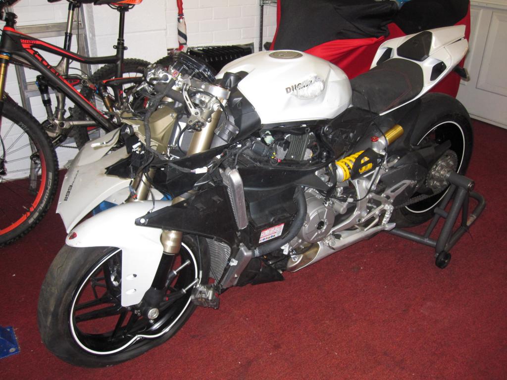

  1. Needed to start for my rebuild. Also need wheel spindle and complete front wheel with or without discs.

    Found today that the abs alloy tubing is crushed, so that will be removed for now as less important to getting bike rideable again.
    Most important first parts are the yokes and a ride height adjuster, then I will be in a position to confirm if wheelbase is right or not.
    If its right, I will carry on, if not I cant afford a new frame, so will have no choice but to part her out.
    Theres those 1098 gold wheels on here I would love, but can't risk buying only to have to sell again if frame is bent.
    Would also love that kit type rad and cooler setup so could get rid of the lower coolers fan setup, but for now, funds won't allow.

  7. Have you priced up the new parts? Lower yoke/steerer is about £330. The wheel will be a bit scary though... If you have a list and need prices, let me know :)

    I've got slingshot on the hunt for widetrack panny race yokes, think MV AGO yokes may fit aswell as they used same model forks I THINK???
    That race febur copy rad setup I really want, but can't do it even at £750 for the whole setup.
    To check frame and wheelbase I need,
    Yokes,
    F/Wheel and Disc/s and Spindle and 1 Spacers,
    Rear Ride height adjuster(got eye on ebay one).
    If Frame and wheelbase is ok, Then need,
    Lower Rad+ fan setup and housing.
    1 Clipon,
    Both Switchgears,
    1 or Both mastercylinders and levers,
    Both rearset pegs, gear lever and brake pedal, OR New race rearsets.
    Rear light setup,
    Rear Subframe Cast bolt on part that light fits to.
    Tank 2 big dents repair and paint or cover dents with kevlar race covers for either side of tank(ebay)
    Seat panel repair and paint or buy race seat panel setup and cut out holes for rear lights.
    1 forks cap.
    System is scuffed and little dent at front, but totally usable if not presentable and will do for now unless a cheap setup comes up.
    Crash covers for both clutch and stator covers.
    Top rad slightly dented, but again totally usable for now.
    Ian.
  9. well, the lower yoke with steering tube is £330. The top yoke is £250 ish.
    wheel is scary........£900 Discs are £270 a piece, spindle is £95 ish. spacers are about £15 a side
    The linkage rod is about £155
    The discs are the same as 1098/1198 so that might widen your search. I'd defo check the forks to. They are all alloy and bend easily. Looked at a salvage bike a few weeks ago and they were both mullered and looking at that wheel, there's been a lot of energy punched into that area.
  10. Ref wheels, I'm thinking buying a pair of 1098-1198 ones gonna be the way forward, then just need spacing kit for front, assume rear will go straight onto panny swingarm??
    Yokes,
    I'm looking into race set ones, discs assume 1098-1198 are the same?? spindle again assume/hope 1098-1198 the same?? Linkage rod would be either used on if I win it or for price of new would prefer a nicer looking sato one :)
    If I don't get a used set of yokes in next few weeks will have to go for new :(
    Thanks for the prices buddy.
    Out of interest for future costs I might incure, whats the cost of a new subframe cast rear mount part, the one that bolts onto the rear end of the main subframe please?
    I'm hoping the lower yoke cracking down the centre took away most of the crash hit/shock from the frame??
  11. Rear wheel will go straight in. Front with spacers could work. Tbh, wouldn't be my favoured route, but would free more options up. Front axle is defo different. The Pani forks are wider spaced hence need longer axle. That's one thing I wouldn't compromise on.
    discs are same as 1098/1198 so no problem there. Don't forget they are handed ;)
    Lower yoke/steering tube is available, top yoke is showing as back order. I'll take a look at rear subframe tomorrow for you.
    Like I mentioned....get the forks out and check them. They do bend easily.
    Ref the rads....the lower one isn't that pricey. If the upper is in one piece, you may not need spend a lot. Cooling is critical on the Pani. It makes a lot of heat and quickly when stood still.
