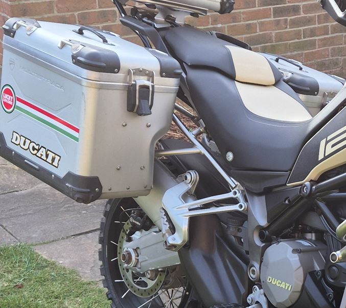

My 1260 Enduro came with a set of Aluminium Panniers which I've not really used yet, preferring to just pop the topbox on for what I've needed since I brought it. I'm planning some longer overnight trips shortly and will need the Panniers. The Right Hand side one is one of those that has a cut out over the exhaust, and there is a small heatshield fitted. It's a simple question really, should I be at all concerned about what I pack in that Pannier towards the bottom with respect to heat from the exhaust? Does it get hot in there? Is it likely to damage my tent, sleeping bag etc? Just wondering if anyone can shed any light from direct experience. Thanks

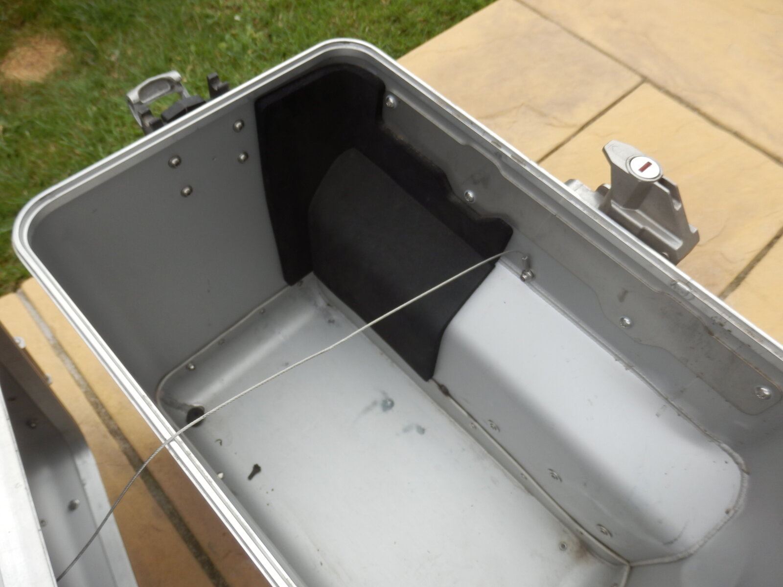

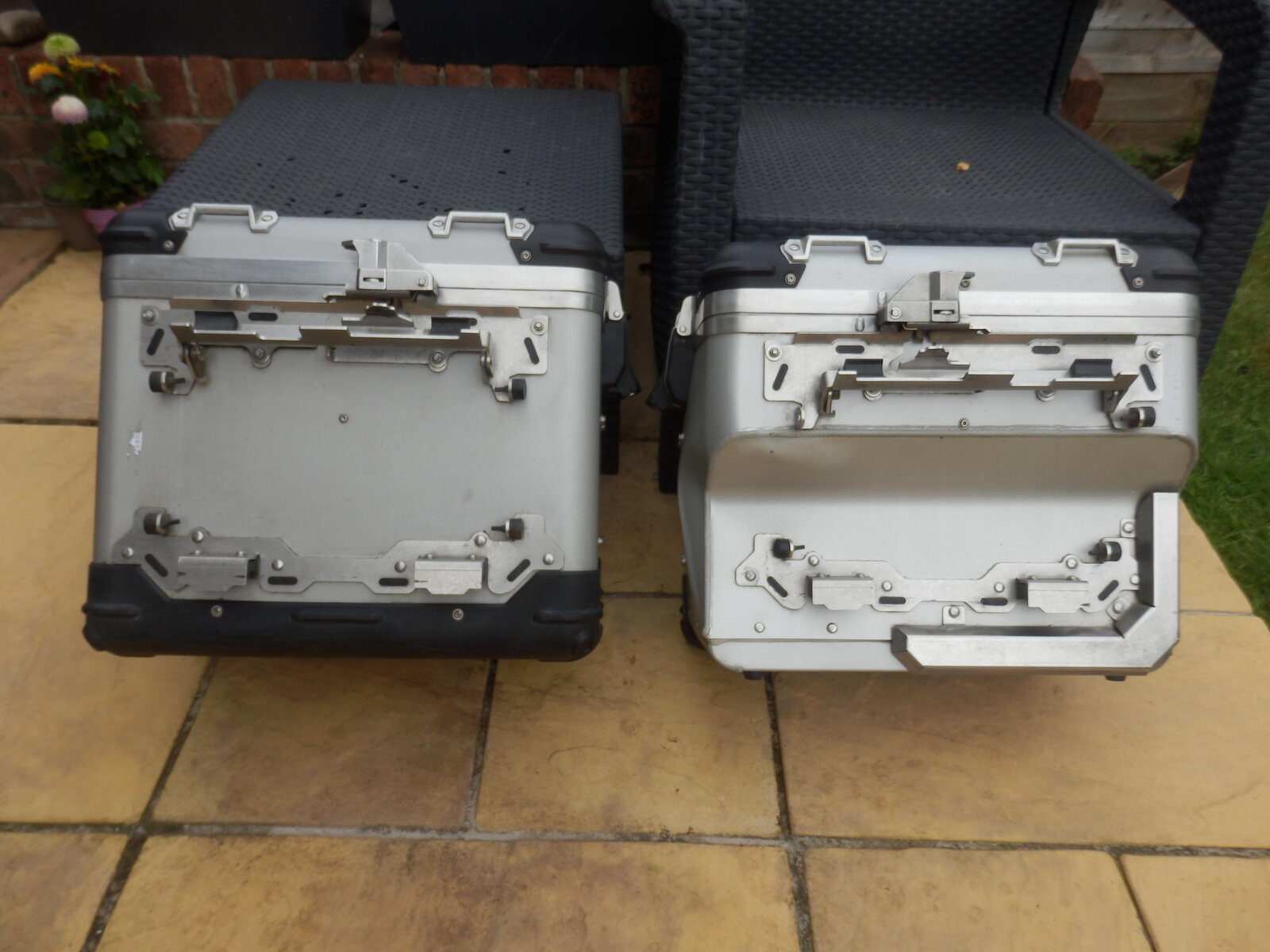

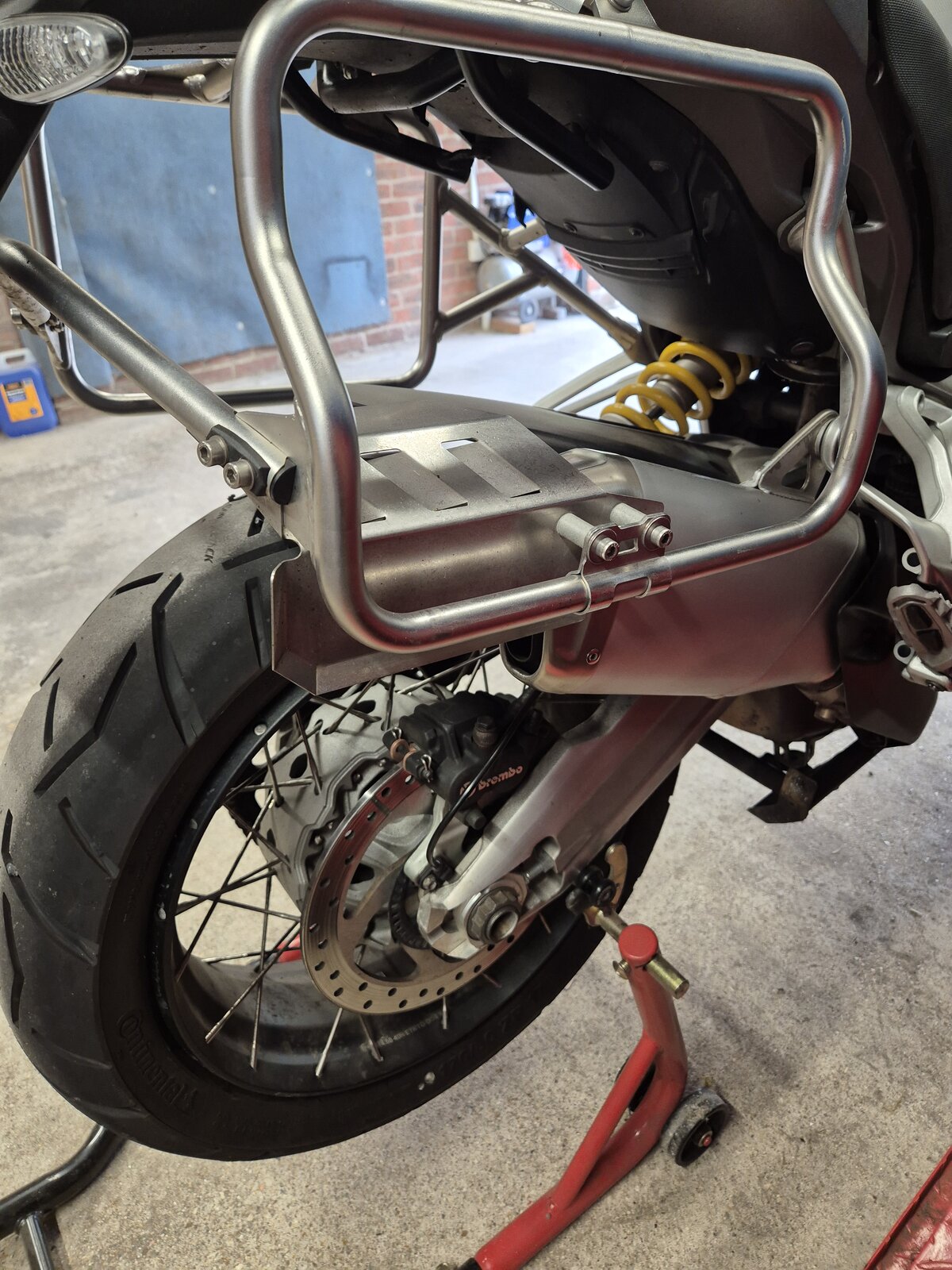

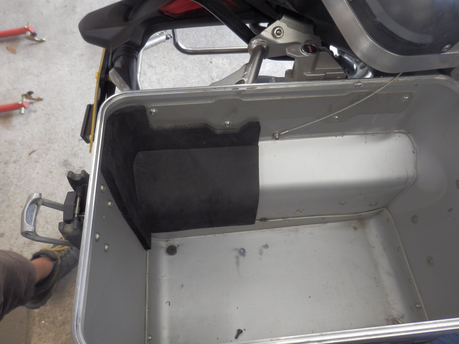

There is a difference between the Left hand and right hand panniers. The right hand one does have an additional 'L' shaped bit of tinware riveted to the outside as a heat shield: And on the inside there is some Neoprene rubber: On the bike both would appear to be in exactly the right place to reduce any heat build up, but I think I'll try sticking some heat shield material on the outside of the pannier on the curved surface inside the exhaust cut-out.:
