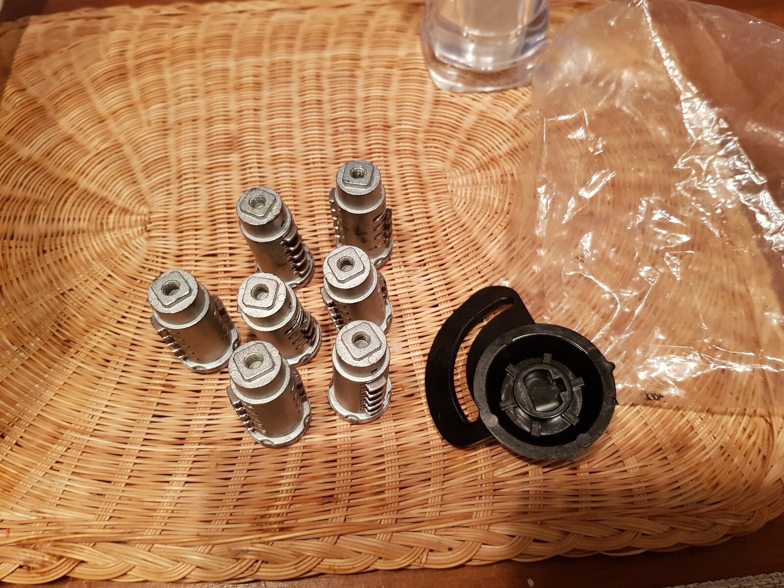

    I have recently bought a new set of plastic panniers for my 1200 enduro (same as the DVT & 1260 ones, as I don't like the look of the metal boxes) .
    Having stripped the lock mechanism the locks that came with my bike don't fit. The end of the lock is square and the mechanism plate has an oval hole.
    Anyone got any clues ?
    Have the panniers mechanisms changed or something ?
    Cheers

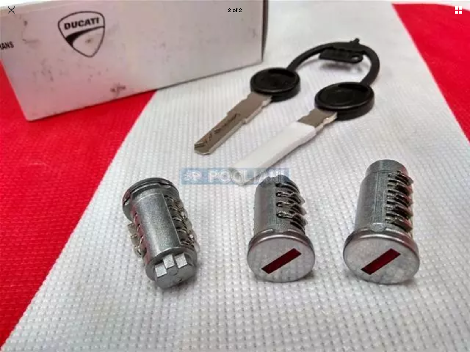

  4. 79EE3A7A-1687-4598-BA75-3DEFB87C9BE3.png I bought these. This pic is from eBay so I can’t 100% guarantee it’s correct. However I ordered from this Italian dealer and they were on my doorstep within 3-4 days. Half the UK price.
    As you can see the end is not square as in your pic.
    They slipped perfectly into the plastic Multi panniers.
    The eBay link has expired but the dealer was Pogliani
    Or look them up on eBay.
    seller:shop.pogliani
    You normally get a set of 3 barrels, how come you’ve got 7... wrong ones?
    Come to think of it, those locks must befor the metal cases.

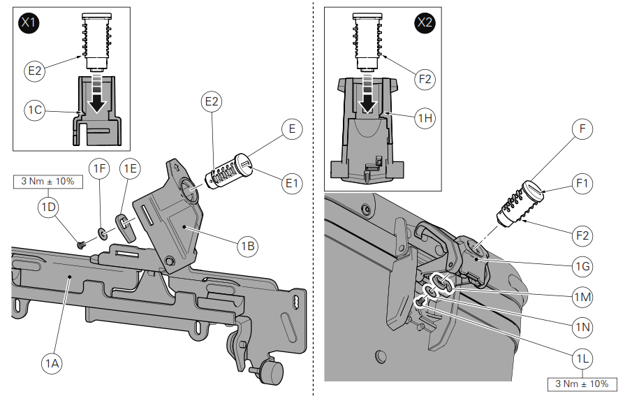

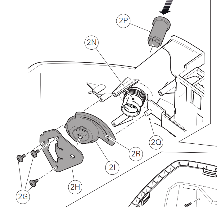

  5. @John W - looking at various manuals for the panniers, top case and even the under seat lock, it appears that the lock changed (at least on the panniers) from the square boss end to the shape shown in the photo above from @Sam1199 and that shown in the 2015 pannier accessory manual.
    All the pictures I've found for the 2010-2014 (pre-DVT) panniers (different lock mechanism), the top case and the under seat locks show the square end.
    I found the accessory manual for the Enduro metal panniers - they use the square boss lock barrels

    I think the locks are provided for the metal cases (2 per case) which is why there are so many.
  7. pannier supplier have confirmed they have encountered this before, and despite it not being mentioned anywhere, fitting plastic cases to an enduro requires a new lock set :(

    Now off to the bay to buy a set. Thanks for the heads up on the price difference Sam1199. Interestingly (or maybe not :p) if you look at your picture I reckon two of your locks have the oval end and the other (the one on the right of the picture) will have the square end with threaded hole in it.
