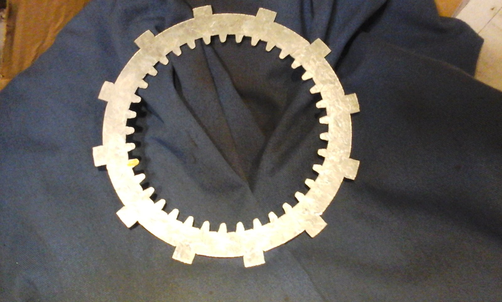

    let me get back to you with all the sizes i have for the wet clutch, bottom line is is the wet clutch hub same as the dry clutch hub on say a 750/ 900 monster 1989 same no off drive teeth but 10 tangs or 12 tangs on the drive plate here is a clutch mock up plate can you tell me is it the wet clutch ref the 10/12 tangs and no of inner teeth for the clutch hub will post the sizes later
    plain plates are 137.00 mm out side
    inner drive plates are 104.00mm inside that is the hub

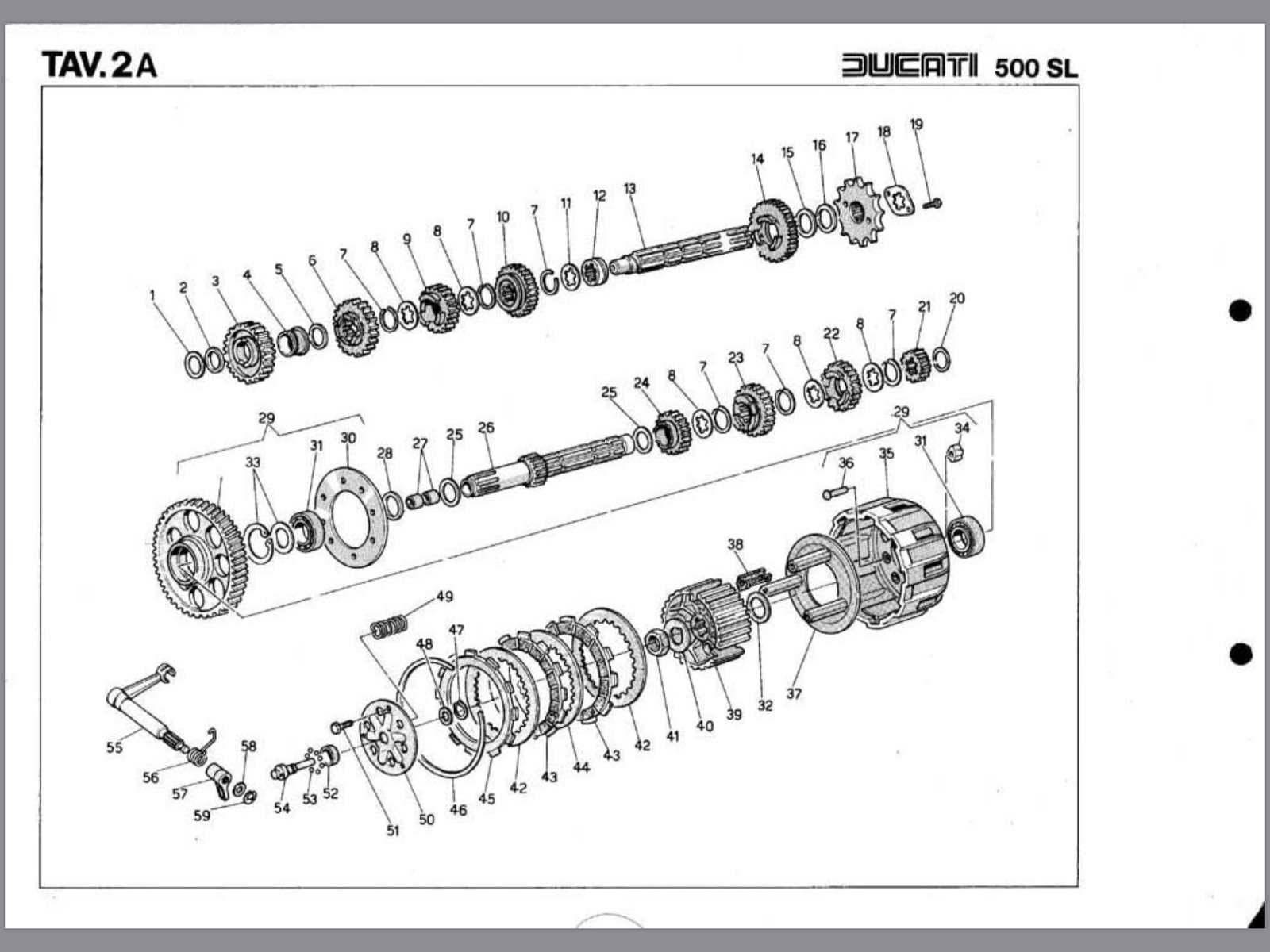

  7. good morning all
    here is the 500 500 sl ducati clutch.png sl clutch can any one help
    mike

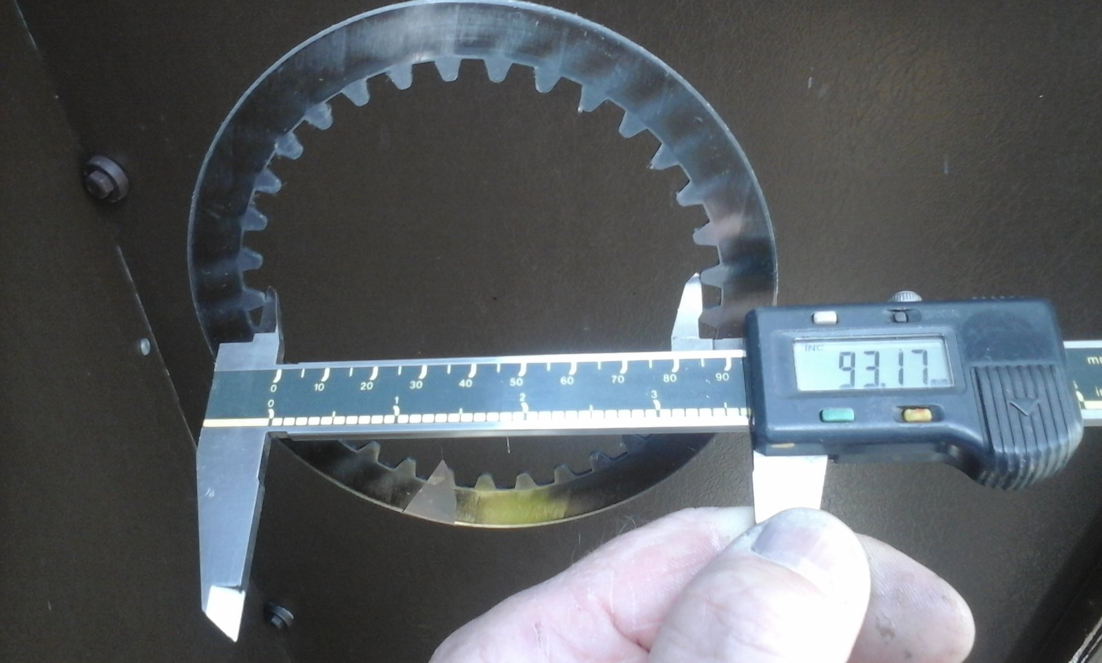

  8. @michael shannon

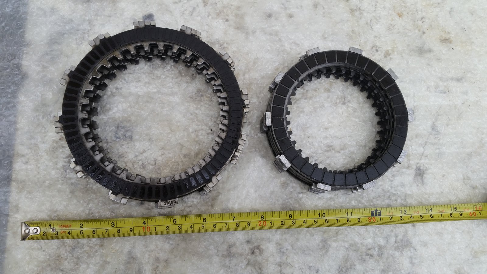

    This is a photo I have just taken of two wet clutch plate stacks, for a 500 Pantah on the right and for a 600/650 Pantah on the left. I have measured them (not high precision just with a tape measure). Hope this is some help to you - if not please ask again.
    500 (1979-80)
    Plain plates:
    Internal diameter = 94 mm (inside the teeth)
    External diameter = 124 mm
    No of teeth = 33
    Lined plates:
    Internal diameter = 100 mm
    External diameter = 124 mm (inside the ears)
    External diameter = 135 mm (outside the ears)
    No of ears = 10
    Width of each ear = 12 mm
    600/650 (1981 on)
    Plain plates:
    Internal diameter = 110 mm (inside the teeth)
    External diameter = 146 mm
    No of teeth = 30
    Lined plates:
    Internal diameter = 124 mm
    External diameter = 146 mm (inside the ears)
    External diameter = 158 mm (outside the ears)
    No of ears = 12
    Width of each ear = 14 mm
  9. hello pete 1950

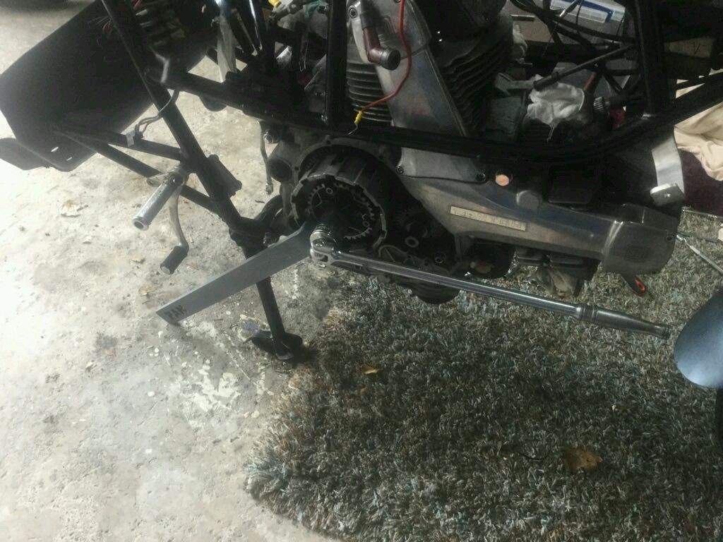

    thank you for all that information and a great help to me as i work for my self i made 6 no lock tools but was given wrong info now back to the drawing board
    mike
  10. pantha wet clutch no3a.jpg hello pete 1950
    here it is thank you for your help the 500cc clutch
    mike
  11. good morning all
    all sorted 500cc clutch tool many thanks to pete 1950 , derek
    mike
