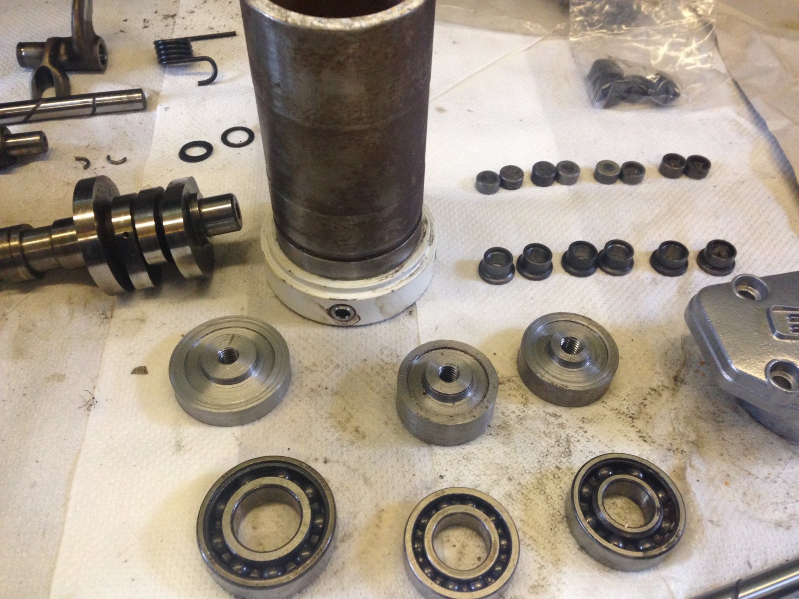

    Anyway, decided to make some decent drifts for the bearings as sockets don't always locate nicely on to the outer race whilst you hammer away. I also made one for the big end with an odd bit of scrap I had in the scrap bin (see photo).
    If anyone near me needs to borrow them then please let me know. (give me a couple of weeks though - not all bearings in yet!)
    I had some years ago purchased some NOS big end bearings which wil save me a few quid. Image my surprise when one side appeared to be significantly too small - what the f**k had I purchased. Penny dropped when I realised the two bearings are different sizes. I had two of the same size -doh!!
    Hay hoe that's another £80 to the total cost!

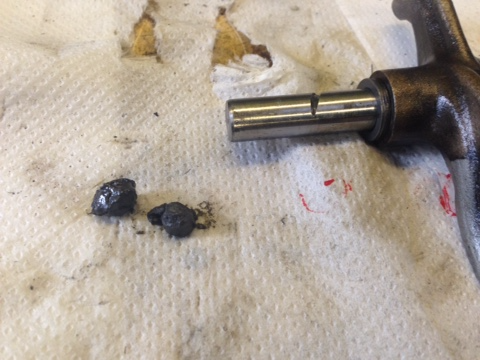

    Also had a chance to check out the 650 crank I purchased on ebay. Looking good. Took out all the crank plugs to ensure it was all clean. If you look at photo 2 you will see the thick dense 'plug' of compressed crud that accumulates in crank plug due to centripetal forces acting on the heavy bits floating in the oil. Not easy to see if there was much more space for more crud but pleased I got it out!
    Hopefully should be putting the crankcases together next weekend. View attachment 63334
