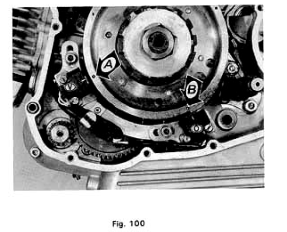

    See that the lines at the centre of each pick up aligns with its corresponding dot on the flywheel and adjust as necessary.

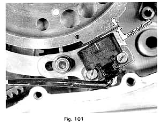

    The gap between the pickups and bump on the flywheel should be 0.35-0.40mm.

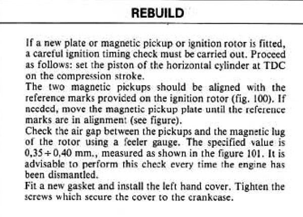

    Excerpt from manual:

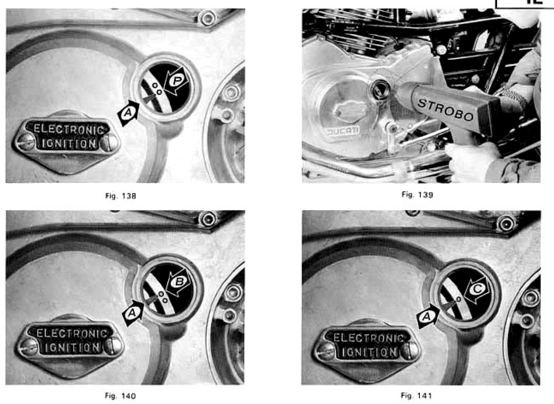

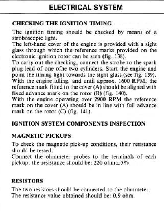

    The Timing can be checked using a strobe.
    Screen Shot 2020-06-26 at 08.47.08.png Screen Shot 2020-06-26 at 08.46.53.png

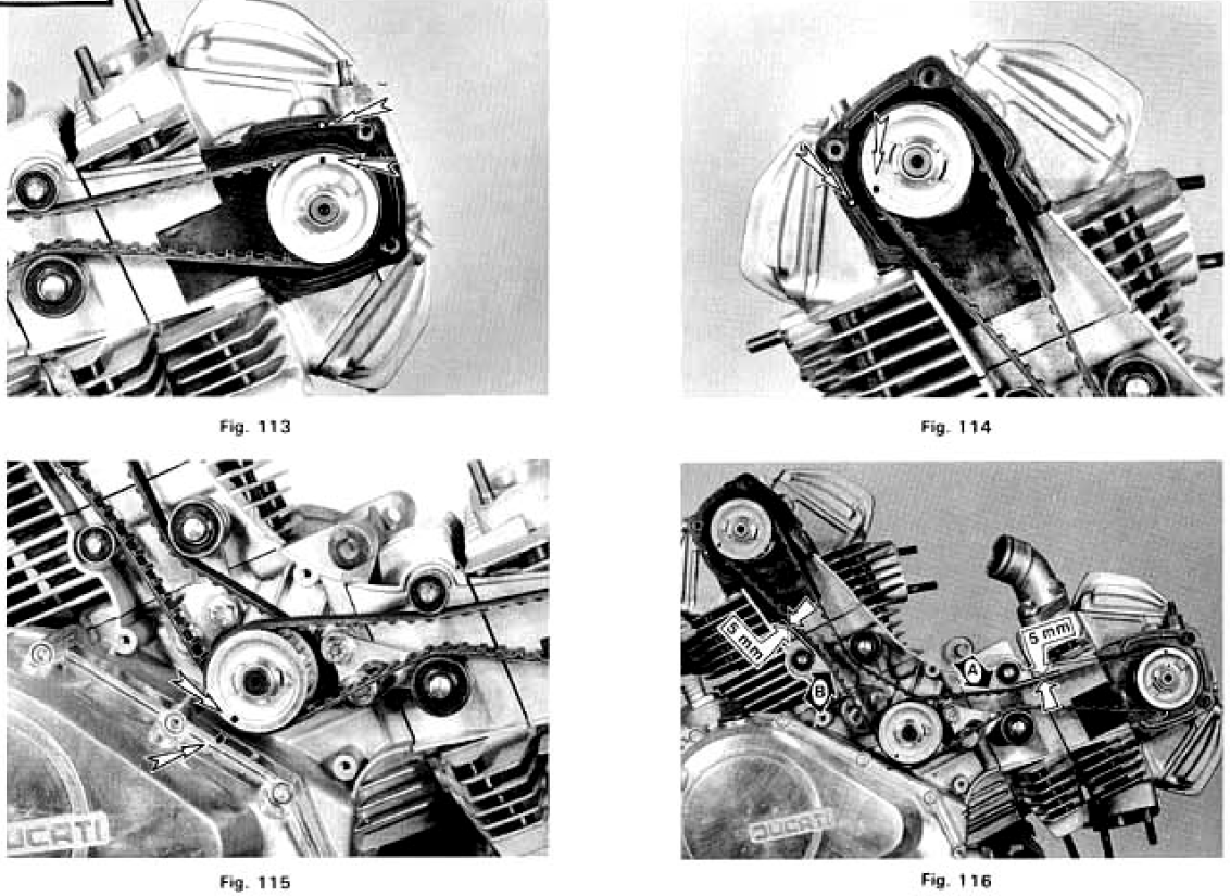

  7. When the dot on the lower pulley aligns with the line on the RH engine cover the horizontal cylinder is at TDC at the beginning of the firing stroke and the vertical is halfway down the inlet stroke with the inlet valve fully open.
    This is the timing position where the engine should be when fitting the belts and all the dots are lined up.
    This sets the cam timing, it has no bearing on the spark timing. Get it wrong and you risk bent valves or worse.
