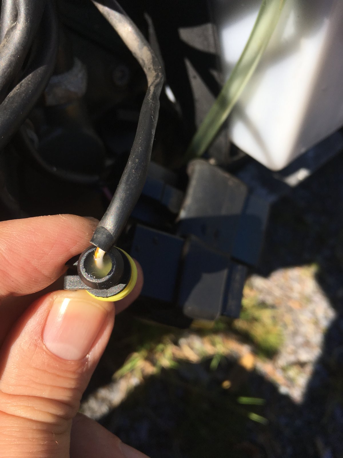

  6. Oil pressure switch. I already had an instance where the ‘vis speciale’ wasnt the right part number. Basically the sheer bolt on the mirror fixing to the fairing sub frame. If I need to order another oil pressure switch, as I suspect mine is syspect. I want to make sure it’s the right fit as I hear later ones are a different length.

  8. They’re all the same. If you’re running a very early pressure switch, with a spade terminal (doubtful on a 99) it will supercede to the later plastic type anyhow. No change in thread pitch.
    Mirror screw is the same across all years from 94 until 2002 on the 998. Changed for 749/999 though
    Thanks Nelly, it’s what I think you refer to as the plastic type of connector. There’s a picture of it here, full of water, which is what I thought may have been the problem but it’s not. As soon as I get an oil pressure gauge I’ll check it out. Thanks again for your advice.
