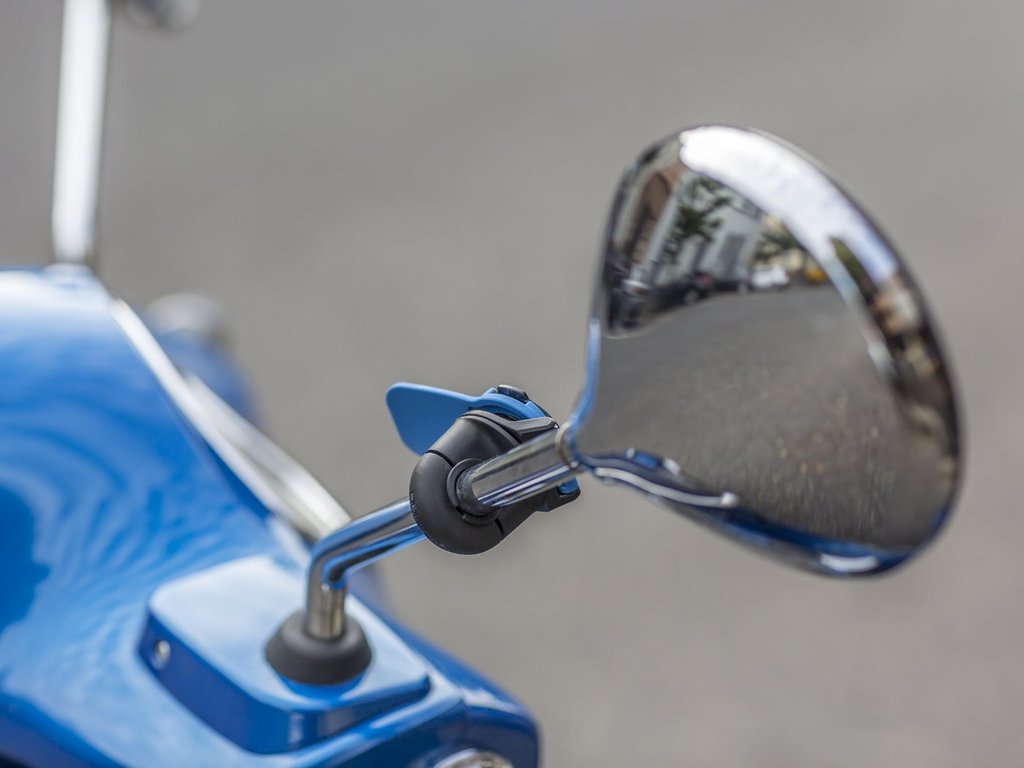

    Here is my way using different items (with links, UK), tested for about 300miles in torrential rain and all types of road riding. A solid solution!
    1. Givi bar FB740: This sits right behind the windscreen (people who use washers this is a more functional way to push the windcreen forward a little, MAYBE?)
    https://www.ebay.co.uk/itm/DUCATI-M...c:g:GZ0AAOSwNg9alMQa:rk:1:pf:1&frcectupt=true
    2. Quadlock system: I used the mirror mount as it can clamp around securely around diameters ranging from 10, 12 and 14mm. There are rubber sleeves in the kit that you can alter. For the GIVI bar I think I used 12mm adapter. The clamp screws have thread lock on them already so wont budge or come loose with vibration. I also got the Quadlock case for my NOTE 9. You can adapt what case of fiittings as per your phone from their website.
    https://www.quadlockcase.co.uk/collections/shop-moto
    NOTE: If your phone is not waterproof quadlock gives you an option of a transparent poncho which fits on top of the phone and weather proofs it. The note 9 is waterproof so didnt need this!

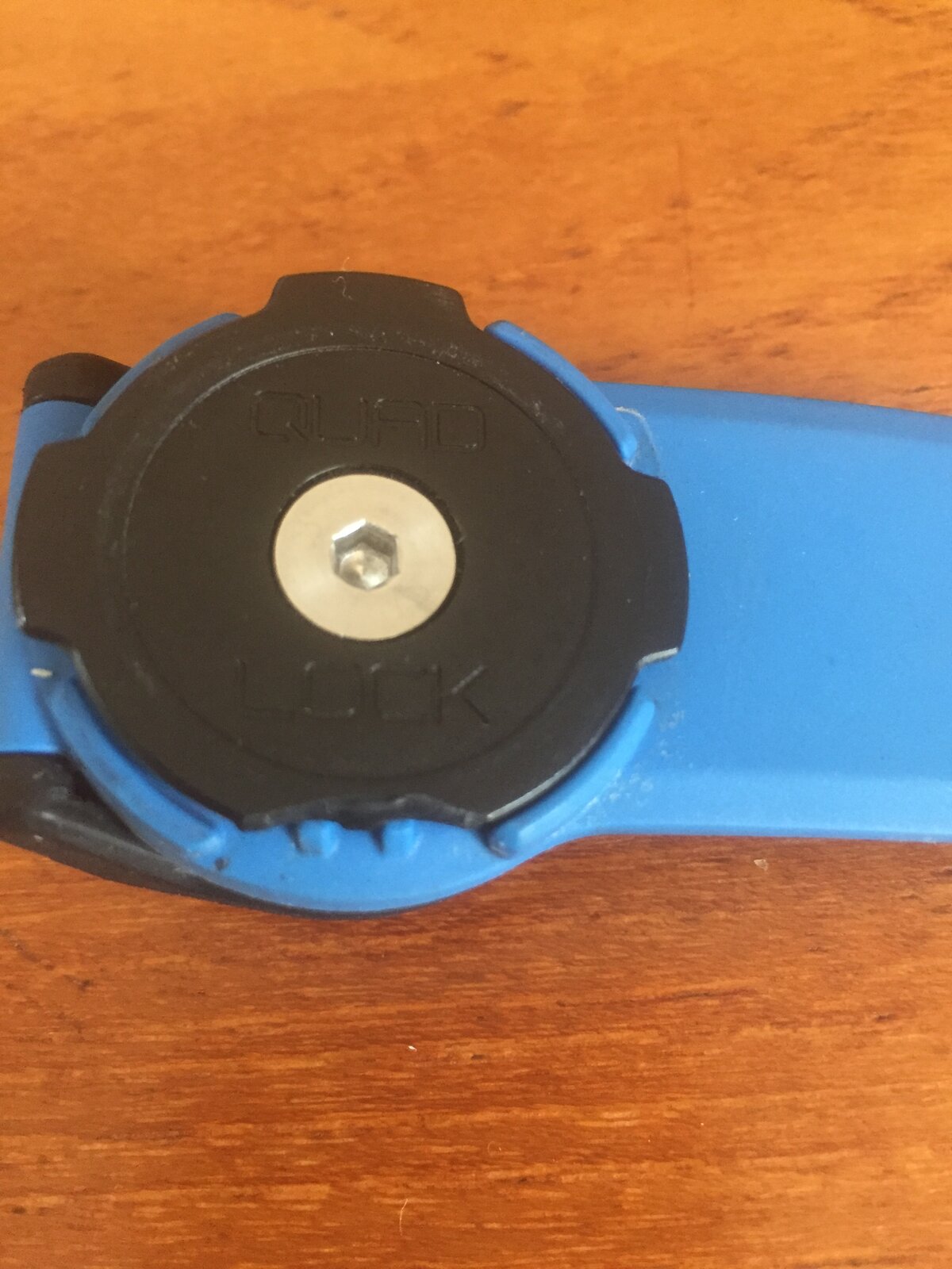

  2. I'm a quad lock user too.
    I did find that after a while, I started experiencing excess rotational movement (probably the rough roads round here). A few emails to them and they sent me a modified plate which just replaced the normal one. It has an extra rubber surface to stop further movement. It's worth emailing and getting if you notice excess movement.

    This is an EXAMPLE of how mine fits on to the givi bar.

  5. Exactly the same. Mirror mount on an accessory bar.
    It took a few weeks of riding for it to happen and I had to send videos and things to quad lock (who were brilliant).
    Basically, I ended up having about 2-3mm of rotational movement which became a vicious circle and got worse. I tried a new case they sent and the new case did the same in a short time. The modified mount plate works a treat and they sent me a.couole to try and give feedback on (must be thinking of rolling them out)

  13. Rubber adaption solved it for me. I'm sure I'd a few people started to email them, they'd just start selling the adapted plates.
    They sent me two
  14. which bit is rubber?
  15. Orange ring in this crude pic... They have basically got a protruding rubber ring that stops movement. No doubt the rubber will eventually wear down, but it has lasted me a good few thousand miles and I have another ready. It is as simple as undoing the bolt and replacing the black bit.
  16. That's a quick fix to a known problem if you ask me, but will mail them about my movement
  17. It took a month or so after my initial reports/videos/pics, for them to knock them up and ship them to me. Was quite impressed they went to those lengths. You'll need a new case too as the movement is actually caused by the receiver openings widening (mine looked visibly hooked).
