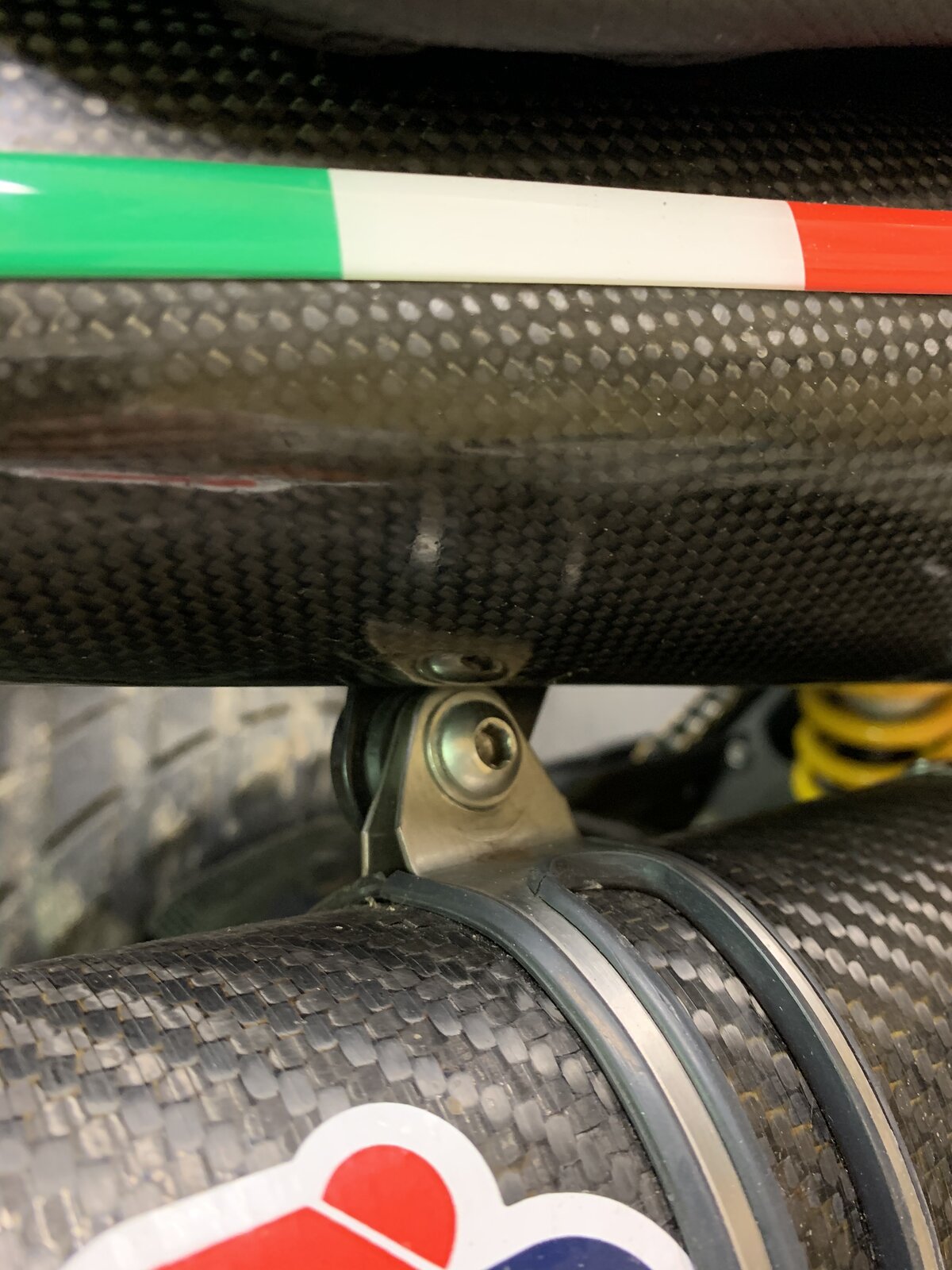

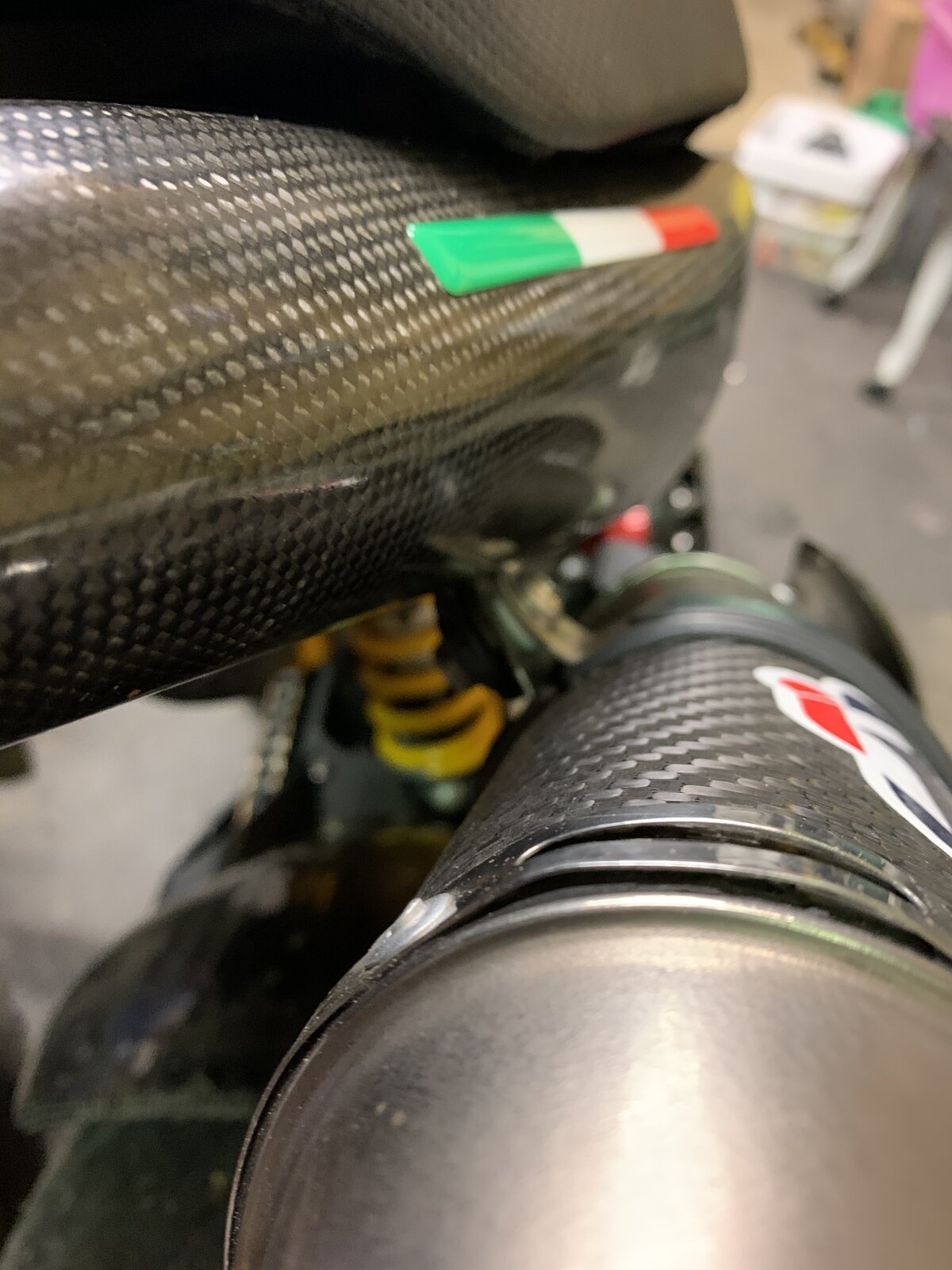

  1. As title guys. My end can if you look from the rear is mounted pissed. Is there another bracket that I’m missing? It was like it when I got the bike but it just doesn’t look right.
  2. Mine is the exact same, drove me crazy initially after I first noticed it however you'll eventually forget about it. I managed to make the muffler sit a tad bit more vertical by giving loosening the clamp and twisting the muffler around a tiny bit.
  3. I was aware it wasn’t straight. But I went round a friend of mines today and he pointed it out. When it bothers me I kind of think it maybe my ocd obsession over my hyper. But when an outsider comments then it becomes a mission lol
  4. That would bug me too. Spacing it away from the bike with a longer bolt and spacer would help along with reshaping the bracket. I took the end can off my 939 as soon as I got it home to make it to sit better.

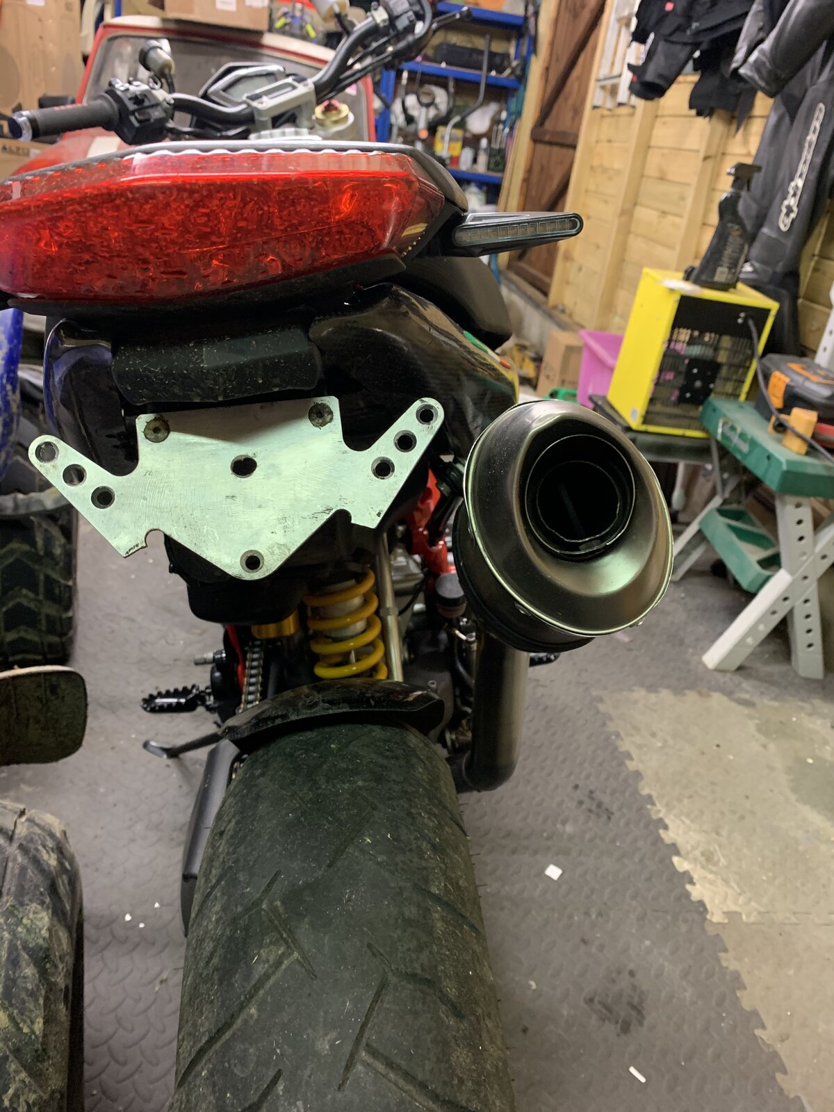

  8. The stock termi 2-1 system originally came with a different plate holder + indicator bracket. The indicator bracket relocated the indicators up to the tail piece like seen on the pic above from Felstmeister (although I'm not sure what plate holder he has installed). I made a custom plate holder as the termi one stuck out too much for my liking, here's a link to the thread about it if you're interested: https://www.ducatiforum.co.uk/threads/diy-tail-tidy-for-single-exhaust-setup-1st-gen.64219/
  9. Number9. I couldn’t tell u the make as it was on the bike when I got it. But my end can is cut down. The indicators I mounted myself as I had it mot’d today. I even got a 9”x 7” plate on without fouling the end can
  10. Thanks mate, that's really helpful. Do you still have the different plate holder that the 2-1 system came with? U.S. plates are a lot smaller than UK ones...
  11. Yes I still have the different plate holder hidden away somewhere along with the indicator mount too. I had to make a new indicator mount as my aftermarket indicators were too big for the holes.
