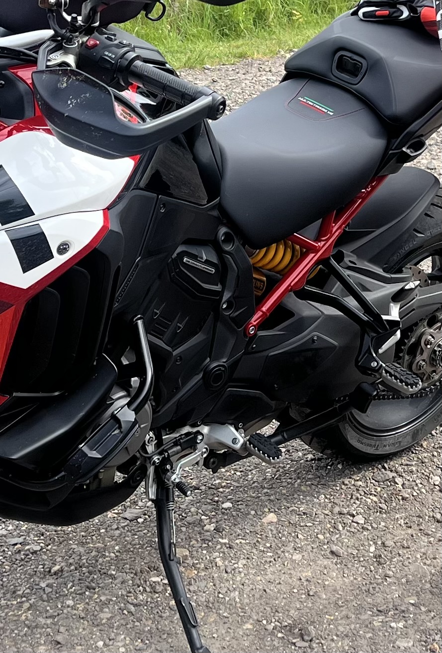

  8. Thanks Andy - how do you identify a high seat in a photo?!
    And anything on the seat like a part number?
  9. The high and low heated seats have Multistrada V4 in white and a green and red stripe embroidered on them, standard height doesn't ( I think)
  10. Ah, no stripe on this one, and no button-looking thing on the pillion seat either, just plain plastic.
  11. Button looking thing is the heated seat controller for the passenger. No warm bottoms for you folks :)
