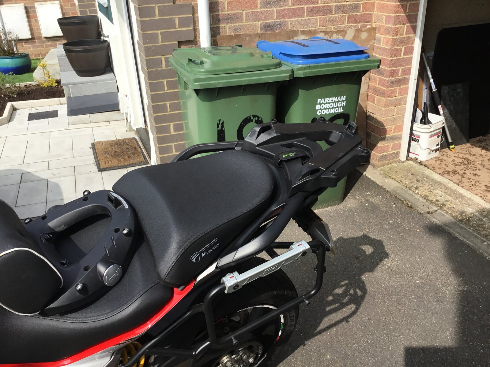

  9. I found the top box std position about 5cm too far forward and the pegs too low and far back. So I moved the box back and fitted adjustable cheapies from ebay. Sorry it's not a great photo but you can zoom in?

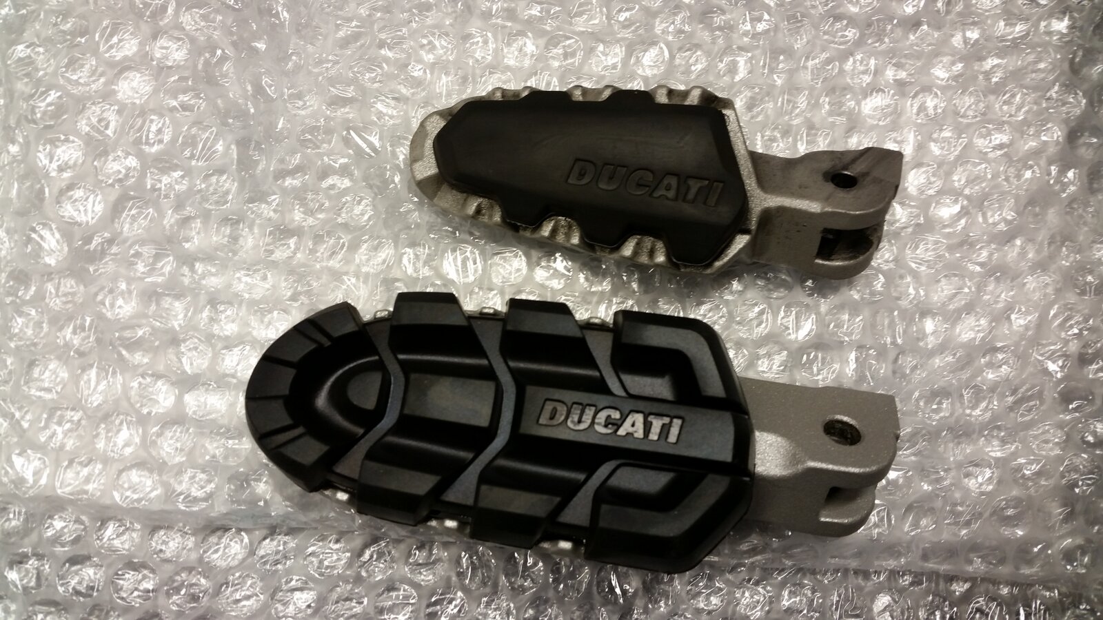

  11. You could try a pair of Multistrada Enduro footrests. A genuine Ducati Part, fits straight on, and they are bigger with larger rubbers. This pic compares the standard footrest with the Enduro part:

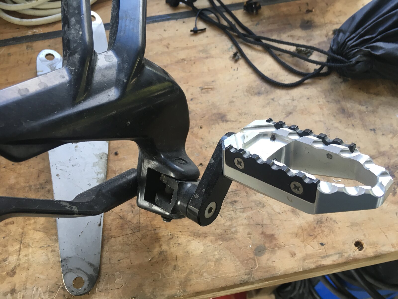

    Mine were cheap and no, they do not fold up because of the design but they do work and that was more important...is a 40 mm concentric
