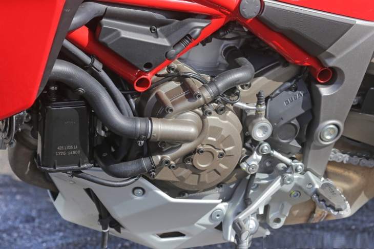

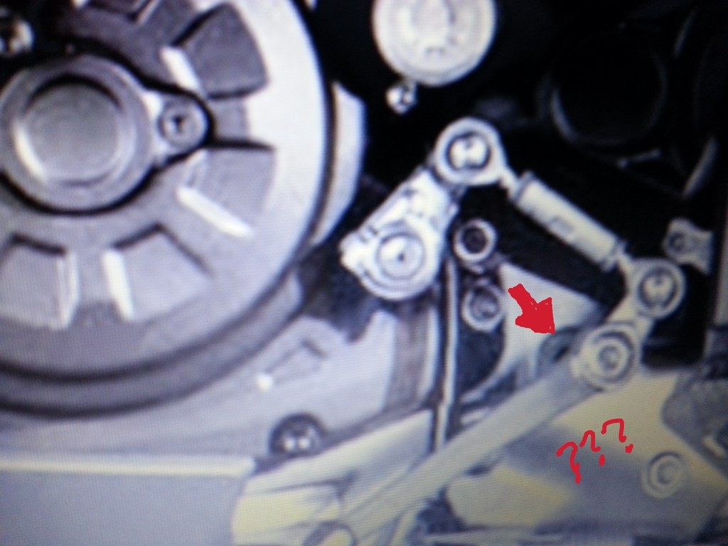

  4. Coolant level in bottle on right hand side of the tank behind the bars/fairing is still on MIN mark when cold engine. Checked chain oil on Cat could be contributory to smell Iainwatson. Noticed what a bolt hole behind the gear lever in the engine under the sprocket cover?? Is this normal?

  5. Yes found in Google images
