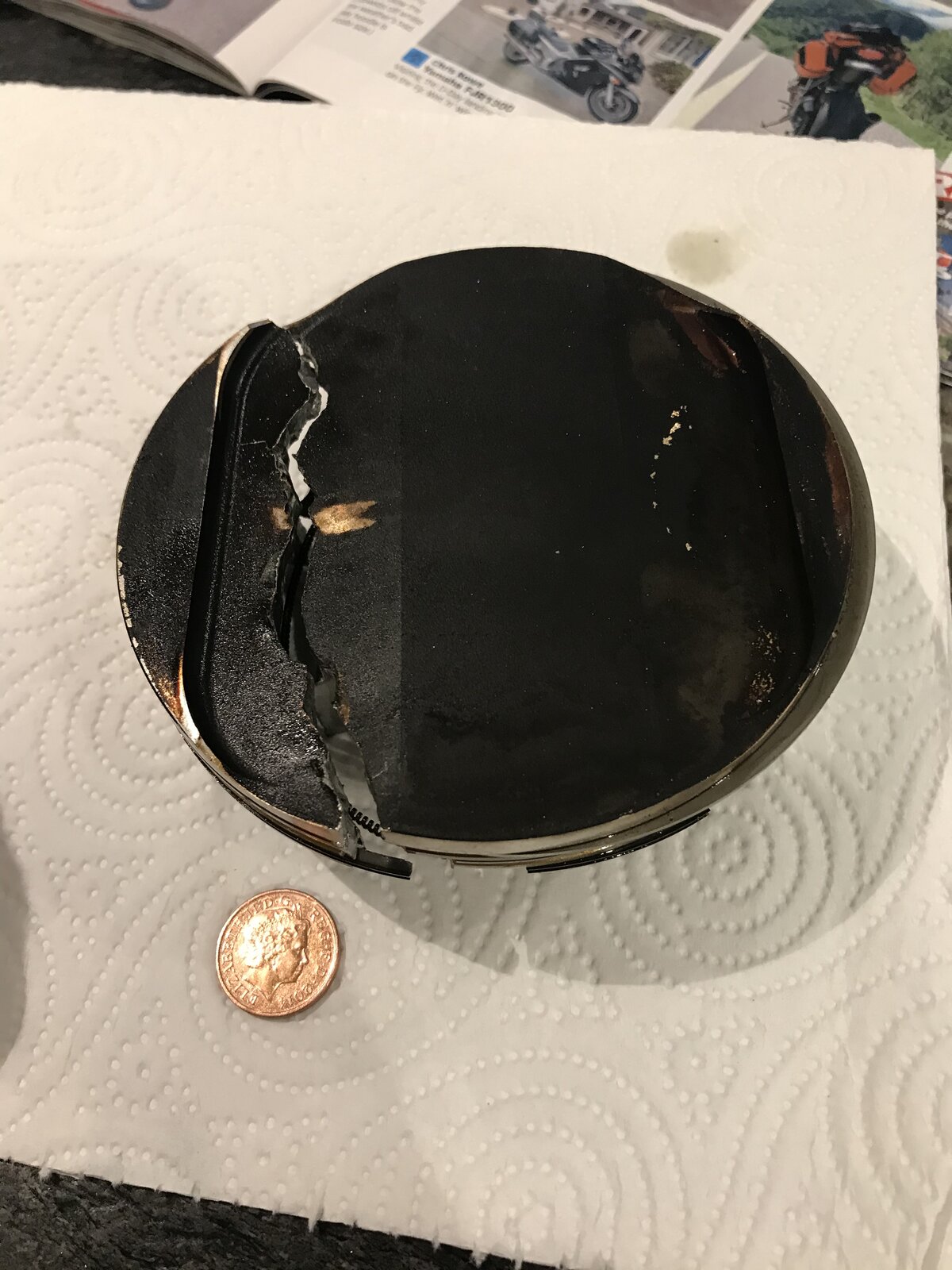

  1. Oops, lucky I didn’t lunch my engine. Good excuse for a pair of HC Pistal :):upyeah:

  2. looks like it been running a bit rich mate.:rolleyes:
  3. Oooofffff!!!
    Lucky escape there Mary o_O
  4. Better that way right? My understanding is that running rich will aid cooling?
    Wilf at MotoRapido set it up. And I think he knows his onions.
  5. The interesting thing is there was no noticeable power loss. Just an intermittent misfire.... and was told a puff of smoke.
  6. Looks like oil burn.

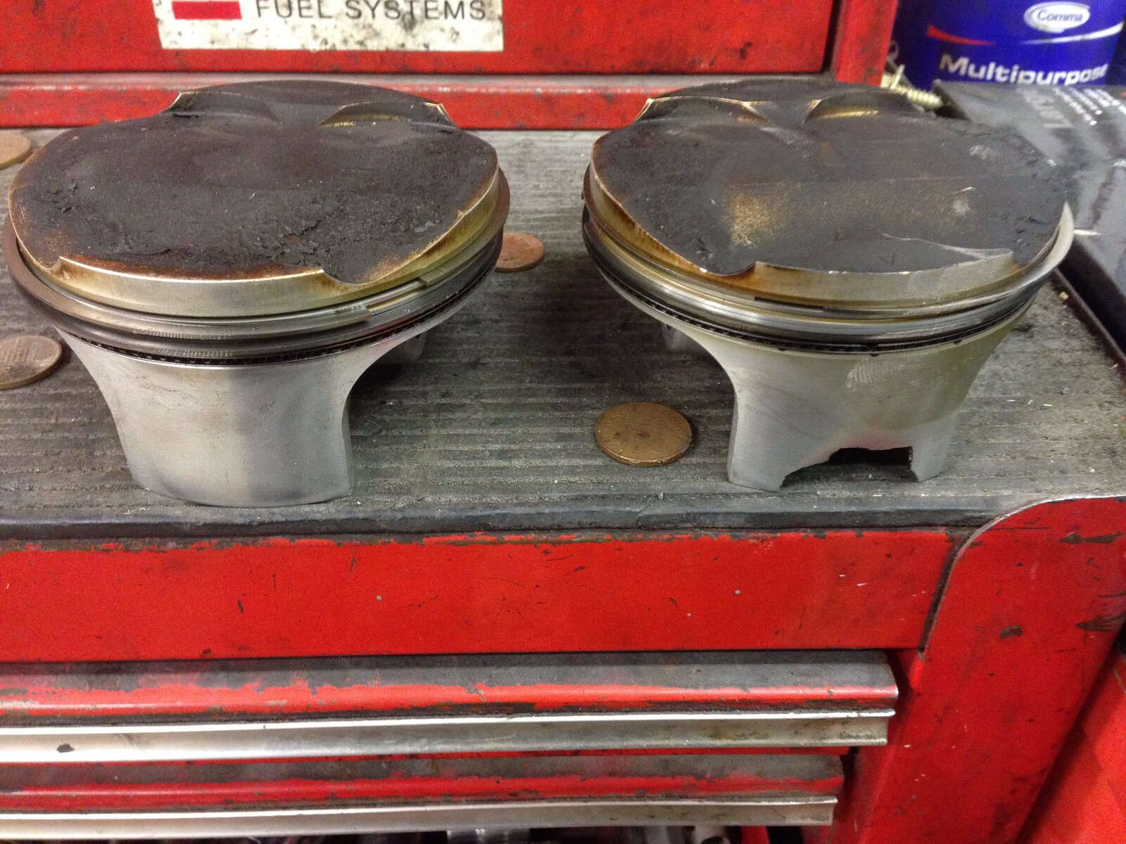

  7. That penny that was in the bore will not have helped...
    • Funny Funny x 8
  8. maybe excess oil coming through before the end? Isn't this your second piston fail Mary or am I thinking of someone else?
  9. He’s had hundreds of fails, just like all of us :)
  10. Yeah, oil coming through the crack/ rings. Bet the other piston is clean.
  11. U loves a dirty ring judging by that fuelling fnarr fnarr
  12. I had cracked piston on my 1098 :(
  13. Cracked the skirt on mine. I have been
    Known for my ability to get skirts off quite quickly
