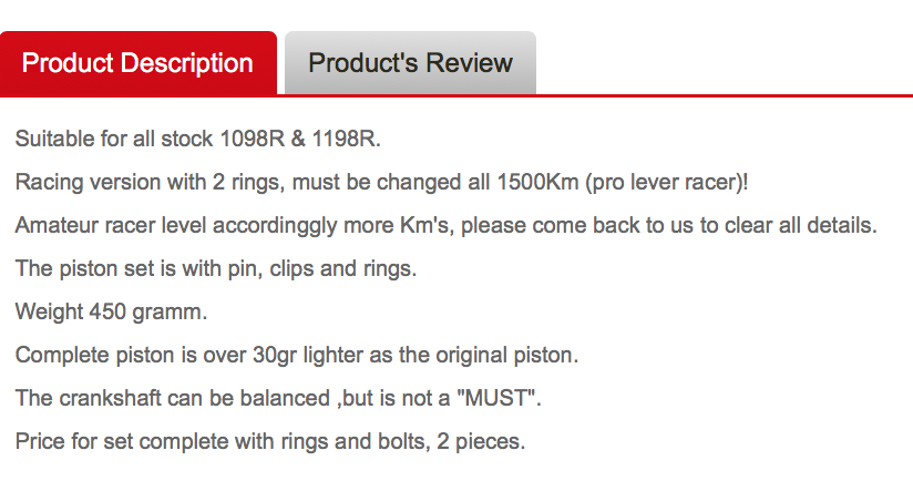

    The pistons are from brand pistal.

  9. life expectancy.... in theory the single compression ring are more 'race' orientated
