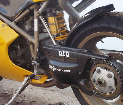

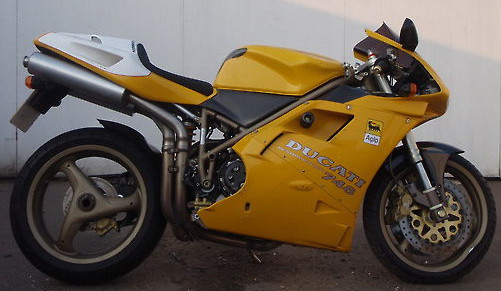

  1. Looking at this salvage Ducati but not sure if it is a regular S or something better.
    Ohlins rear shock, loads of carbon bits on it. Nice and cheap and could be put right reasonably easily.
    It's a cat C though so would be sold on cheaply too.

    The clocks are in Km too, and the rear nuts are lock wired. Maybe for the track day look or maybe for actual track days.

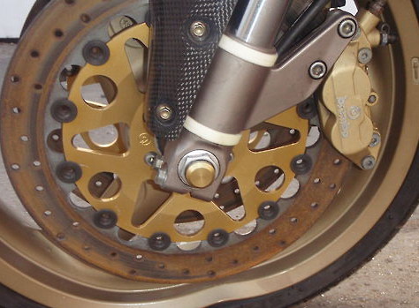

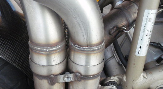

  5. It appears to say 748 SI on the sticker. Perhaps a P has rubbed off on there somewhere? It has brembo discs, an Ohlins shock, 3 spoke gold rims and frame. Im not really sure what floating discs are, but if it is where they have a separate braking surface to that which is attached to the hub then it has those. Although it can't be seen in the photos I have posted, it does say Ducati on the tank, so that's an SPS ruled out?

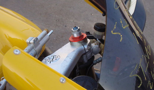

    It has standard end cans, and I'm not sure about the forks.
    I'll post a picture of the fork tops.

  7. Tom, see my PM to you from the other SPS that was on eBay and the part where it state SI under the seat, this could be an early SPS or more likely an SP. My SPS does have a Ducati decal on the tank and those are very likely to be SP\SPS floating discs, they are certainly floaters from the shape of the centre and the rust on the cast iron, but it does have what look like 40mm calipers as it only has one pad pin. The 1998/1999 SPS's had 65mm calipers.
    Looks like an oil cooler to me as the radiator is much higher up and above the V panel and it does not have a mesh grill like the stock 748's

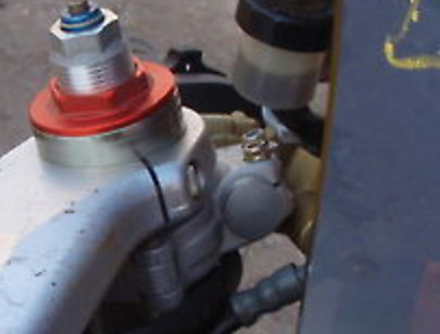

    Photos of the master cylinders would help also as SPS's had early master cylinders and the later 65mm calipers, I'd say it'could be a 1997 SPS or at least an SP from the photos.

    On further evaluation I think that the forks are showas. Did SP models come with Showas?
  9. This is the best I can do on the M/Cylinder
    Defo showas on the front and not Ohlins

  10. easy one - its a 1997 SP. Same as I had

  12. Floating discs on front, 40 mm calipers, alloy subframe - looks like an SP to me. S1 on sticker would be consistent, too. What damage for Cat C rating? Check the rockers!!!

  20. Ducati have been on the blower, it's a genuine 748SP, built in 1996 and first registered 08/05/1997 in the UK.
    Has kph clocks though. Is that normal?
