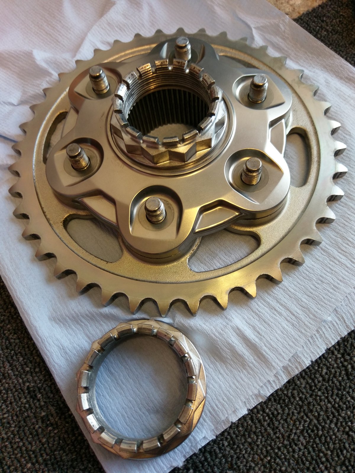

  6. @comfysofa , these wheel bolts went through 2 winters, this was the result solely with the brass wire in a drill. Now polished, laquered and re-fitted :upyeah:
  7. Yes mate, hand brush will leave more lines and steel brush turns metal grey, brass does not leave a grey tarnish. :upyeah:
