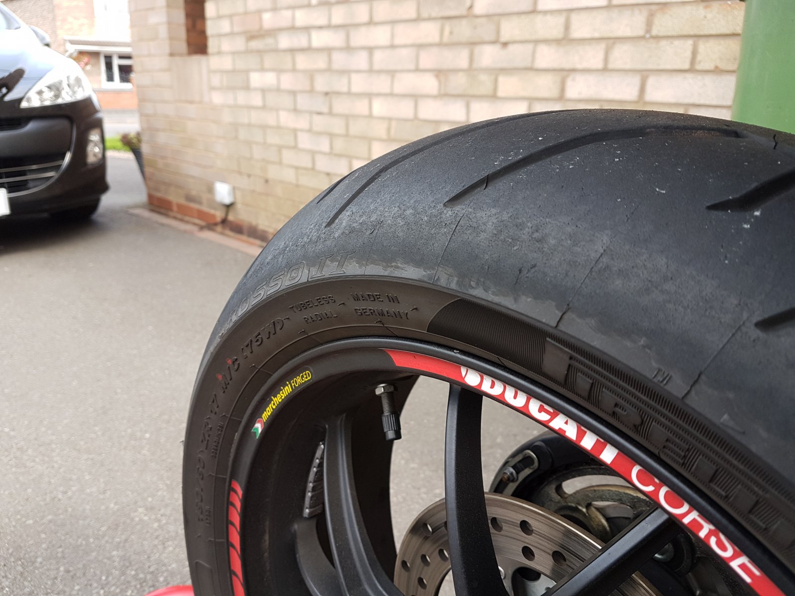

  4. I'm quite near the edge of the tyre so I'm getting it over....It just doesn't feel natural....Like I'm having to force myself

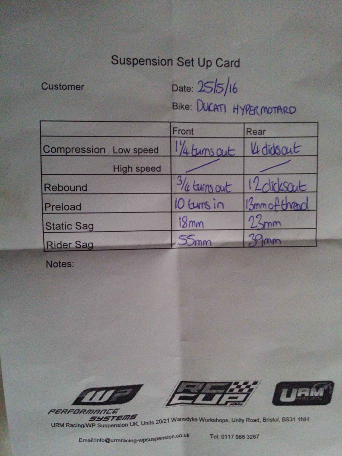

    Here's mine....let me know how you get on...

  10. Well that was strange..
    Just put your settings in my forks @comfysofa
    I was running less compression (3/4) and a 1/4 less rebound but my preload was way off, I was on the factory of 3 turns in
    Weird thing is I went in 10 turns and it doesn't seem much less sag ?
    I'm quite good at telling if the sag is more or less as I'm on tiptoes so it's easy to notice but 10 turns in felt no different to 3
    Must be a very fine thread on the adjuster or does the Hyper have a progressive spring...
    Even 3 extra turns in on my previous sportsbikes would make a massive amount of difference....

  16. 18mm static sag comfy?! And 37 more with you on it?! Stronger springs needed, overall 55 probably ok but should be 30-35 to start with (maybe even more with a SM type bike)
  17. I'm around 15st and at 3 turns in preload I was around 40mm sag..
    I have read a recommended sag of 50 for our bikes.....Is this correct ?
    I think Luigi and Mario just slapped in our bikes whatever was next to the bench as the owners manual is wrong concerning the forks on the 1100 anyway
  18. Motorcycle Suspension Setup Pretty good source of info. Dont know if Hyper different tho as may have longer stroke, but this will show you how to set it (iirc rider sag 1/3rd of max stroke)
  19. Dunno.... I've messed around with suspension and never really got anywhere so took it to a local place (about 10 seconds from jhs). They set up race bikes and rich at louigi knows him and said his lad knows what he's doing.... Feels fine to me but as I said I'm shit with suspension... He did measure it with me on it.
