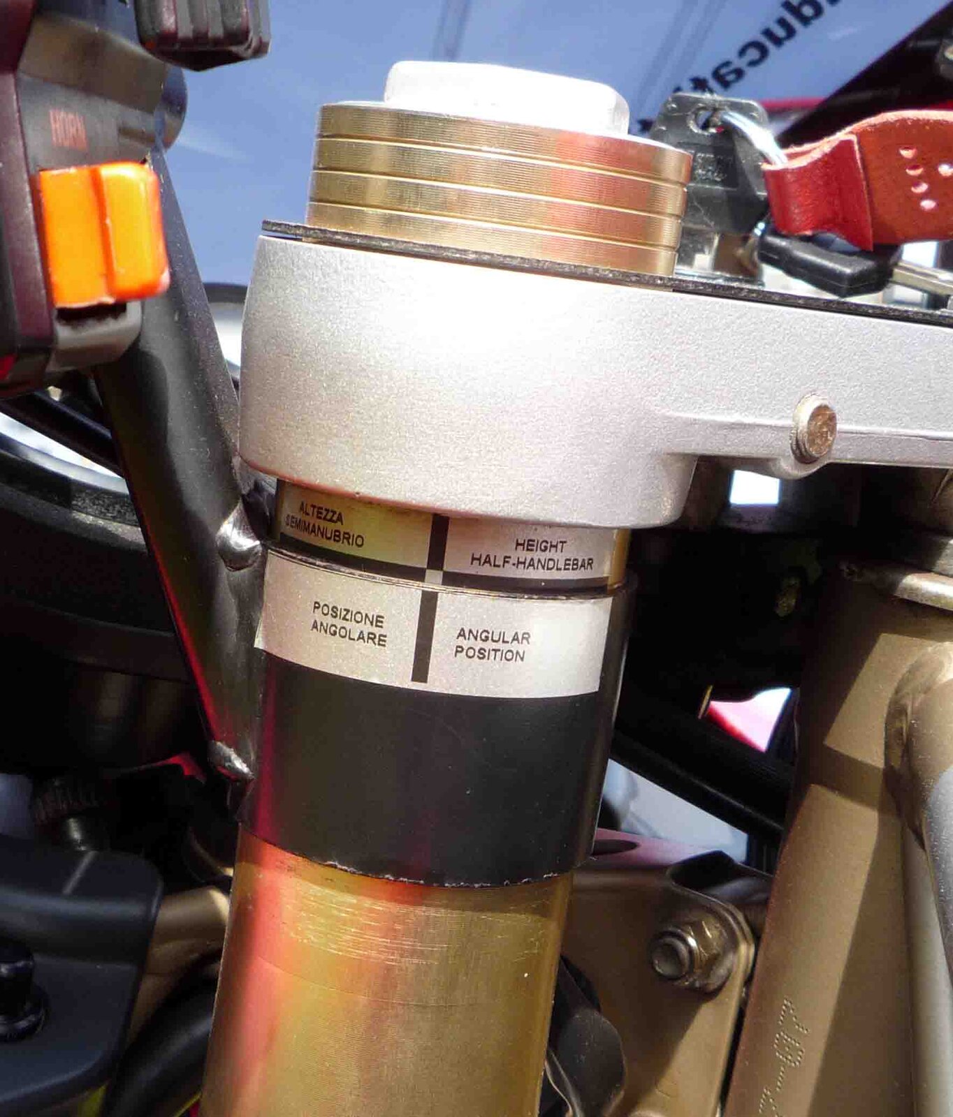

  1. In this video the tops of the forks pass through the top yoke (clearly seen at 1.44) and at 0.42 you can see there are no caliper mounts on the right hand fork. Have the forks been swapped?

  3. My forks finish flush with the top yoke and there is an extra piece of plastic trim to hide the missing caliper
  4. I thought I saw about 4 or 5 rings showing at the top of the forks. For them to be flush in my experience is abnormal but easily adjusted.

  5. Normal-ish position on a 750 (before I changed to Showa adjustable shocks).......So those in the video are just about right.

    Fork tops look to be in the normal position although not all forks had those rings machined in them. Wheels have been re-painted & there appears to be a hole in the right-hand side panel.

  10. My '95 600ss has about 20mm (4 rings showing) of fork protruding from the yoke. Agree about the extra plastic bit screwed into the caliper holes on the side with no brake disc :)
