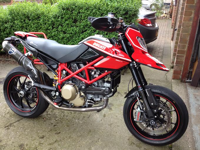

  1. Ive just bought my hyper 1100S and im trying to decide which route to go with it. I cant decide which way to go with the exhaust either termi, zard or arrow. Its going to boil down to which is more flexible for remapping, the dp race ecu that comes with the termis or a power commander. Any ideas?! I will eventually be doing a few more engine tweeks, cone filters and if i can find them some dp racing cams! Although they seem as rare as hens teeth!
    Quick pic of the old girl!

  4. Looks good, but i fancy one of these
    Hence trying to work out if a race ecu or power commander with the standard ecu would be best. Ill probably be dropping an open air filter in as well.
  5. Looks nice, bet it sounds very nice

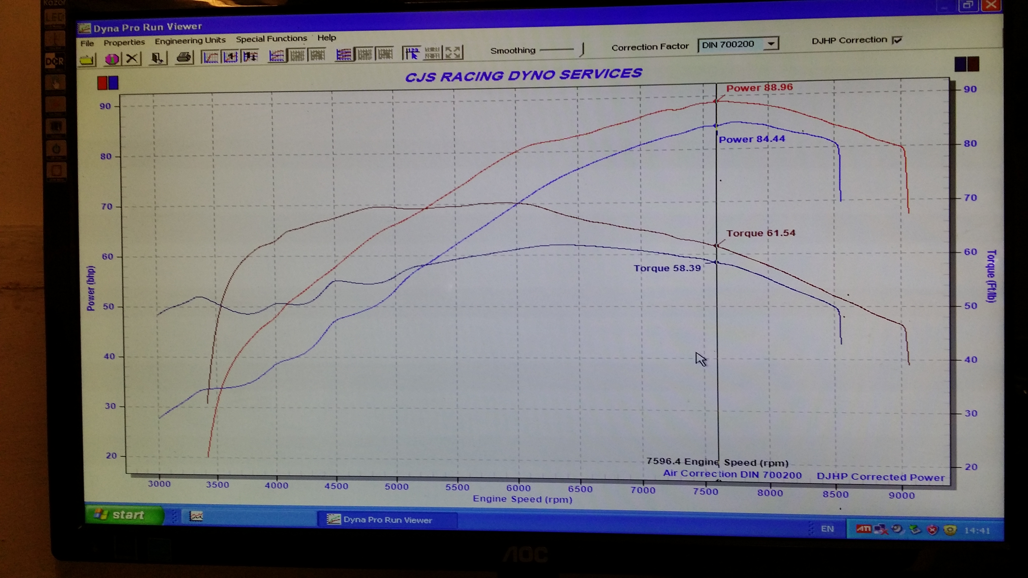

    As cookster said....take it to CJS, its a night and day change. Theres mine before and after plus on top of the fueling he also did:
    1. Removed o2 sensor connection (they can be unplugged)
    2. Extended the redline from 8.5k to 9 (before it hits the limiter)
    3. Blanked off flapper valve (motor can then be unplugged)
    On top of all of that it uses a lot less fuel now as well. Id say the main difference is slow speed crawling through traffic....instead of the engine "hunting" ie going up and down the gears, pulling the clutch in all the time...that's all gone...coupled with the clutch slave cylinder its perfect for heavy traffic now...
    As you can see from the dyno output he got the best gains in the midrange torque....the fun area....
    The only thing is....is do all the engine mods your going to do before he gets it as if you mod the engine after itll have to be dyno'd again....
    The main reason he get such good results is he maps each cylinder individually, he says (and I totally believe him) that this is the best way to map them as the rear cylinder will perform differently to the front.
    Don't even bother with the race ecu - a custom map is far superior to a race ecu.

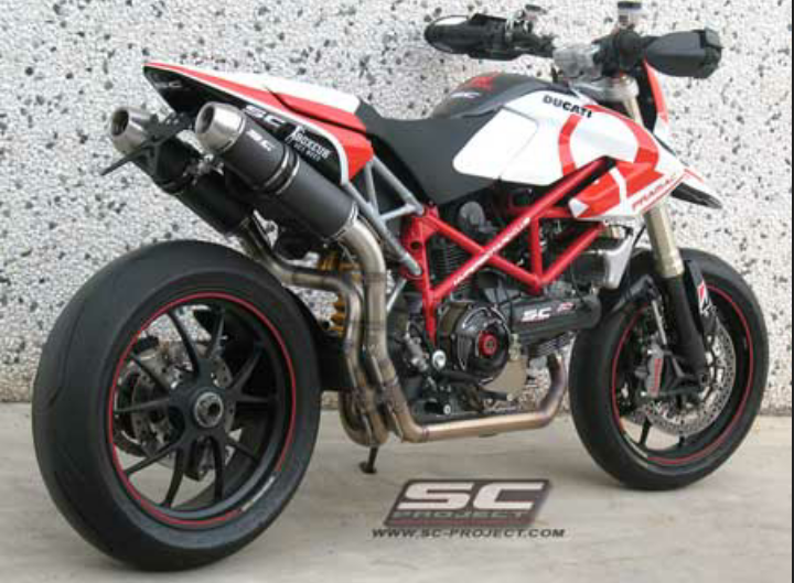

  19. I think im going to go for an mwr open filter, the one that gets rid of the top of the airbox. They sound fricking awesome! Possibly the sc projects exhaust i posted earlier in the thread or an arrow full system with short cans. Cant decide yet! Plus i need to save for them and a week stint in vegas in september so possibly doing it over the winter! Oh and the obligatory slipper clutch and quick shifter just for the noise!
