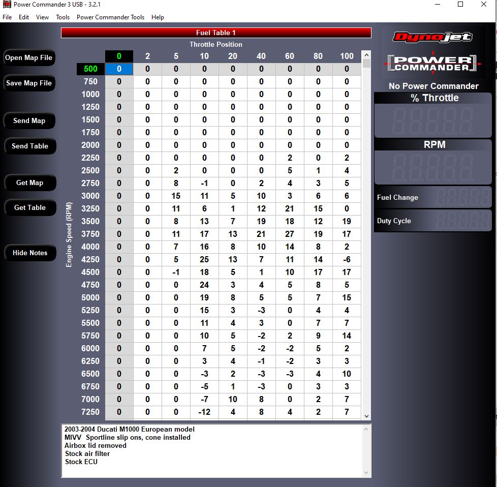

There are lots of base maps available on the Dynojet website(at least last time I looked). Often several for each bike, with just an exhaust change, Exhaust + Filter etc. It's just a case of uploading them to a laptop and and then loading them to the PC. The map is then simply a load of sites mapping Throttle position against revs where you can + or - the amount of fuel you want. As I mentioned it can be very satisfying to play with, but is a bodge. The only way to get a perfect result is to have somebody do exactly the same process on the map in the standard ECU whilst the bike is on a Dyno. Below is one of the 'Maps' I uploaded from the site for my M1000 which I then had a play with. Note the mods at the bottom the base map is aimed at.
