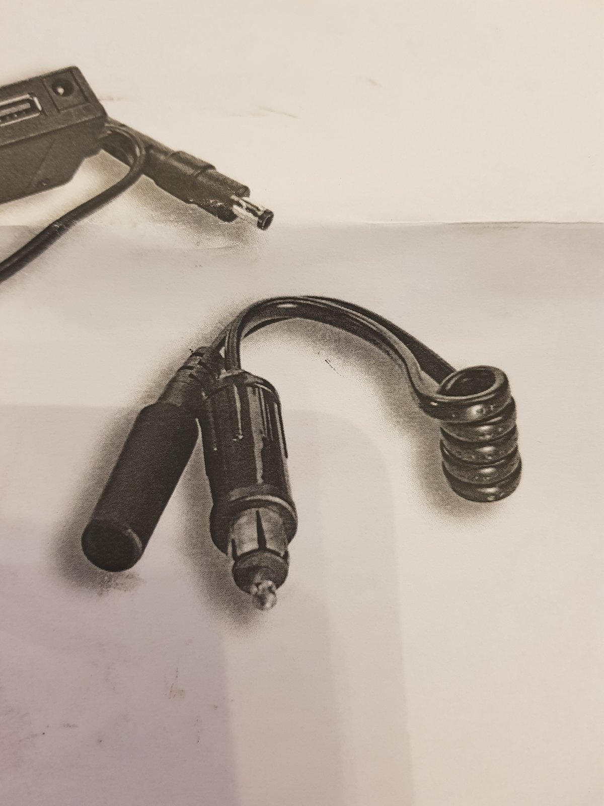

    I have a piece of paper somewhere with a picture of what I am after, Unfortunately it has no part numbers listed on it. I will post a pic of it when I find it.

  6. This is what I am looking for.
    Happy to give it a go at making one, however what are the ends known as?
    I can find the lighter plug end on line but not yet found the other end.
  7. look at give for spares as they actually make the kit for ducati but sell it themselves for a lot less. for example the power hub kit can be bought for around £50
  8. Its a hella accessory plug, and the other smaller connector is called a co-axial DC power connector.
    They come in different diameters and current ratings.
    If you have one that you need to get the matching half to, the important thing is the diameter (and length) of the central pin.
    Maplins used to sell them for not very much money. RS still sell them but a bit more spendy. Mouser sell them too, no idea on price as I dont use them.
    No doubt they are available on the bay too.
    Hope that helps.

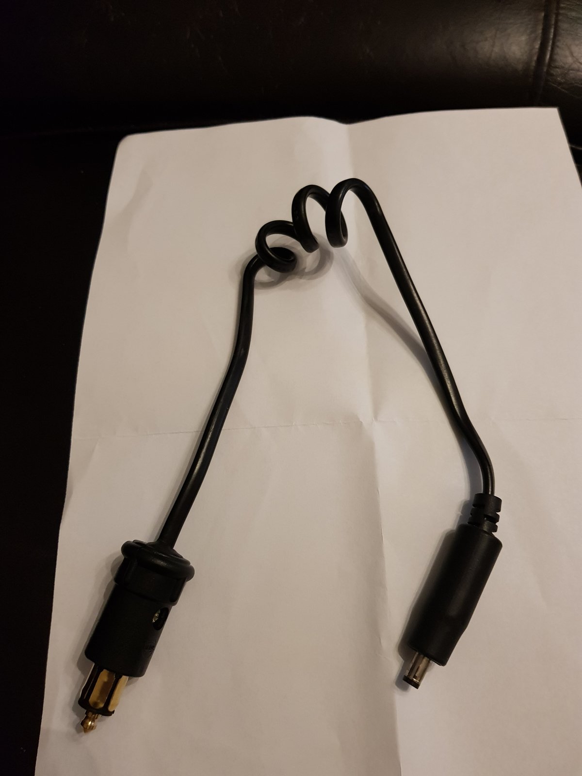

  10. Managed to get a hella plug for £7 and reused my old power lead from my 2015 Multistrada. Saved myself £78
  11. Managed to get a hella plug for £7 and reused my old power lead from my 2015 Multistrada. Saved myself £78 View attachment 125973
