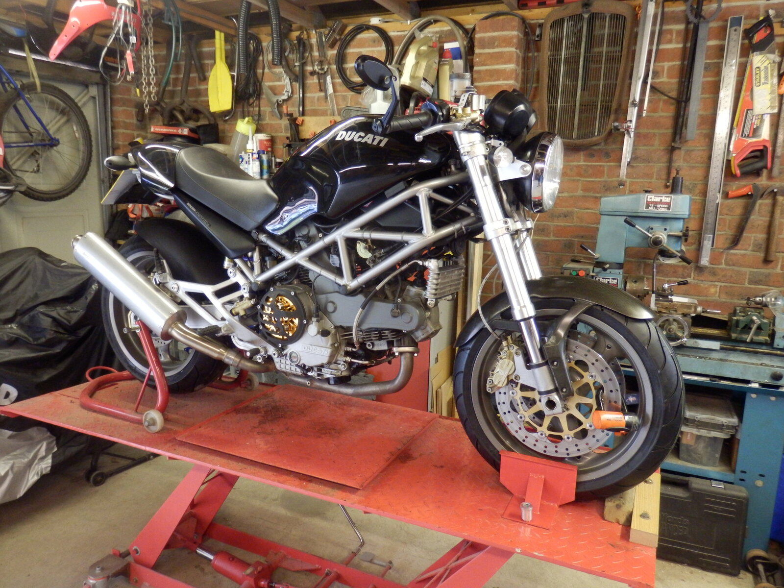

  1. A couple of months ago I brought a rough 2004 M1000.
    Mainly because I wanted another project, and because I'd fallen for the 1000DS engine in my 1000SS project and wanted a Monster with the same engine.
    I've spent a lot of time on it and will post some better images soon, but have added amongst other things an ali swingarm and adjustable front forks, as well as giving it a thorough service and clean.
    It has been a lot of work, and I can't believe some of the abuse I found.
    It came fitted with high level DP Remus cans, which I don't like the look of, so I've swapped them for low level ones, and added a K&N filter. The airbox lid was already cut wide open.
    It also came fitted with a Dynojet Powercommander 3 USB, which I wasn't sure of, but left in place until I'd had a chance to ride it.
    I got it MOT'd a couple of weeks ago, but over the weekend I finally managed to get out on it and did @30 miles on a variety of roads.

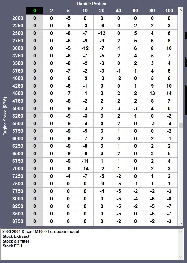

    Considering how well the bike went and feels, I was surprised when I plugged into the PC3 using downloaded Dynojet software that the map says it's the one for a completely standard bike.
    The only difference I can see between the Std bike map and the one loaded is that somebody has been in and added some fuel at 100% throttle opening over 2250RPM.
    And I can't remember having it wide open on my test ride.
    I might download and flash the Dynojet map for a bike with the mods and see what happens.
    Has anyone played with these things much?
    Dynojet PC3 map for std bike:
    Map on the bike that somebody has adjusted:

    I have all the pre-developed maps, I've downloaded all of them relating to both bikes with various mods just in case they disappear from Dynojets site.
    I'm interested to hear from anyone that has played with these in detail before.
    I suppose my goal is to get at least one bike, probably the M1000, as good as I can using the PC3 and my seat of the pants Dyno, then get it on a proper dyno to see how well I did.
