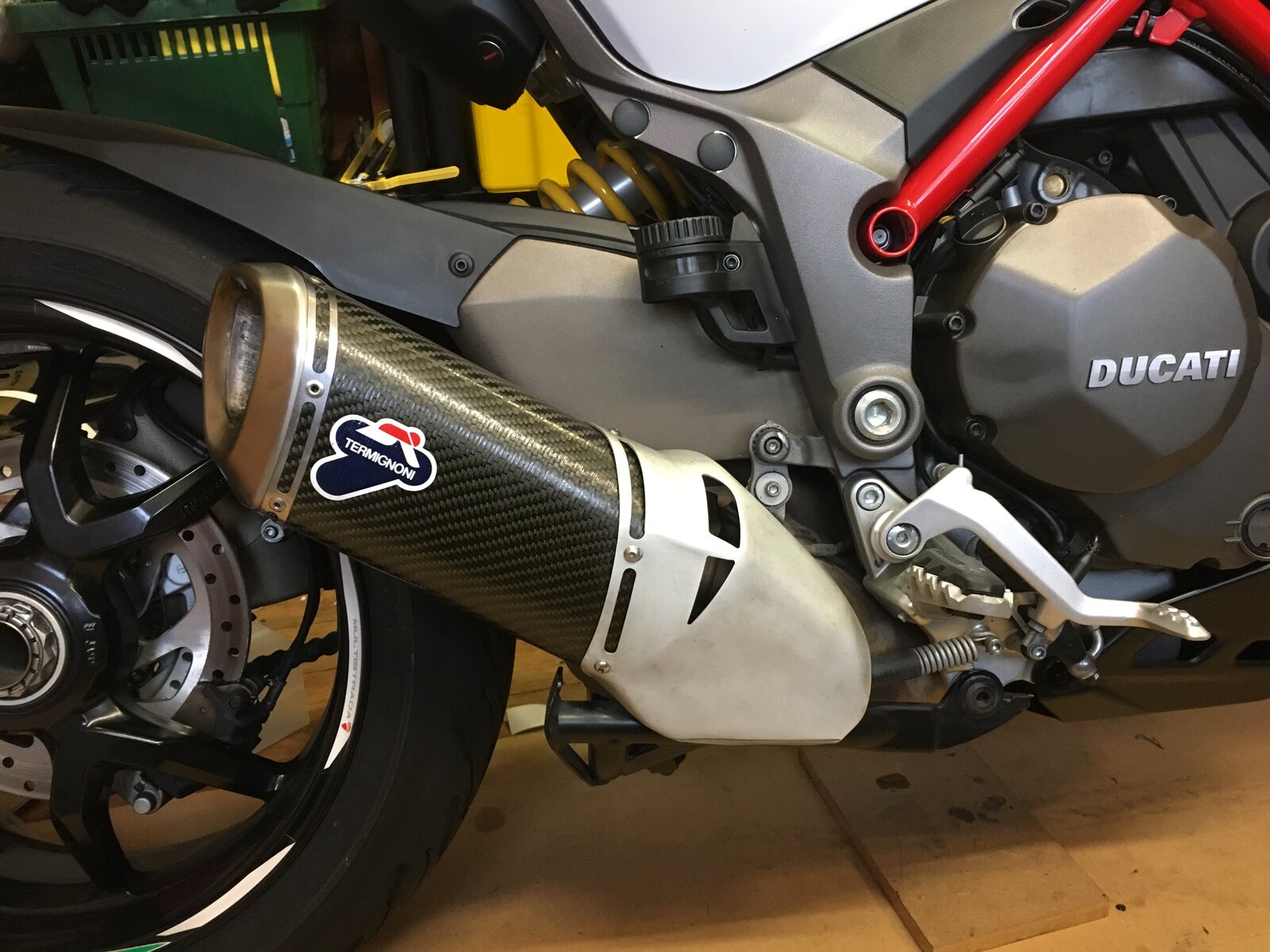

  1. A70CD57F-BC58-4117-8166-4F13B66DF12F.jpeg Hi Guys. Something that had interested me for a while was whether the pre-DVT Termi end can would fit the DVT.
    Well I can confirm it does but requires modding the cover plate to fit more cleanly.
    In total, to get it to fit as per pic took about 2.5-3 hours.
    Basically cutting and filing the plate along with some re-bending.
    Currently painting the plate black so more pics to follow.
    Hope it’s of interest.

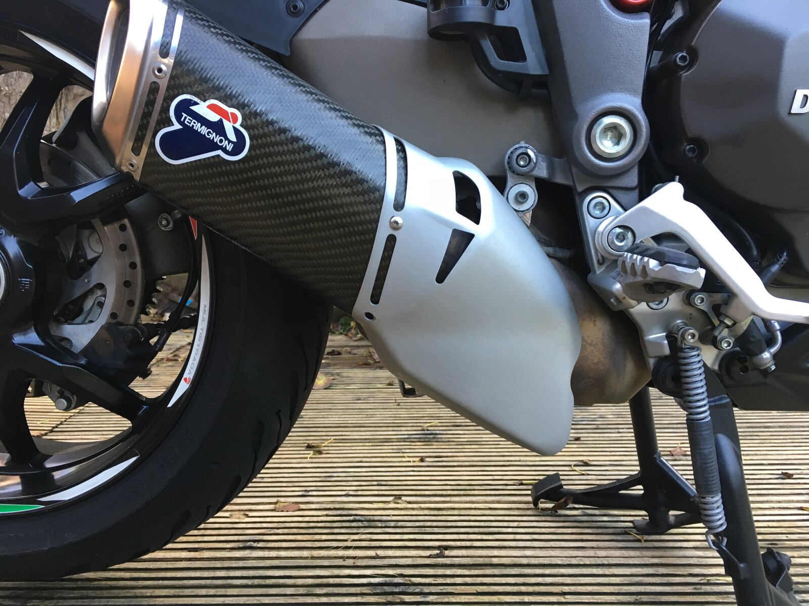

  2. 67B2744F-3A6F-49FA-BA65-25A5C032DD96.jpeg 7E2EC7EB-FDFC-4F1F-9D1F-E8B095DFEDA6.jpeg Painted black temporarily to give you an idea
    Will Powder coat next week.
  3. Good work. Much better black.

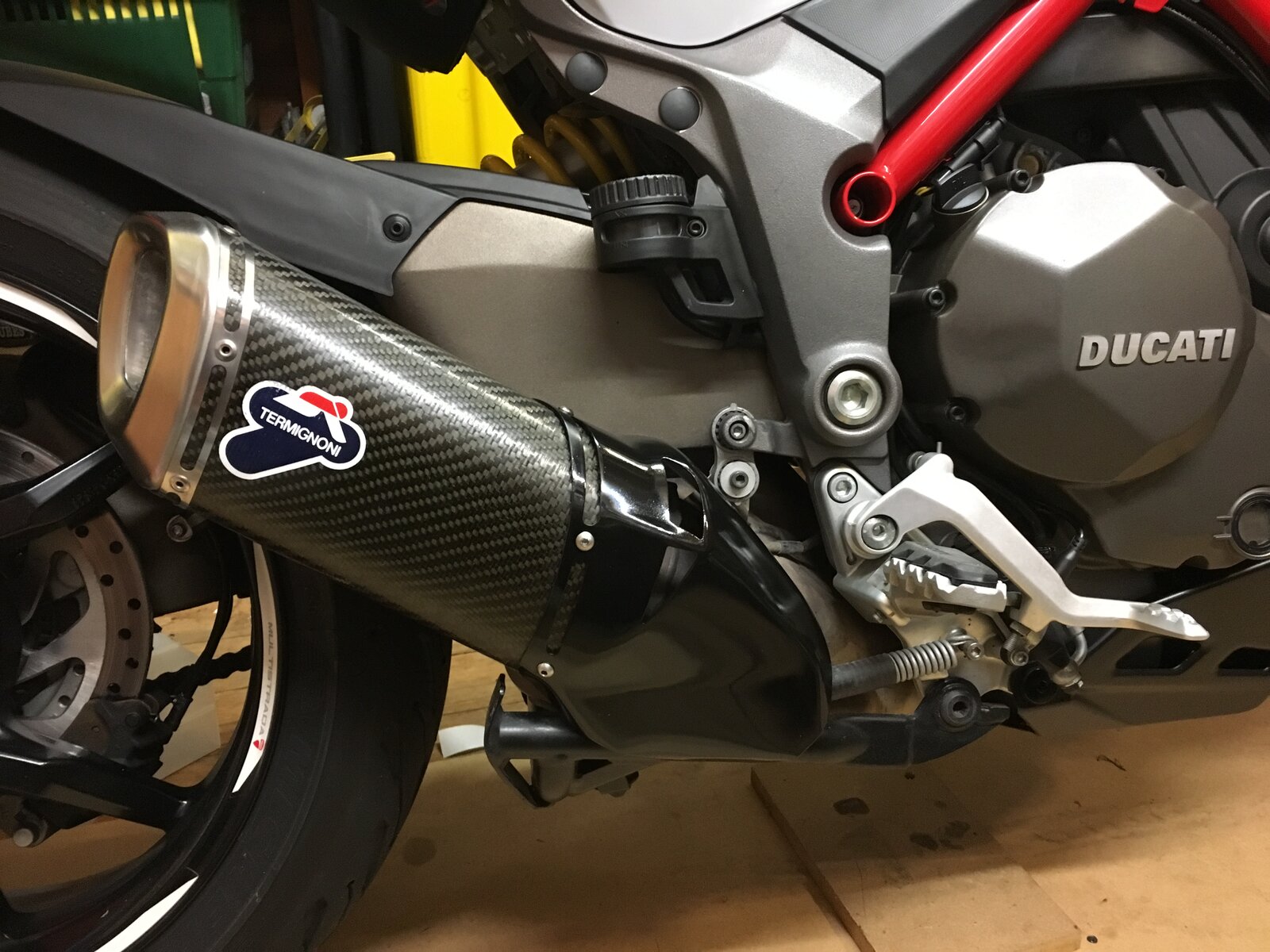

    Original Termi cover plate.
    Painted.

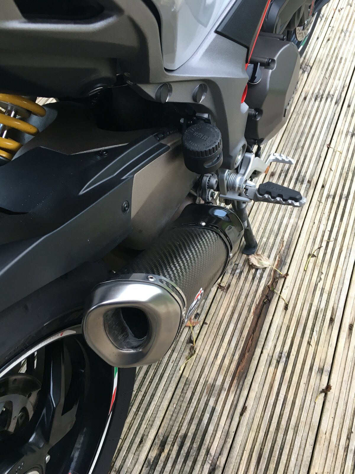

    can you post a pic from the rear of the bike please, in some of those above it looks like it points outwards, just wanted to see if it does or not :yum
    Oh, and how loud is it :)
  6. Noise wise it’s little to no difference. Marginally louder would be fair I suppose.
    End on pic to follow.....

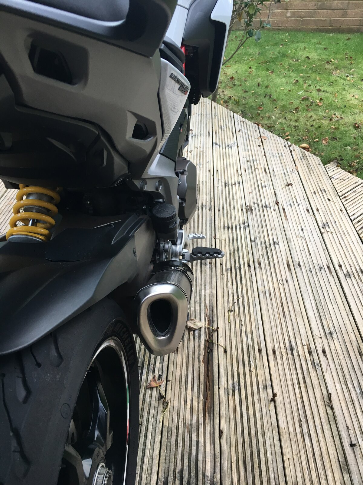

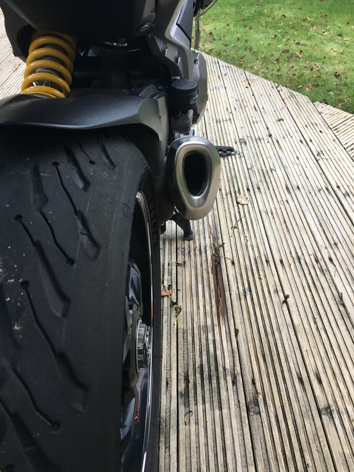

  7. End on pics.
    652A0E4F-10D2-4D1C-B0B1-A102200568B0.jpeg F90D1AA4-4C65-479E-9516-7005F1DC6302.jpeg
    I have a few more if req’d.

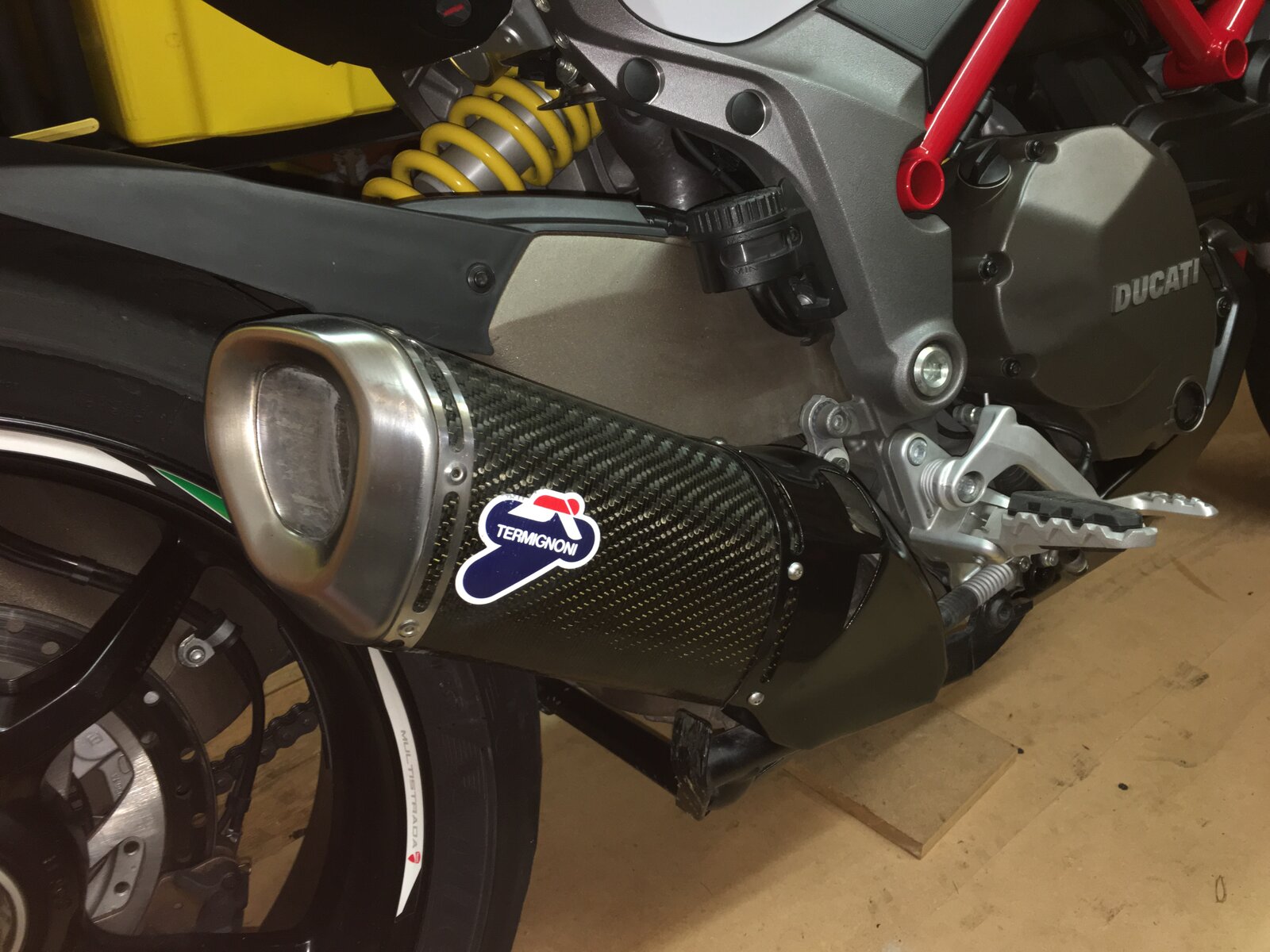

    Tucks in tight like standard.
