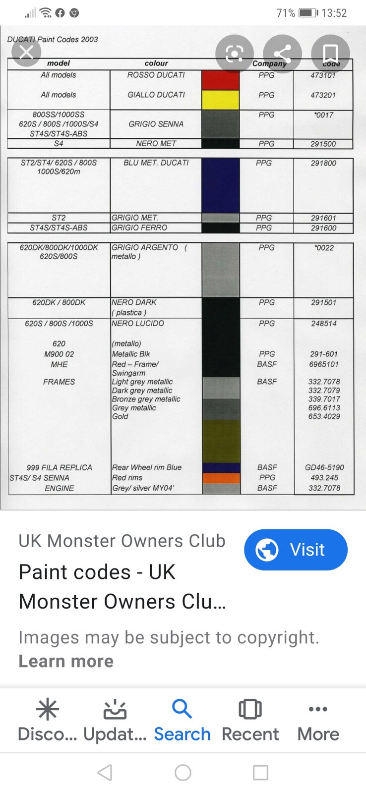

    On a related matter, I'm presuming there must be a code for the satin bronze Ducati were using in the 1990's? I guess I'll be asked for that information from whomever does it over here. Does anyone know what it is please?
    On a further related matter, does anyone know what the colour code is/was for Ducati yellow from the 90's as well please? Having sorted the mild scratches on a couple of my body panels I need to have them re-sprayed. I did order a rattle can (Fly Yellow) and some lacquer from RS Paints but I'm not happy with the results.
  5. Any good. Screenshot_20191127_135256_com.google.android.googlequicksearchbox.jpg Screenshot_20191127_135256_com.google.android.googlequicksearchbox.jpg

    Good luck with the Bronze bit, hope others can help - I struggled (and failed) last time I attempted to match original.
    Re: yellow - Broom yellow comes to mind?
  7. IME the exact colours for both the yellow and the frame bronze varied all over the place over the years. The yellow also depends which colour they were painted over in the factory. For decent results with a partial respray or to keep it looking close to original, colour matching is better than buying to a code.
