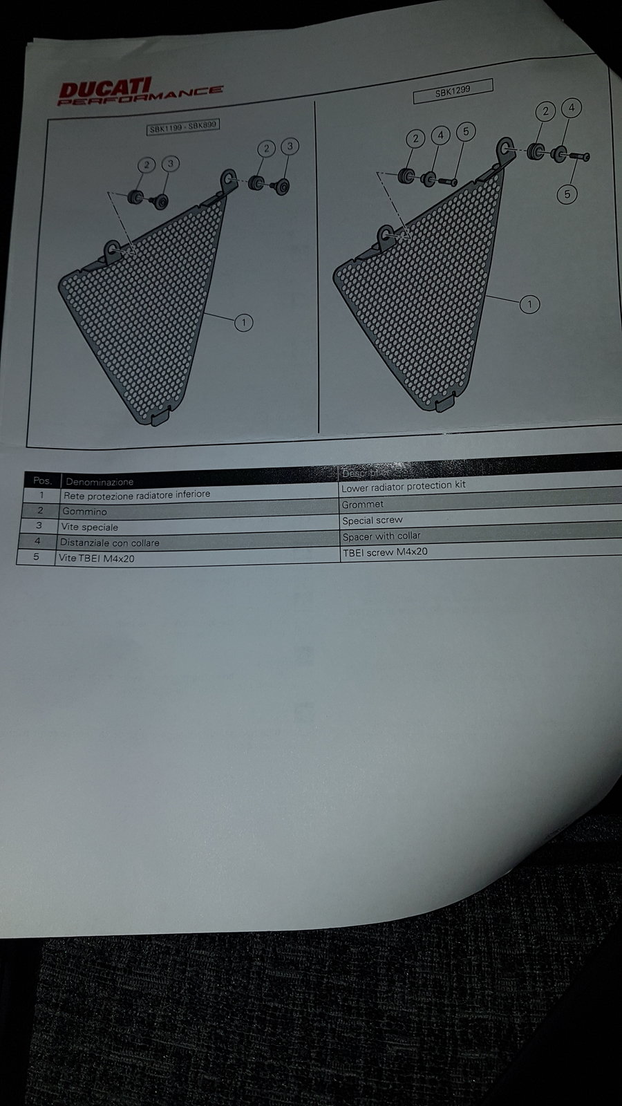

    Interestingly it doesn't mention the 959 on these instructions!
    I think it looks the same as the 1299 though as I think I can see the spacers/ collars under the bolt heads?
    Looks like you need M4 x 20 bolts
