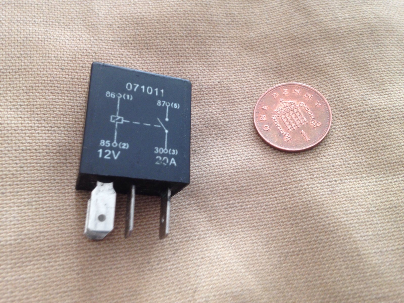

    Fuel pump relay is next port of call, behind battery box unless its been relocated. Interchangeable with headlamp relay. £3 new.
    4pin 12V 20A normally open.Put it in rubber glove finger to protect from road crud. image.jpg
  3. thanks for your help there mate , ( see within post " fuel relay thingy " ) i have already fitted a new relay , and yes been in the electric box and refitted the heat shield and re positioned the relay :Banghead: , what fkn pia that was , dont want to have to do that again, keen now in checking the connection you mention, where is it and how do i get at it, what does it look like , is it seat etc off and lift tank, ( done that as well and dont want to do again if poss ) alas i am suspecting the pump thingy its self,, hope not. thanks again mate , app.
