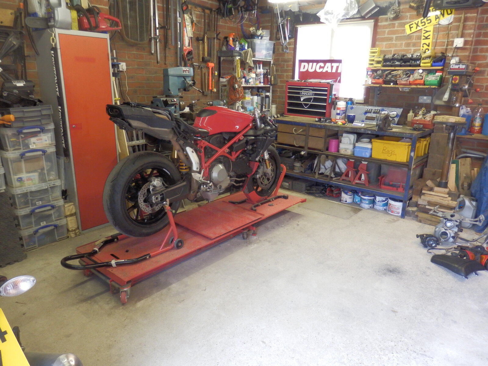

  1. Last Thursday I collected my latest project from a fellow forum member.
    A 2005 MkII Ducati 999. Believed to be a Biposto ‘S’ Variant.
    I’ve been looking for a project 999 for ages, and had given up, but isn’t that always the way.
    It was good to meet you @matapaca, I’m really pleased with it.
    It joined my M1000 and 1000SS/900SL in my workshop, and the various loose parts have been stored.
    It started and ticked over OK when I collected it, but I won’t be starting it again until I change the belts, Oil and filters.

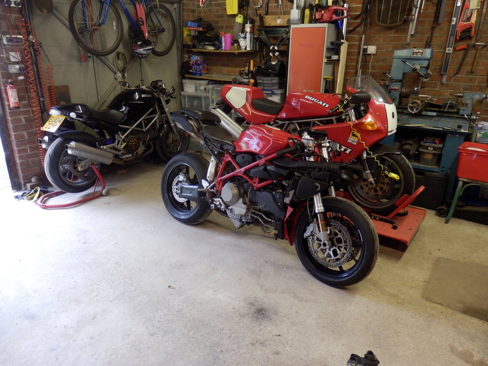

    The overall aim is to produce a bike I can enjoy rebuilding, tinkering with, and using on the road.
    I don’t want a spotless, perfect cosmetically bike that I’m afraid to use, but it must be mechanically as good as I can get it.
    Importantly it’s my first ‘modern generation’ Ducati with twin cams, water cooling etc, so I’m going to learn a lot.
    For example I can change the cambelts on my 2-valve aircooled bikes easily in under an hour, but haven’t done a 4 valve twin Cam Ducati, so I’m looking forward to that – yes really.
    I spent Friday afternoon going all over it, measuring everything to ensure it’s straight, which I’m pleased to say it is, and assessing the damage, wear and tear, and general condition of it.

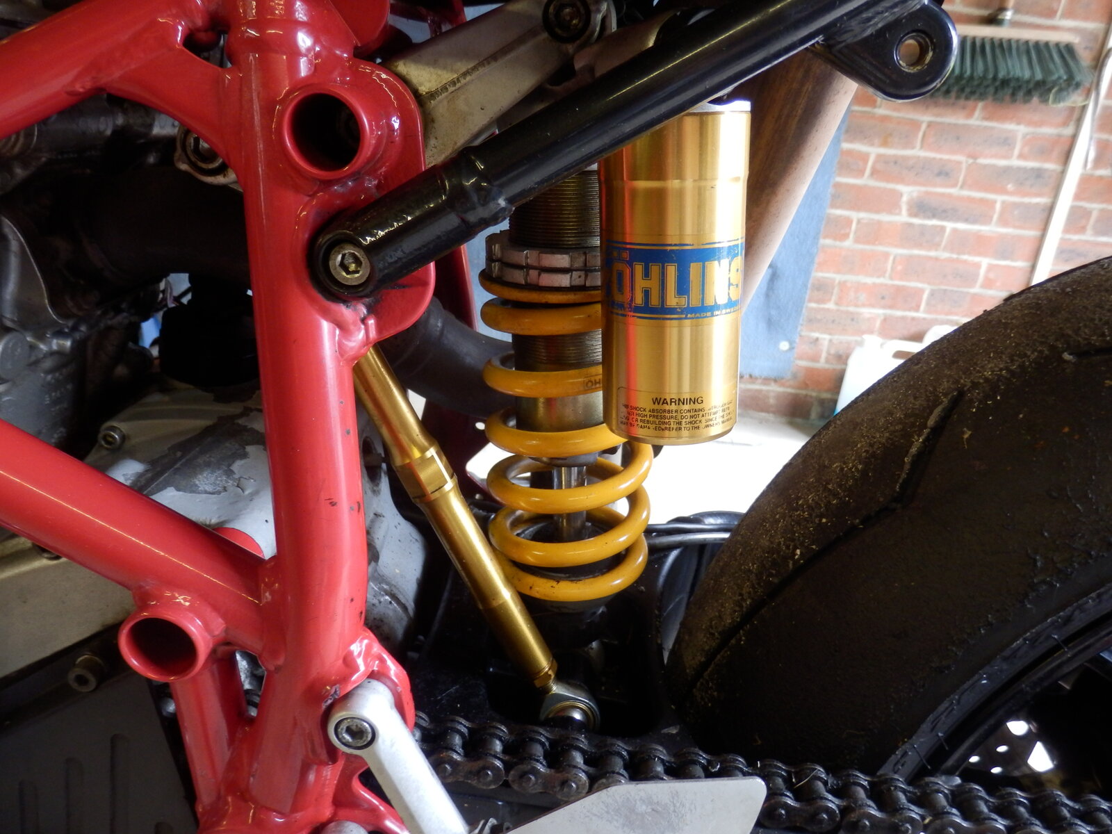

    An Ohlins rear shock is fitted, but from research I can’t say for sure if it’s been retrofitted or came as part of the ‘S’ package.
    I will need to assess it for condition properly, but on a quick bounce test it didn’t feel too bad.
    An adjustable aftermarket Rear suspension link has also been fitted which is in good condition

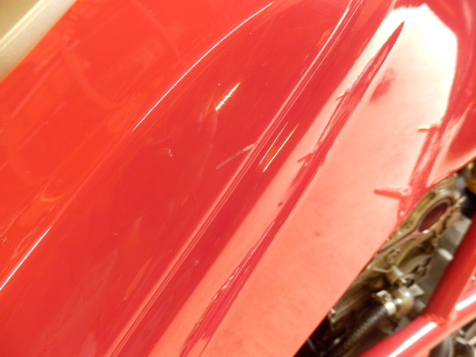

    The Tank has very little damage to the paint, and as far as I can tell at this stage is not corroded internally.
    The two small marks in the paint I believe I can take out without resorting to a complete respray.

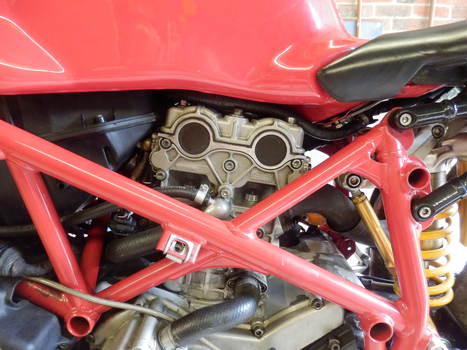

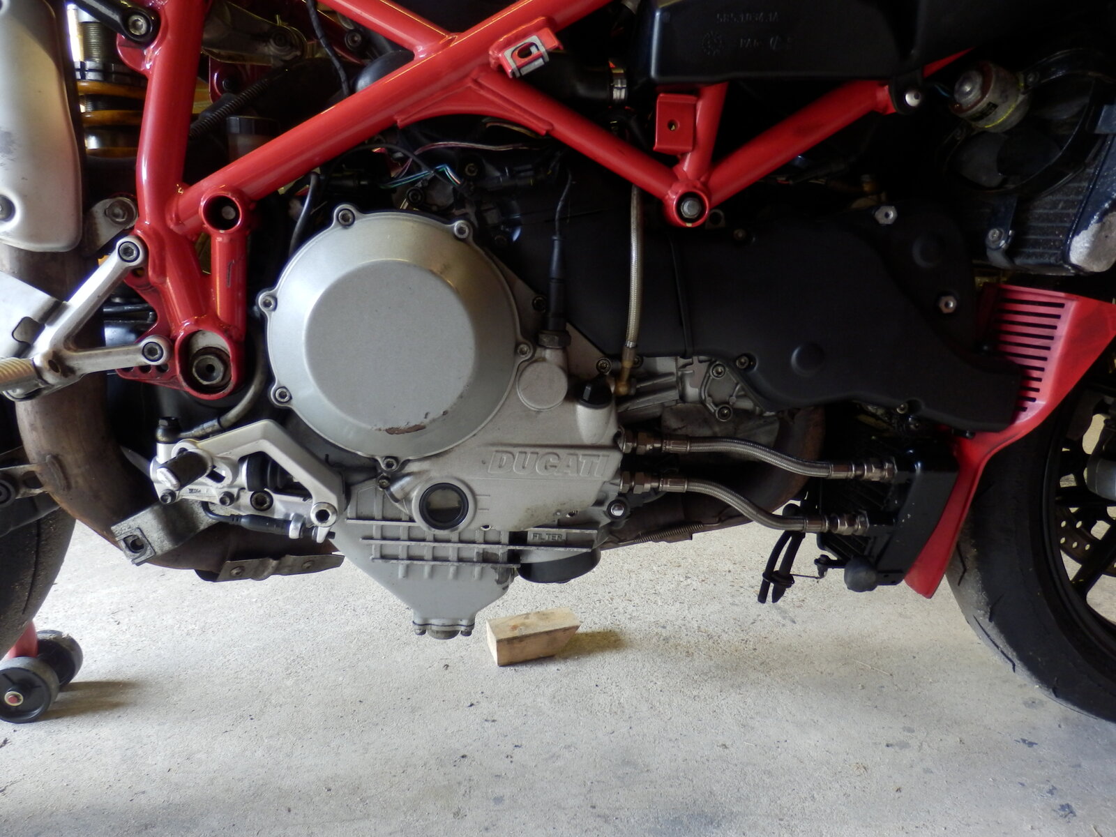

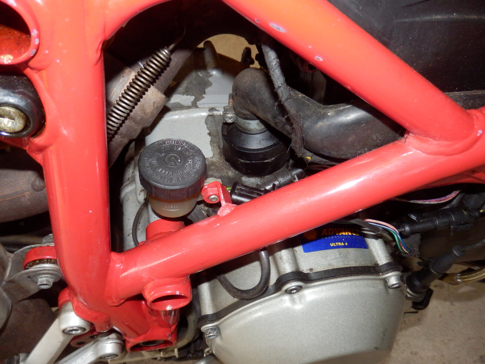

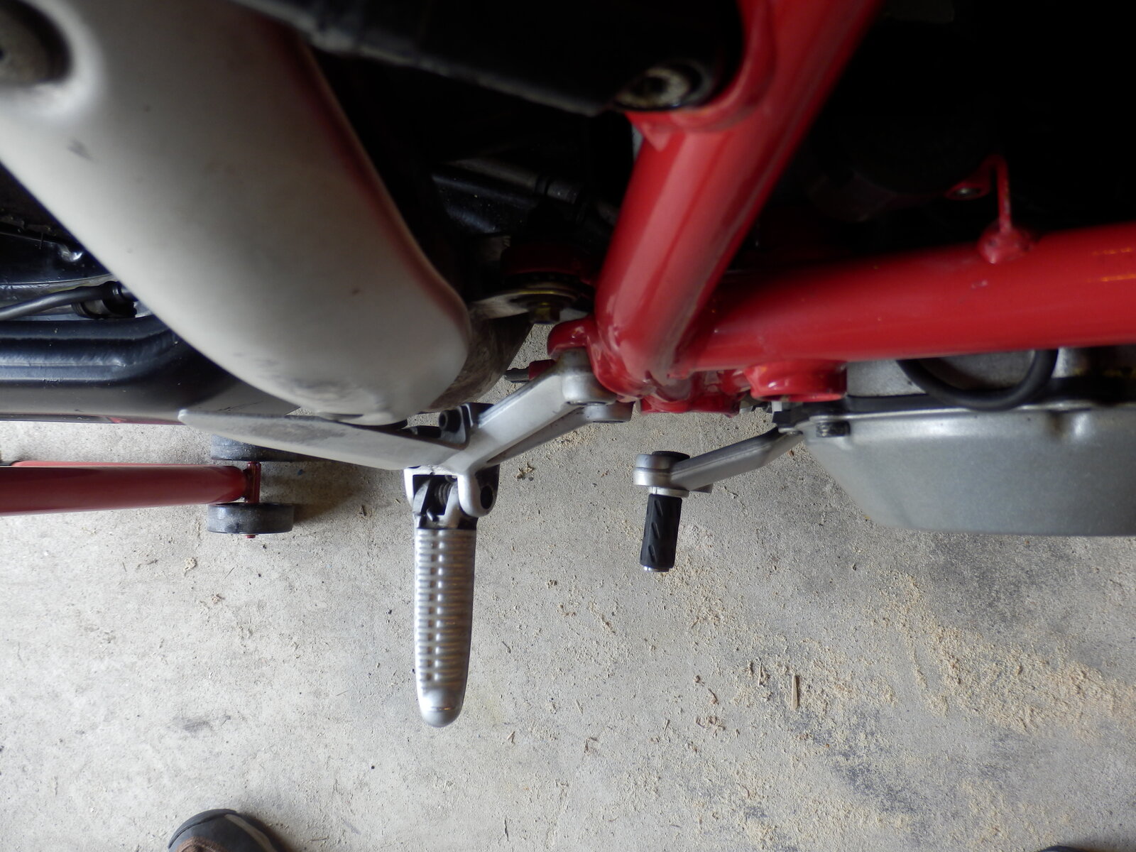

    Oil leak
    There is an oil leak which appears to be somewhere behind the Cambelt covers on the vertical cylinder, which I hope isn’t too serious or involved to put right.
    I first found it when I noticed Oil dripping off the RHS footrest mount.

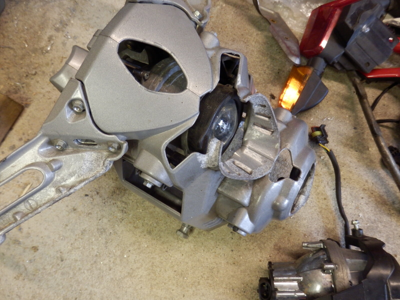

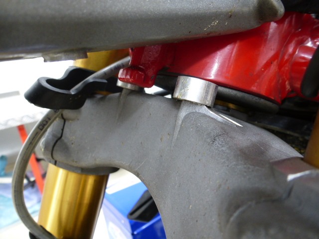

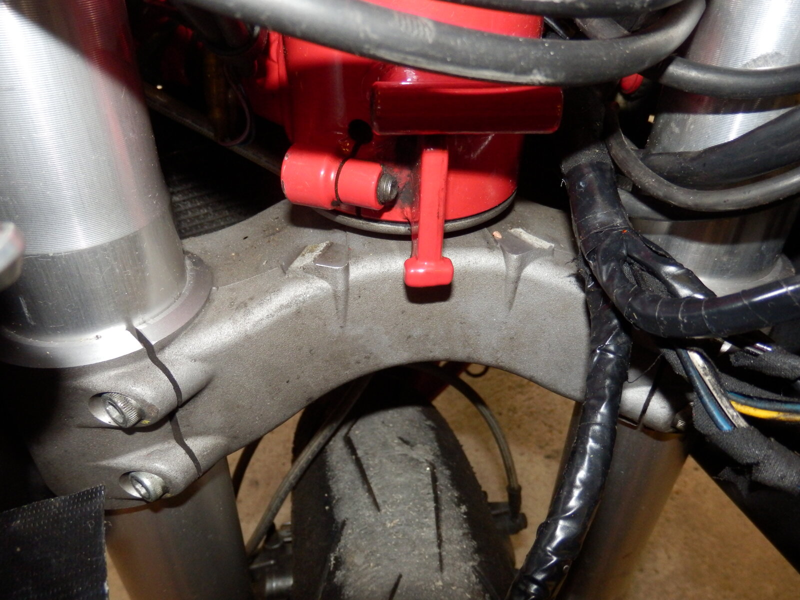

    Both Lockstop lugs are broken off the bottom yoke.
    This I hadn’t seen, and it will mean a replacement, but I’m going to change the headstock bearings anyway so it was going to have to come out regardless.
    I’ll be modifying the new one to include a hole under the stem to enable me to use a headstock front stand.

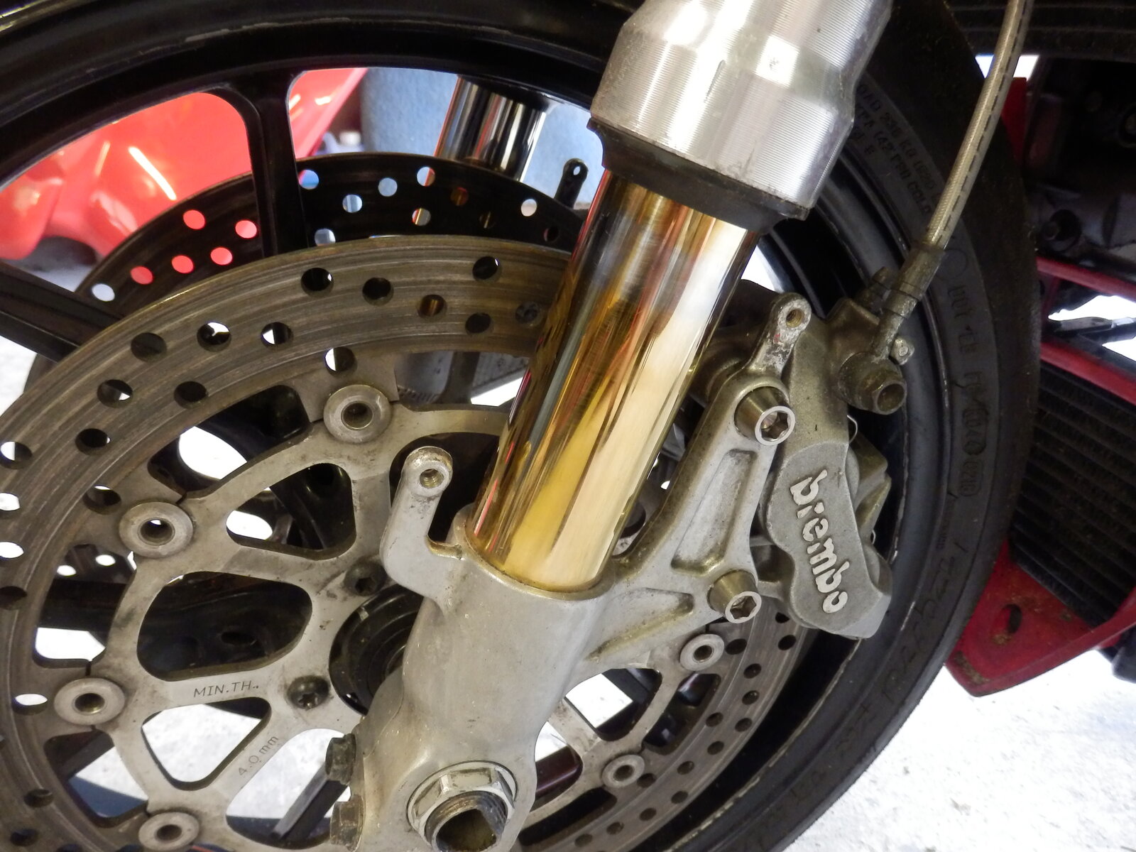

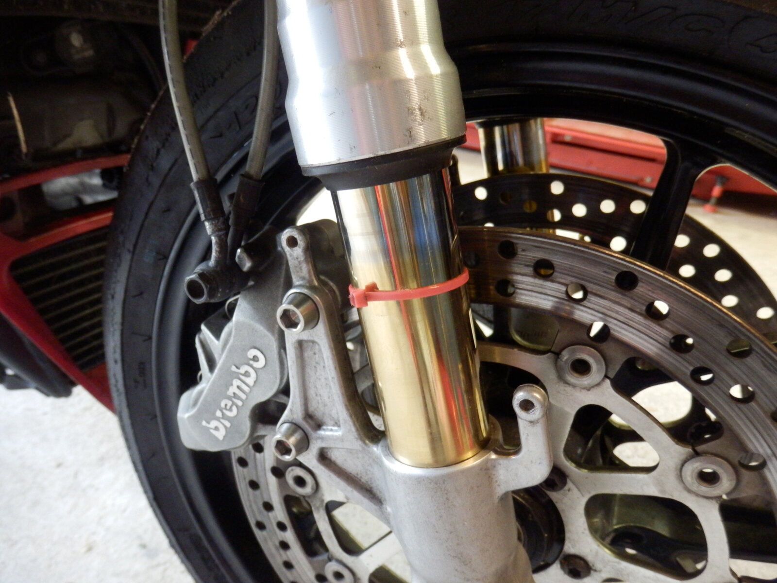

    Both Fork seals are leaking so they need a rebuild.
    And looking at the Gold coating I may find the bushes need replacing too.

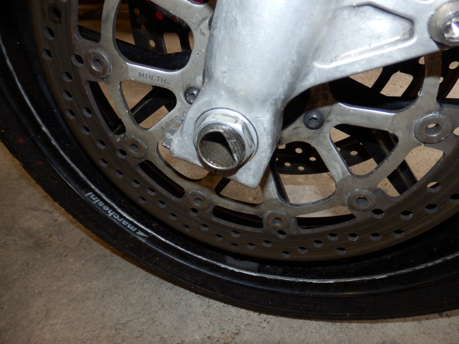

    And the Front wheel spindle is damaged on the end.
    I’m hoping the nut comes off OK

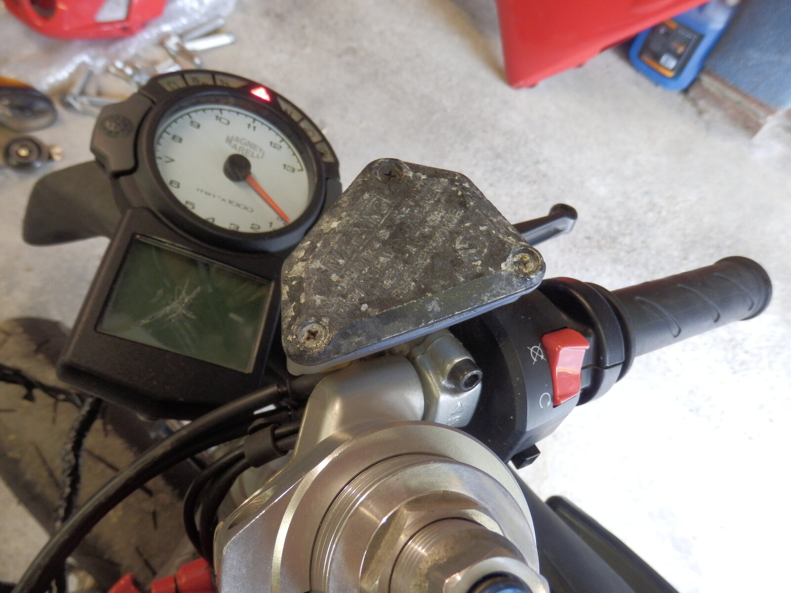

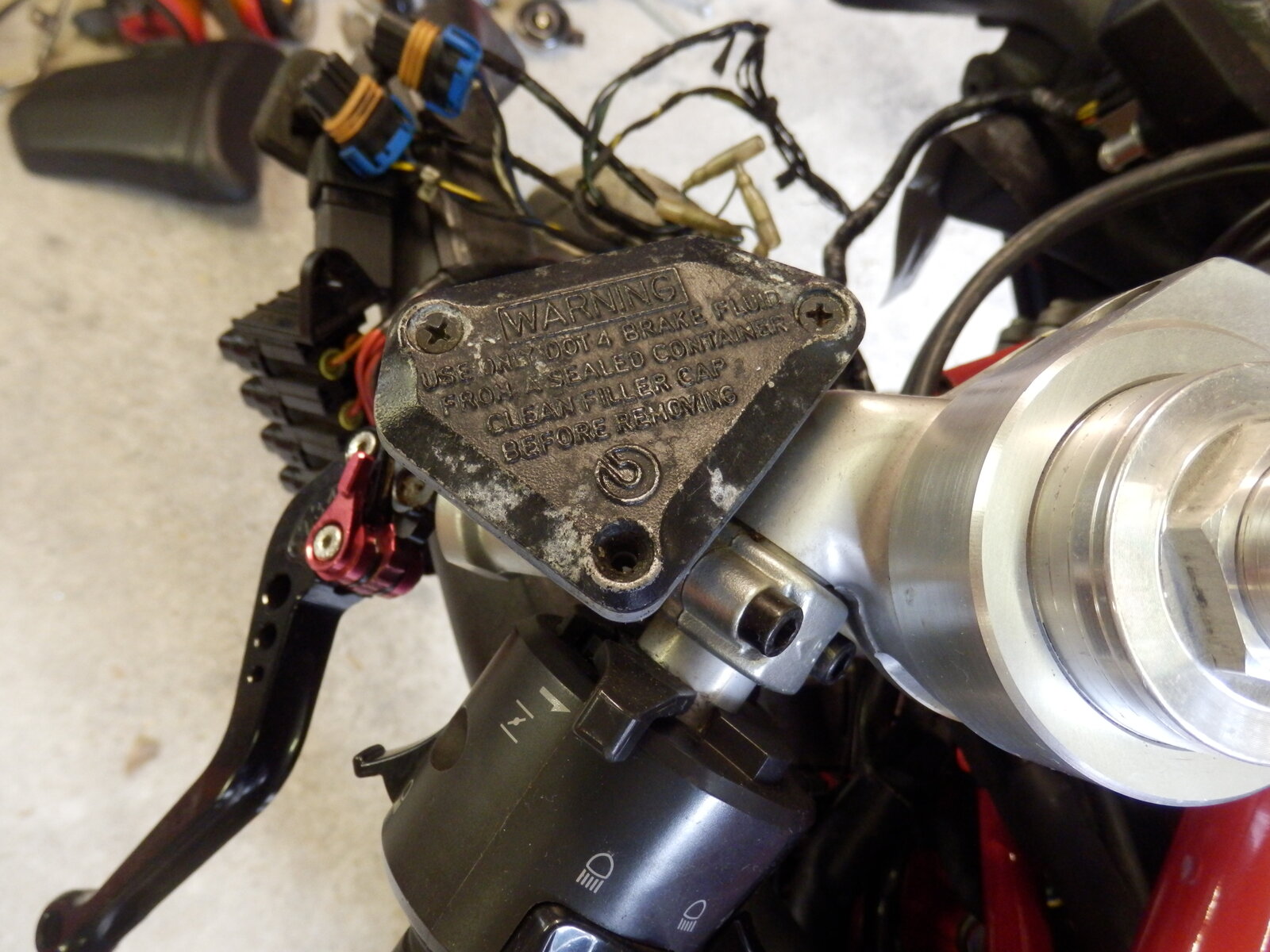

    Both front master cylinder caps are Corroded and will probably get replaced rather than refurbished, but I believe Sev has a kit to change them to remote reservoirs that he’d like to persuade me to purchase.
    I’ve not completely decided on what to do about the front end yet, I’d love to go Ohlins on it, which would require a new bottom yoke anyway, and give me Radial Brakes, but I think it will be beyond my budget.
    I might go with 848/1098 radial forks which can use a 999 Bottom Yoke.
    Or I could rebuild the existing Forks and Brakes, which are dragging anyway.

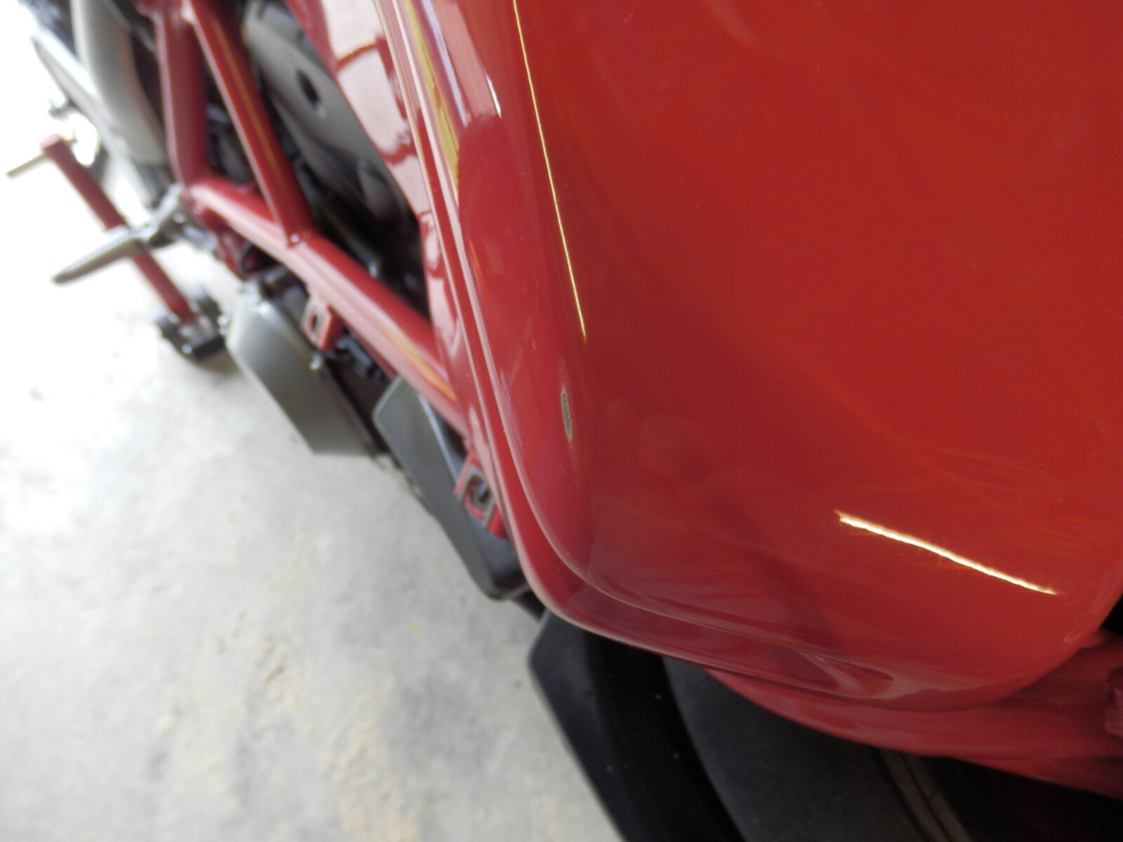

  4. Every Body Panel is damaged to one extent or another, except the replacement seat plastics which were sourced by the previous owner.
    I’m going to keep an eye out for good condition replacements at this stage.

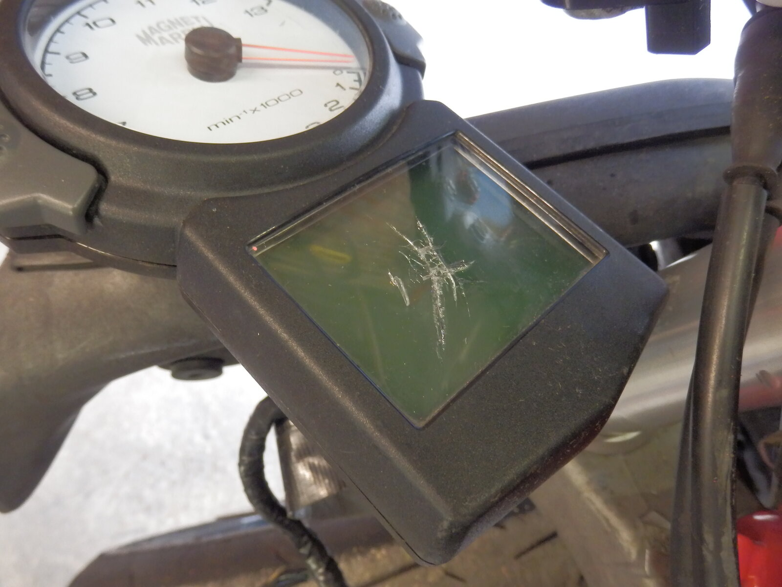

    The Speedo screen is cracked/crazed, but I’ve checked that the moulding comes apart and am reasonably confident that I will be able to cut out the original clear element of the two-shot moulding and replace it to a good standard.

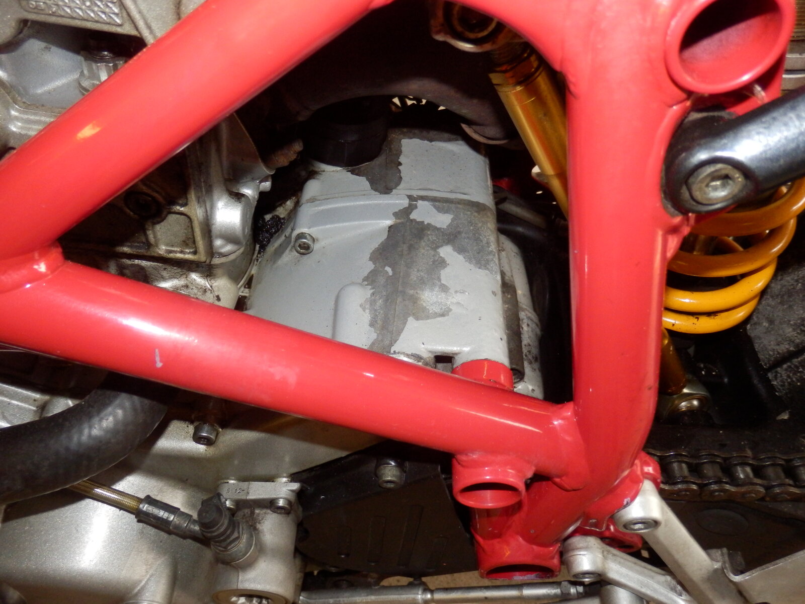

    There is lots of Engine paint coming off in several places. I might try patching it in, but as I don’t want to take the frame off the engine unless I really have to, I might just live with it.
    Both my M1000 and 1000SS/900SL have the same issue which I’m living with.

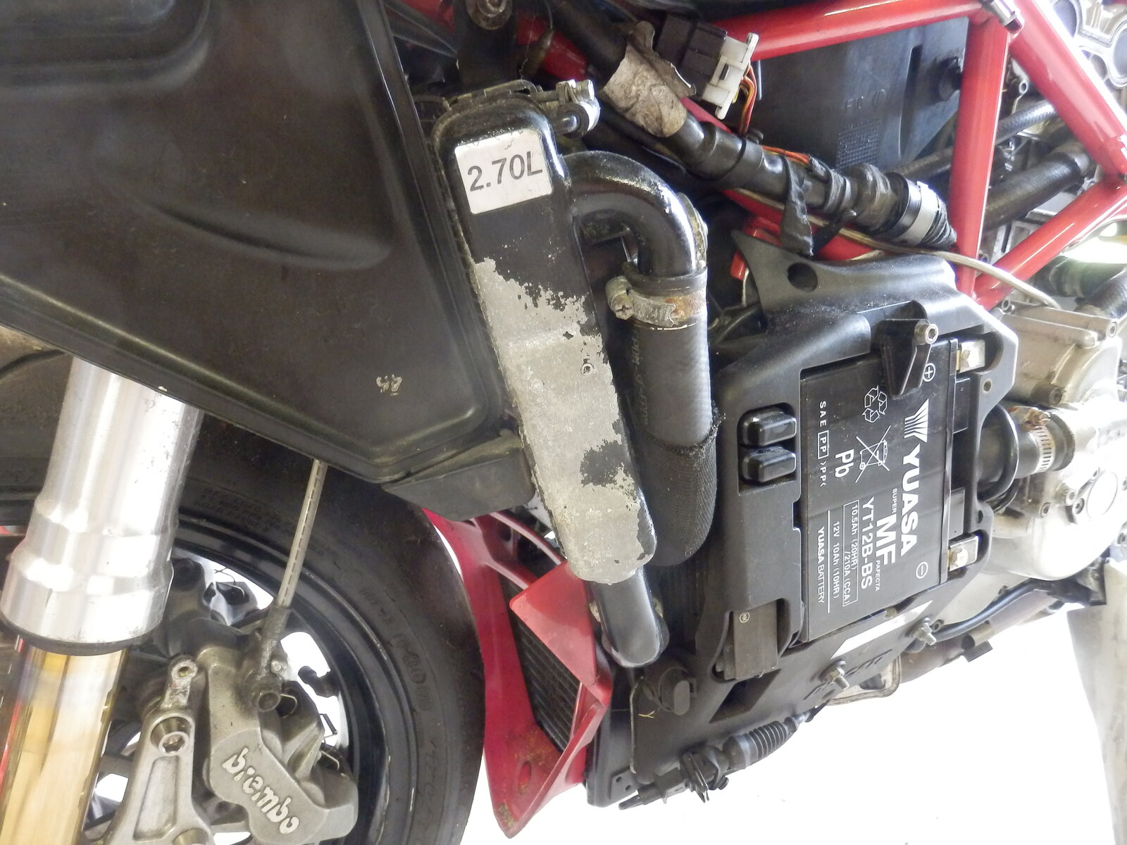

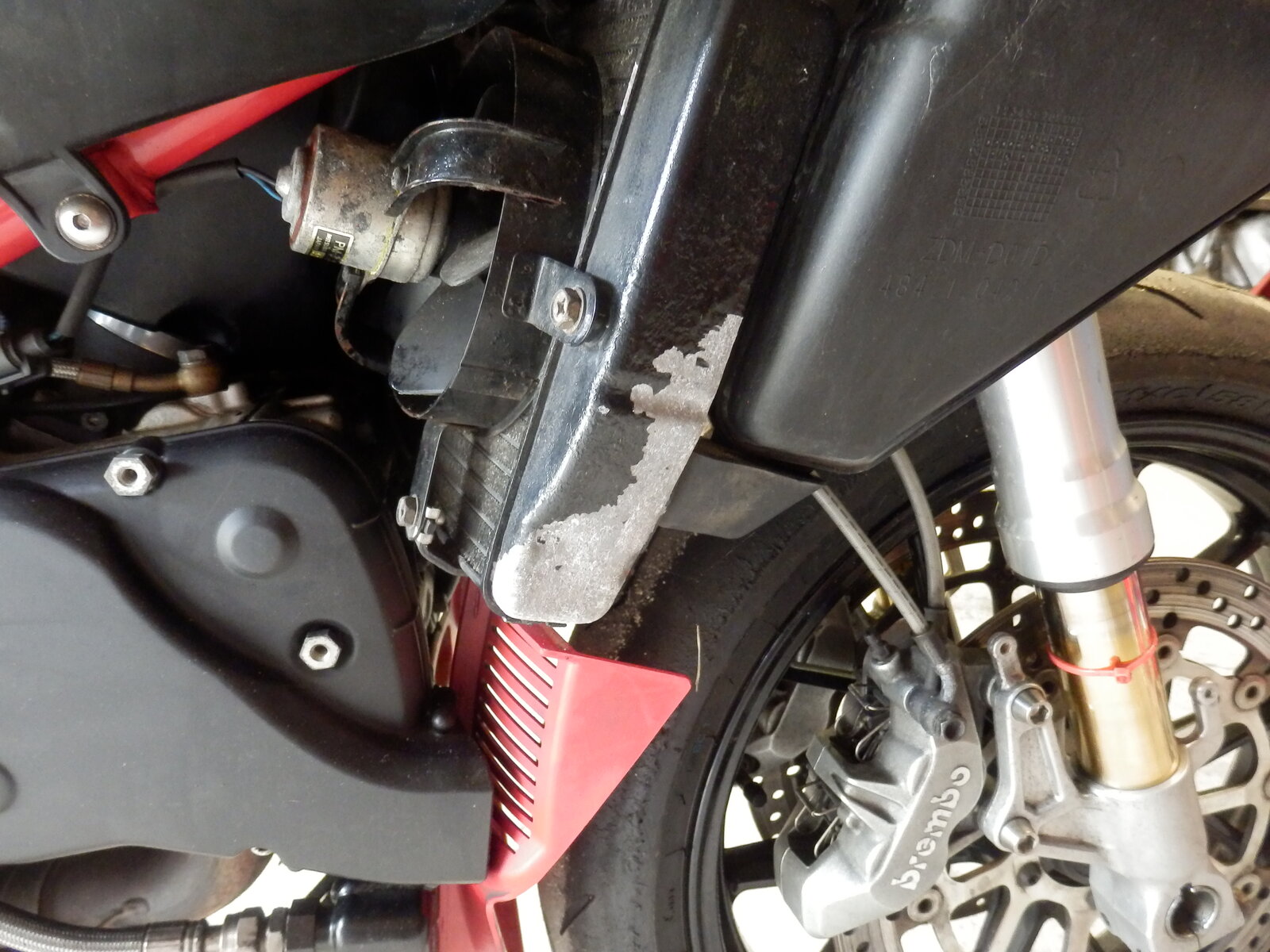

    The Radiator is corroded externally, I’ll keep an eye out for a replacement, but will probably just whip it off and repaint it.
    I also want to flush the coolant system and will probably replace the hoses at the same time.

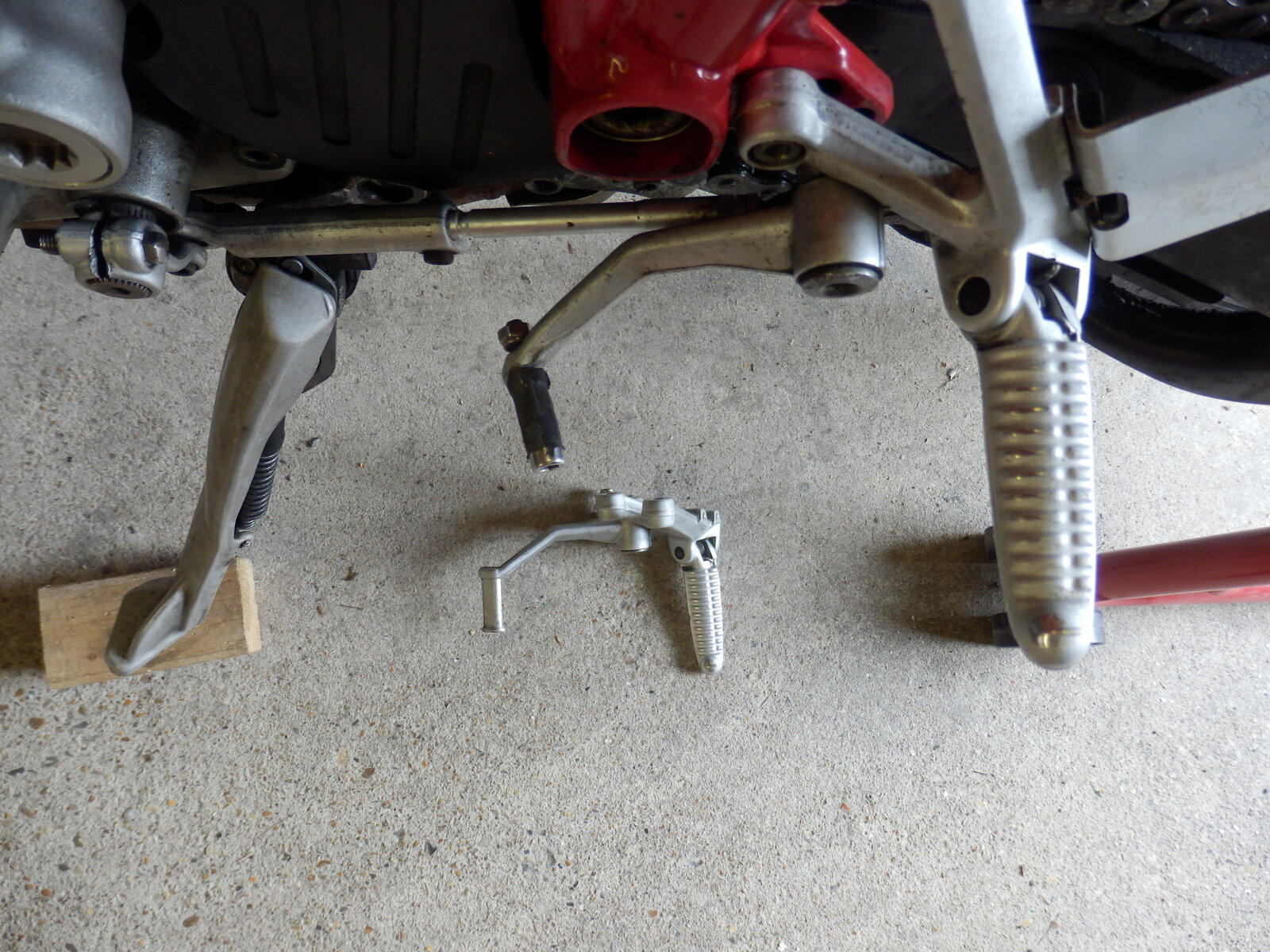

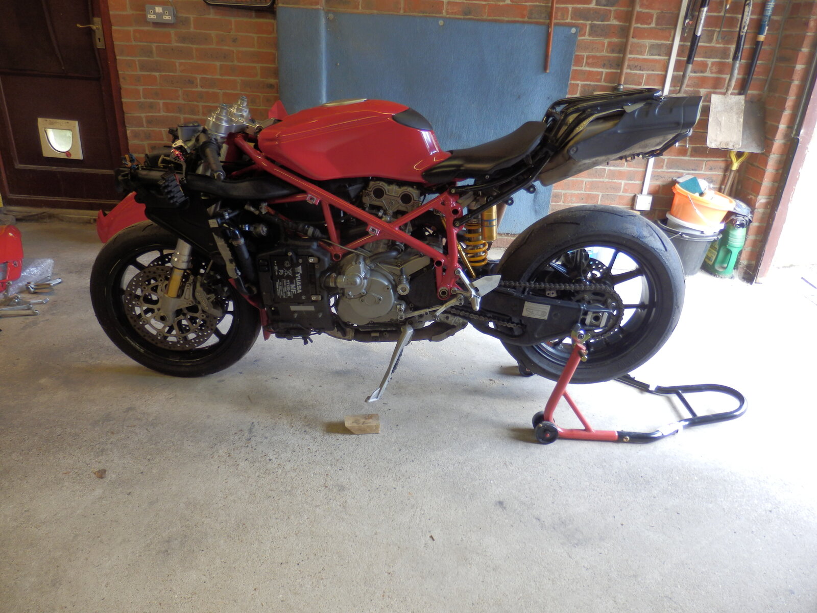

    The side Stand is awful, very floppy, and when I tried it without a block of wood under the foot the bike was genuinely right at the point of falling over.
    I’ve stripped it down already, machined a new spacer, and tapped a hole in the arm for a stop bolt, but have yet to find out if that’s done the trick.
    I’m not sure if the bracket is bent. The main mounting bolt nearest to the pivot can’t come out of it’s recessed hole as the riveted in pin for the spring plate is in the way, but I don’t know if that is standard.

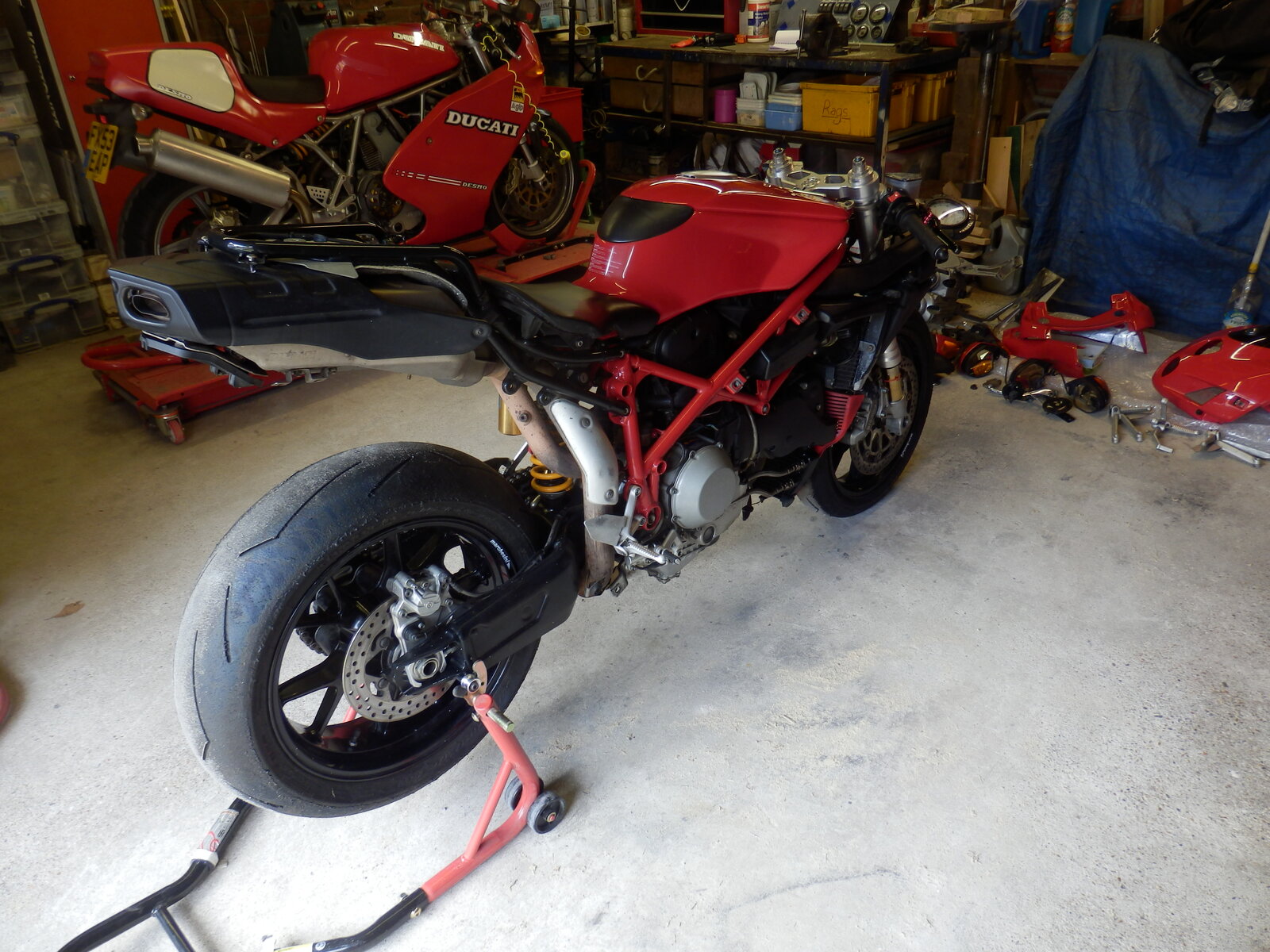

    And so it’s up on my bench and the fun starts

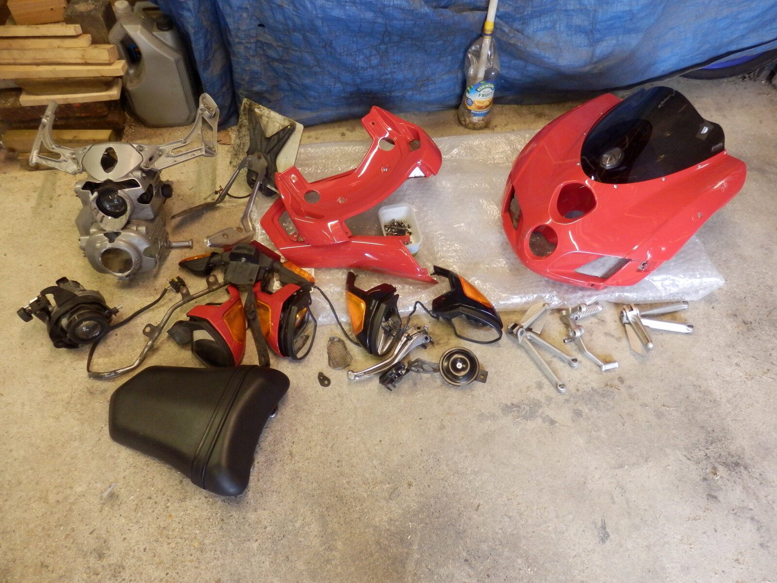

  6. All this lot, as well as the main side fairings, came with it:
  7. Nice project. You can machine your lower triple clamp. and put some excentric lock stops.
    • Like Like x 7
  8. Thanks Mrfurry, that's a good option.

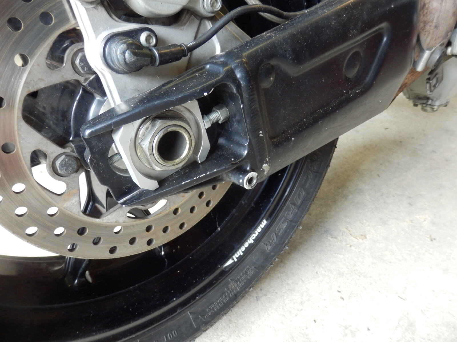

  9. I forgot to add that the Paddock stand bobbin on the Right hand side of the swingarm had been ripped off:
    The thread is stripped for the first few mm and the boss is ground away at a small angle.
    It must have only been held on by a few threads in the first place, and it was lucky the thread stripped instead of the boss breaking away.
    Luckily the thread wasn't damaged further down the hole, so as can be seen from the images I've used a pair Bobbins I had hanging around and longer bolts.
