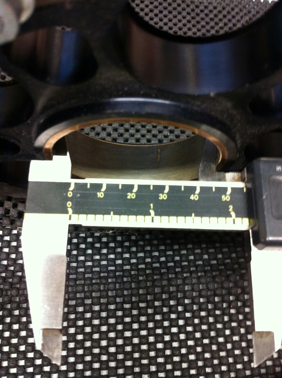

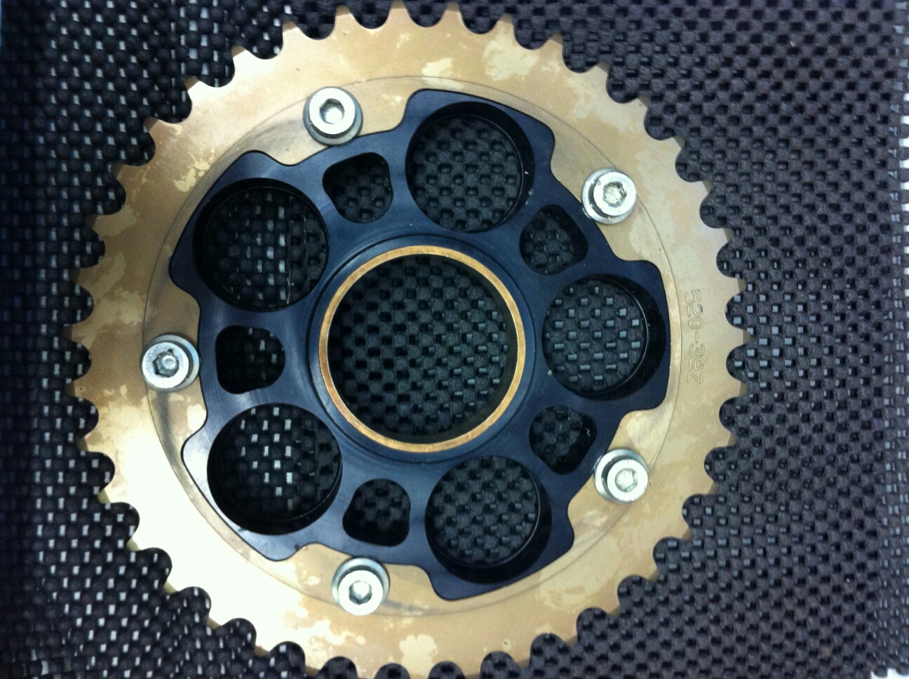

  1. I have ended up with a quick release sprocket carrier in a bunch of parts I bought. The ID measures roughly 55mm, can anyone tell me what it would fit, maybe 1098 or ANOther, thanks

  2. if its a 1*8 one I think it fits all SSSA with the large hubs; if its the smaller one then same with the smaller hub (848, 916 etc)
    Given the multi is large hub and 55mm socket, I'd suspect its the large one
  3. Thanks @bradders you were on that quicker than a speeding bullet.
    What threw me was the guy thought it may have come off a MV and I hate to say this but I am not au fait with MV or the newer Ducati stuff :confused:
  4. looks like maybe a talon hub?? Be worth duckduckgo'ing QR and seeing which brand (sprockets are different) and also if MV/Ducati are interchangeable.
    Probably worth £100 used that...
  5. 1*98 carriers have 6 Cush drive holes, so it's not that. 520-39 is not a standard Ducati size, so maybe MV ?
    Kev
  6. Chances are its 520 as its had a chain conversion.
