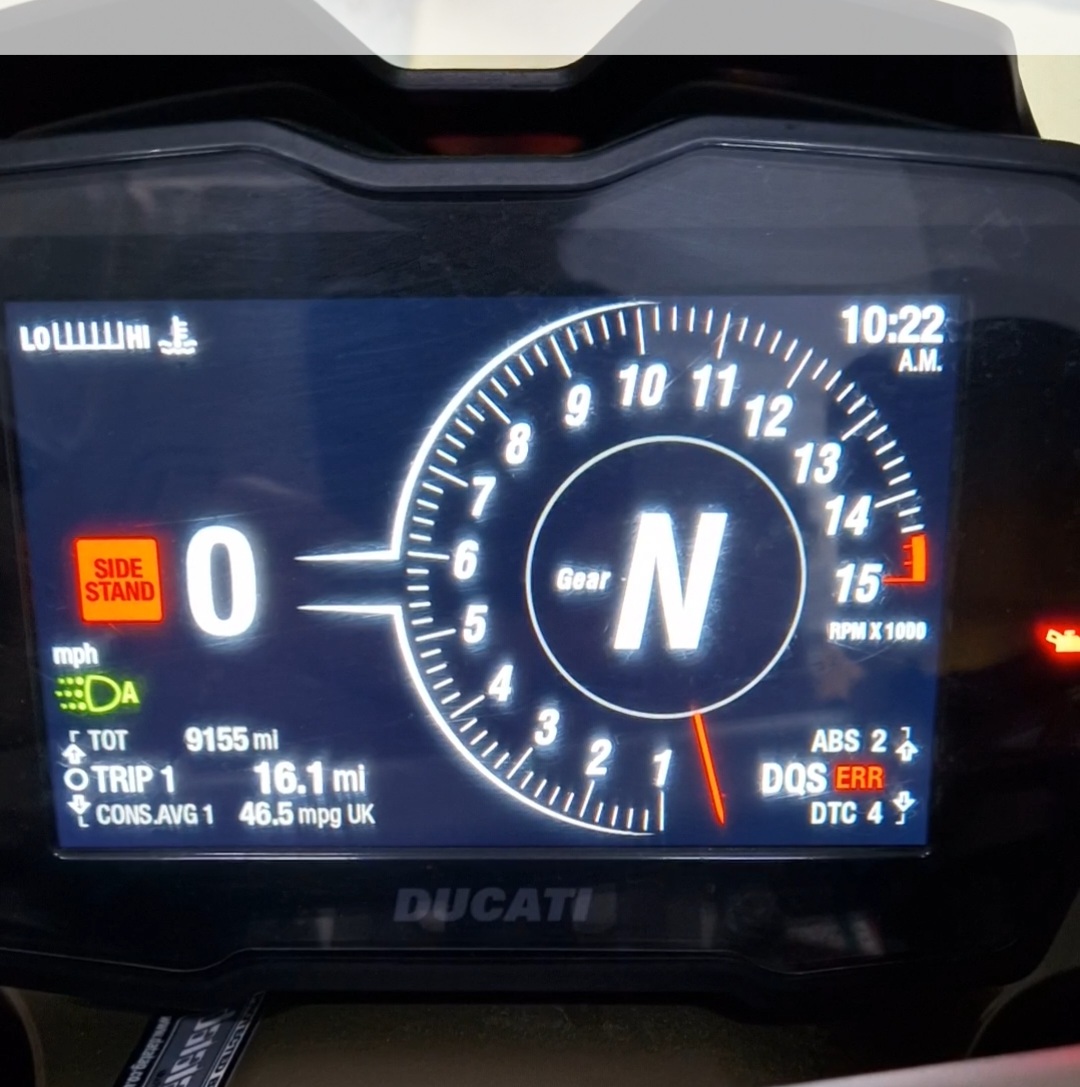

  1. Hi all, im hoping someone can offer advice on two issues im having on my 2018 V4 with 9000 miles on it.
    QS - basically it has stopped working and a red error has come up on the dash next to DQS and also the main riding mode light is flashing on and off, see attached photo where there is no riding mode shown as it continulyflashes on / off, when i switch the bike on i can go into 1st but when i shifting up the error then occurs, this has happened several times over the last 2 yrs but in the past has just gone away but on the occasion is hasn't.
