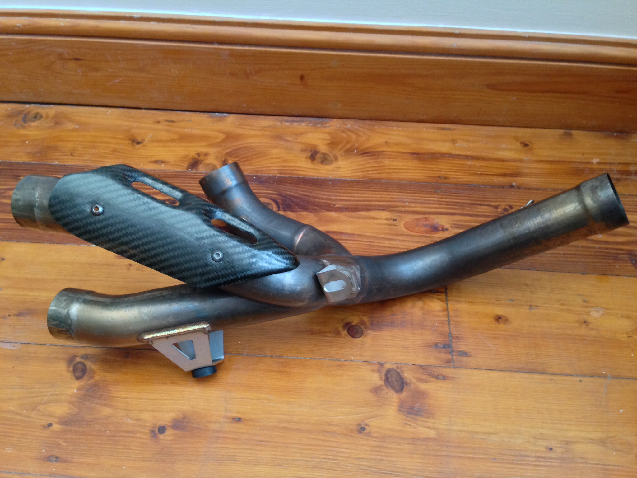

    When it arrived the bracket is just a bent bit of single thickness stainless. It had fractured right through, the width of the bracket.
    I had it welded, and they also bridged it a bit to try to strengthen it. Sadly this has torn the weld out of the pipe :(
    It is repairable, but I think the solid mount is a poor design. I might therefore have to get a bit more inventive and try to make use of the original rubber mounting link somehow.

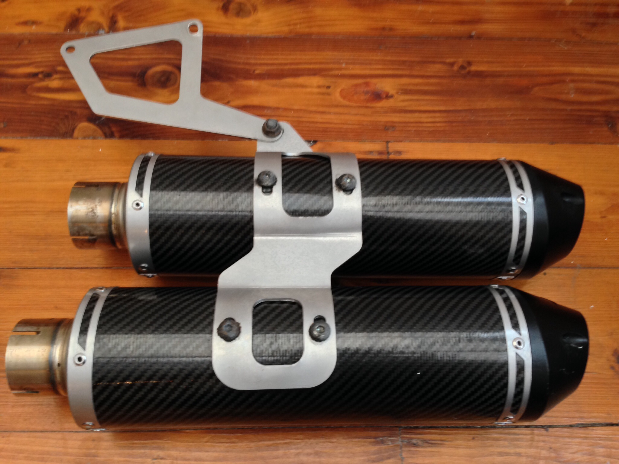

    No "old" pictures I'm afraid, I deleted those ages ago, unless they are embedded deep inside my emails somewhere... I have got the "new" photos though (I'll leave out the bubbly end caps, as I don't want to put anyone off.. .;-) ) ... off they go for powder coating...
    Fuel economy? No, that'll be your right hand... Ahem.... ;-)

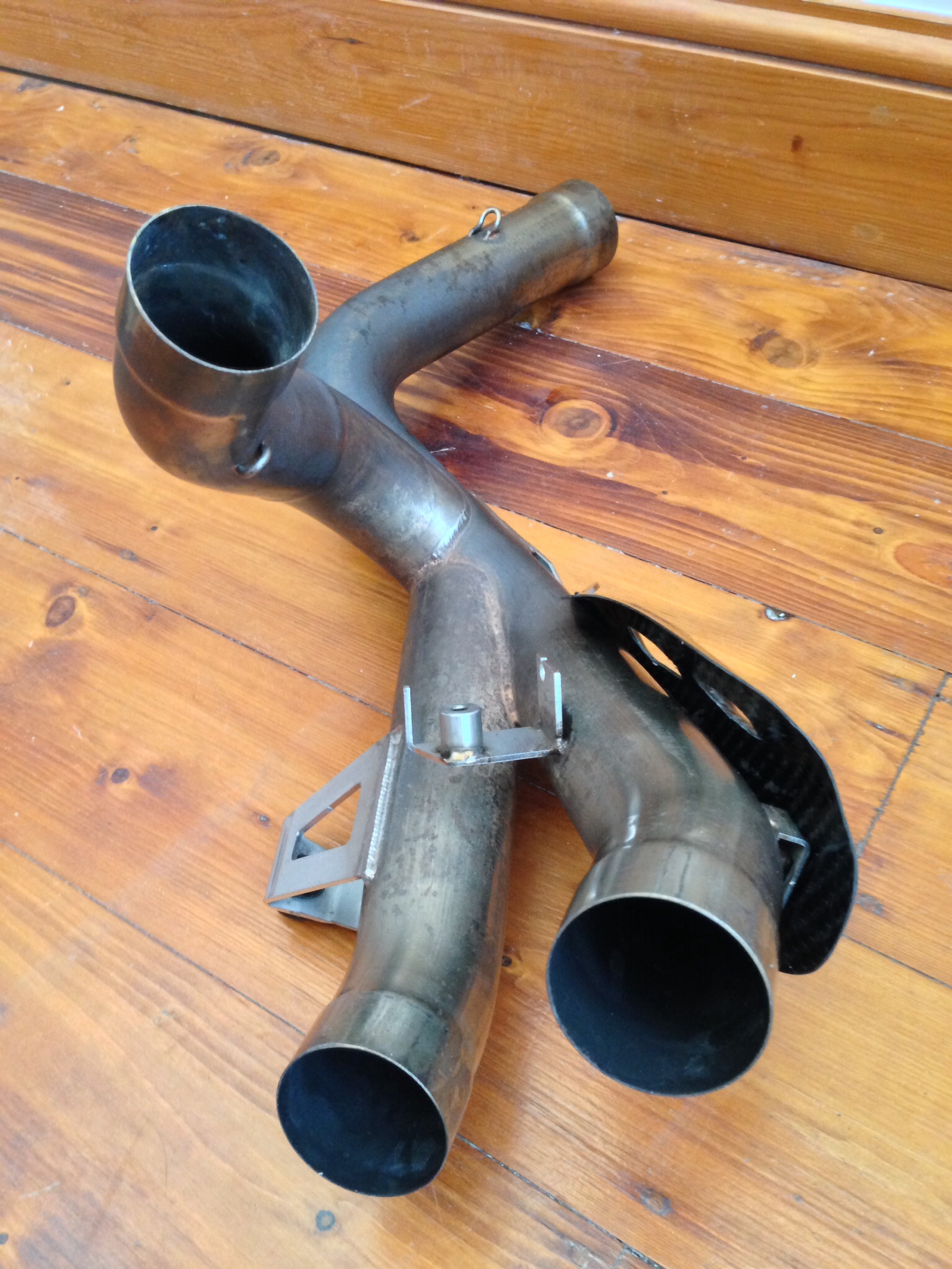

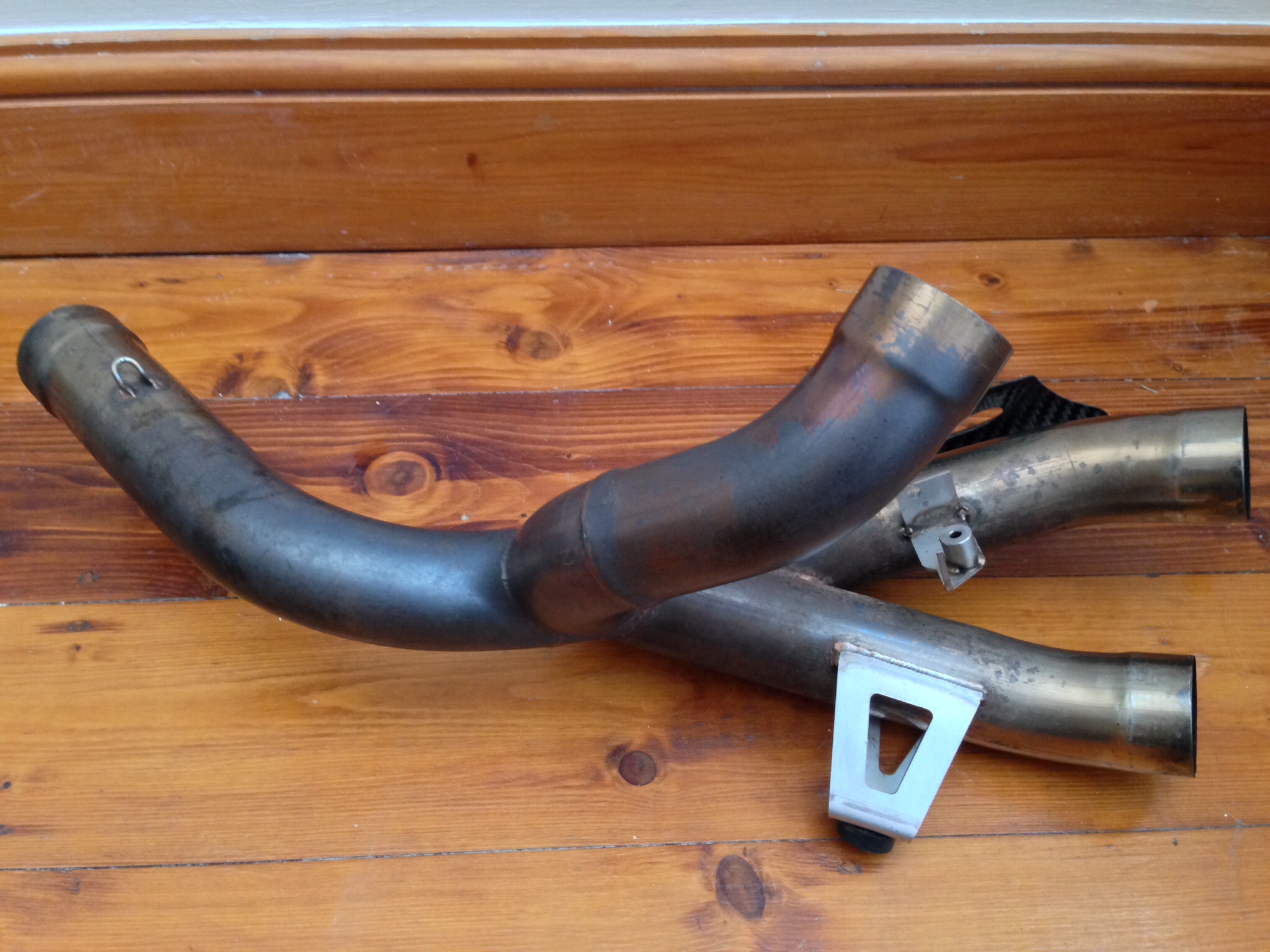

  7. If you want any pictures from different angles, just let me know...
  8. Hi David, most helpful.
    The bracket I really need to see is the L shaped one, that attaches the link pipe to the back of the frame. Pics from what would be above and front of bike would be most helpful.
    From the above pics it looks the same as mine.

    Have you got a picture of the broken bit? I can then see what, if anything is different on mine?
  10. I will have a look on my phone, see if I have or not.
    I dont need pics on the bike, just different angles of the L bracket to see if it has been altered.
    my feeling is, that pipe looks identical to mine.
    Your first pic of the link pipe, my welder tacked an extra weld between the bottom of the bend and the pipe, because the bracket had snapped off at the end of the previous weld. Whilst it inevitably made it stronger, it still doesn't get over the inability to expand under heat (or stand clout) the rigid fixing causes.
    Or maybe you didn't bother to fit this front mount, so didn't have a problem ?
