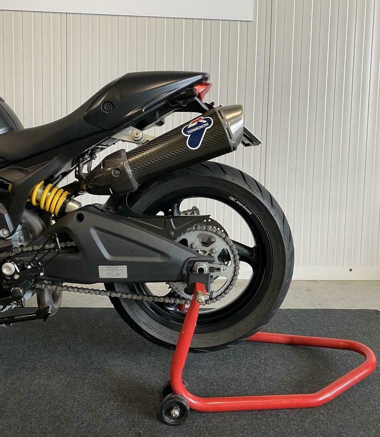

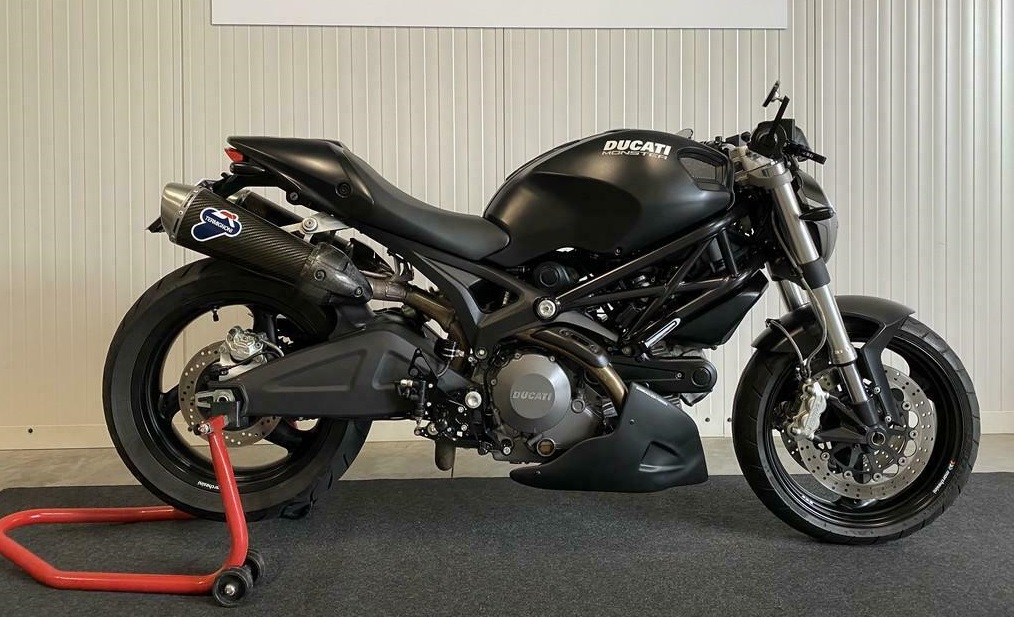

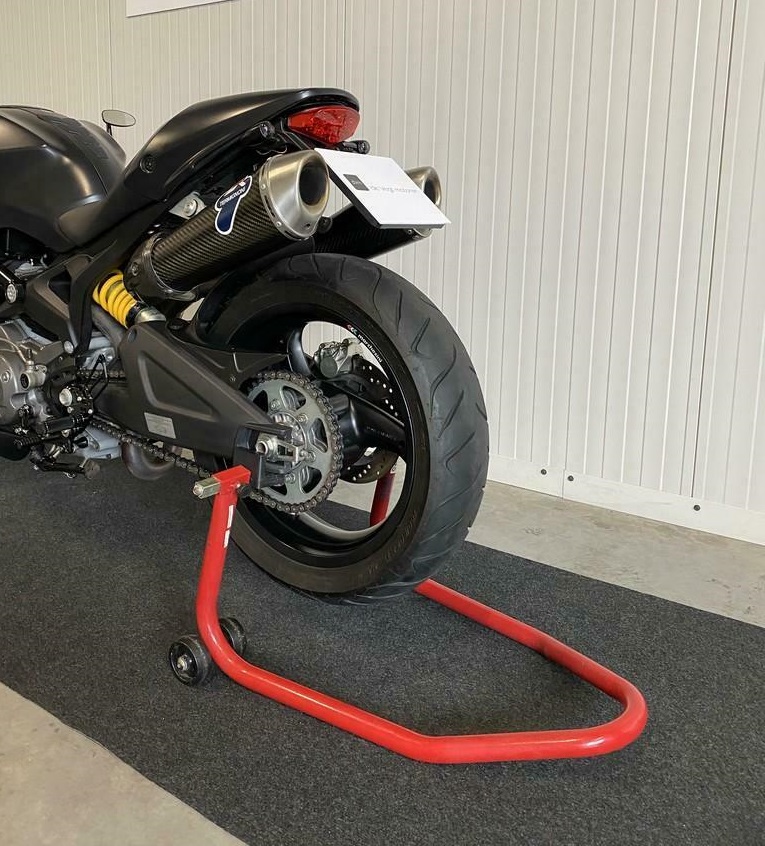

    I'm a proud owner of a 2008 ducati monster 696 for a week now and I can't be happier about the bike, however there is a small issue and that it doesn't have any foot pegs for passengers,
    I bought the bike with all the mods shown in the picture and I'm wondering if there is a way to install/buy passenger pegs and screw it on the lowering pegs it got or any easier solution.
    Thank you all

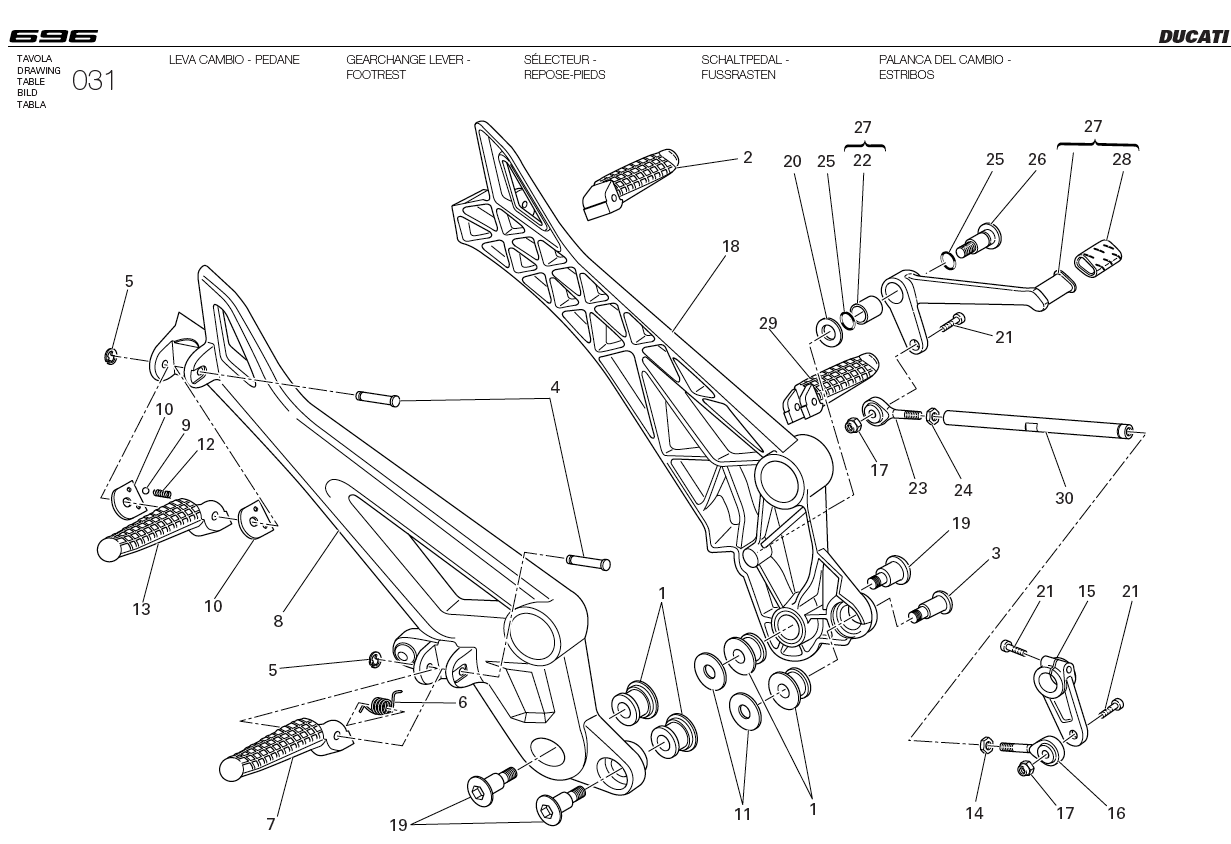

  2. The original footrest hangers/plates have been removed and replaced with those fancy rider footrests. It will be very difficult to fit pillion rests without them. Has the previous owners got the original plates?
  3. Sadly no original plates
  4. I agree with @Derek - I have very similar rearsets on my M1100 and would say that it’s not possible to fit pillion pegs.
    I believe you will be able to find a set of standard ones on eBay though.
