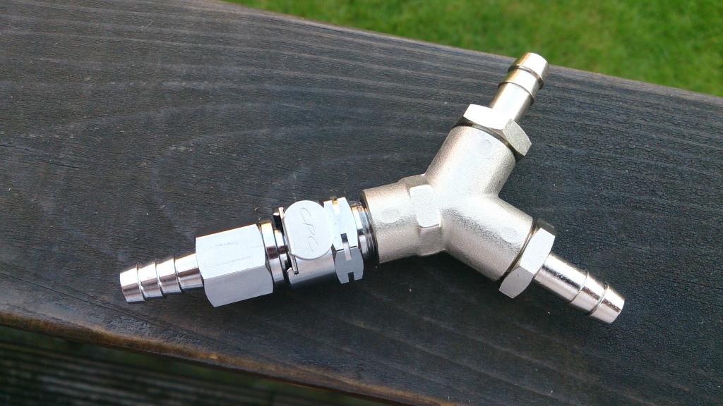

As the others have said go for the plated brass CPC fittings (viton o-ring) from Tom Parker Tom Parker Ltd, Preston > CPC Plastic & Brass Couplings > Brass > CPC Fuel Line Couplings > Brass Coupling Body - In-Line - Valved - Hose Barb This is what I'm going to use on the current project.
