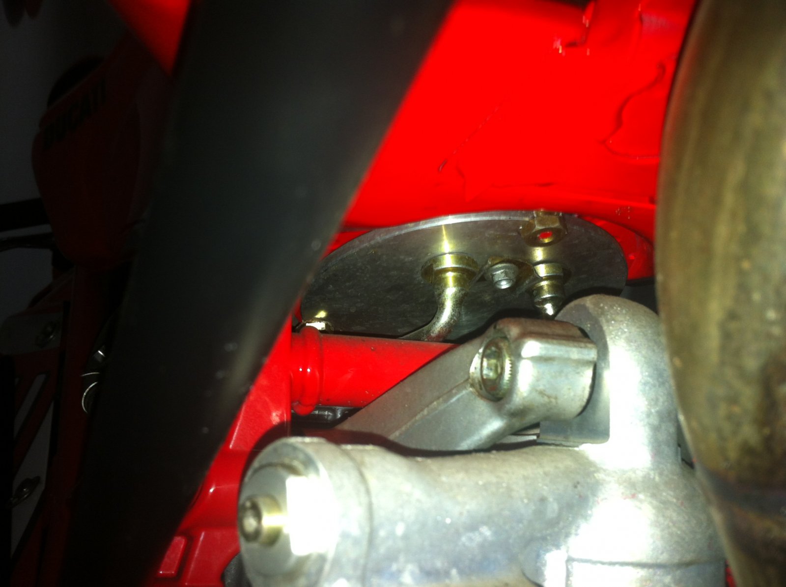

  9. This is how Ducati did it on my prototype but the plate is machined and thicker than the production one - perhaps you could do similar but with inline connectors if room is tight...
  10. Thanks for the picture I did think about making it completely but thought that the pump mount would be awkward but you have given me a push in that direction . Have to get it to bits and see.

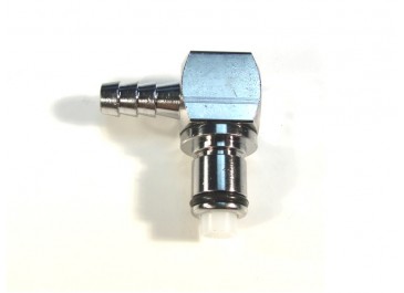

  11. Ordered from here for 80 dollars inc postage . QuickCouplings : : .
    bit of a night mare finding the right ones but there in there.

  14. Been re searching these as I broke one on my MV last week :Wideyed: it appears the female connectors never seem go wrong - just the male connectors which are ridiculously delicate. The male metal connectors fit the plastic female connectors so I'm going down this route. I think the 999 ones are the same as the MV750 ones...
  15. I believe (so I have been told)that the ones fitted to Triumph's are metal and are ideal replacements for Ducati ones.

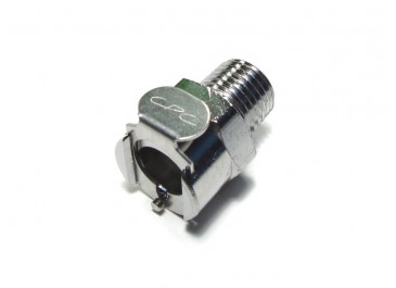

  16. CPC do plastic and metal to the same design I've read, these are the metal ones but as above, the metal make fitting will fit the plastic female which doesn't appear to have issues.
    Maybe Triumph use these...
  17. Had a CPC metal one as per the picture fitted to my 748R as the plastic one would not seal when the male was removed, cost £40 as I had to get it from the states, after I had it fitted I was told about Triumph ones where half the price :-(
