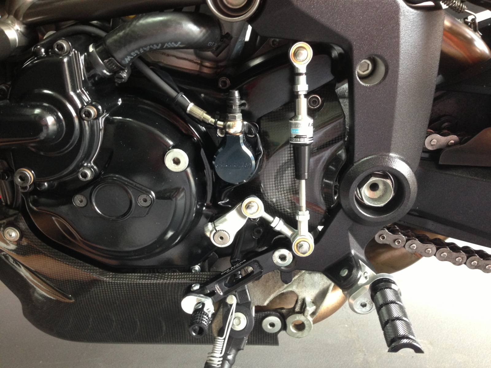

  15. Ive had a translogic quickshifter fitted for 15000 miles now, never had any bother with the gearbox, just loads of fun
    Translogic Systems - World leader in Quickshifter technology
